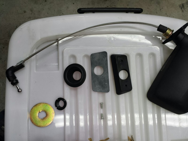

Bought a LHD one from Leboncoin thru a French pal. It's missing a couple of bits (base cover plate & gasket and possibly base plate nut (unless it is already there in the door)) but otherwise I'm happy.
Will upload photos when Photobucket is back to it normal self.

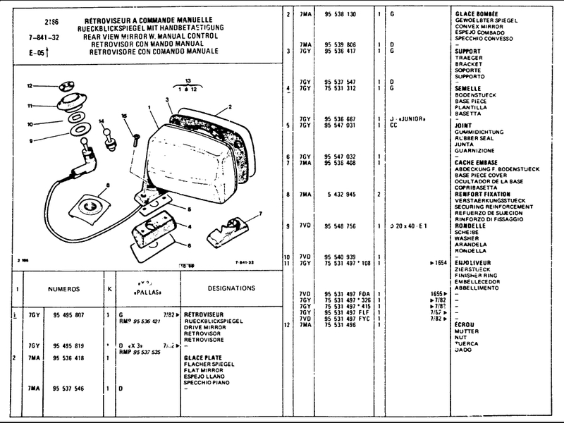

Unread post by sonoramicommando »

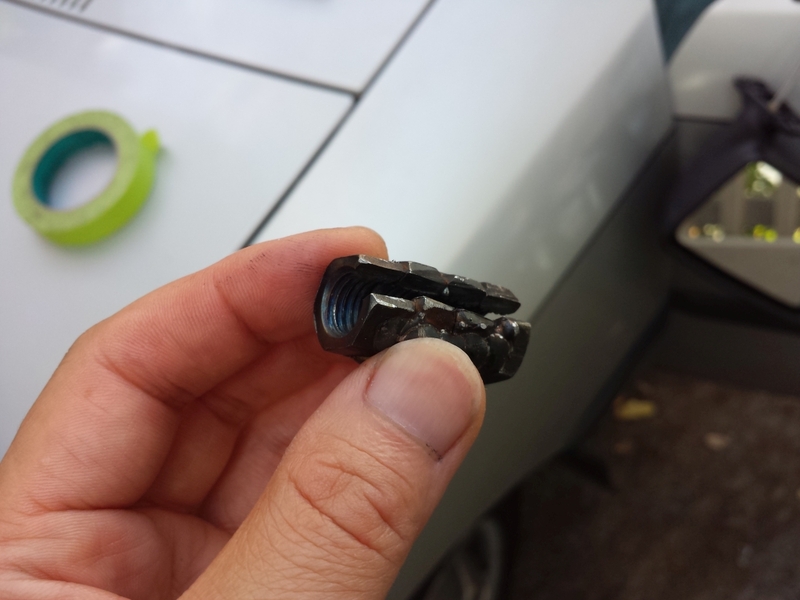

Items 5 & 7 are missing, and either 9 or 10. Not sure 8 is built in the door.

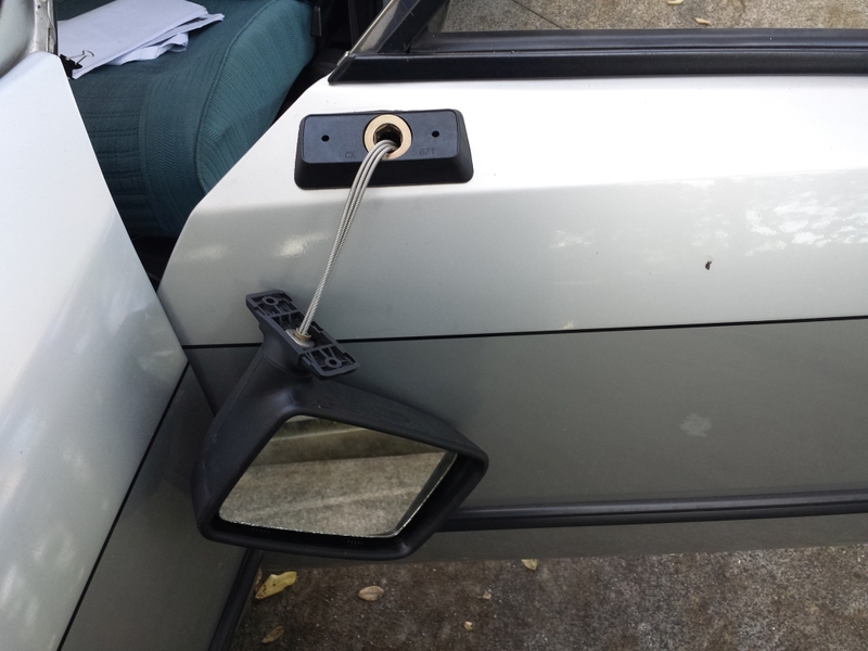

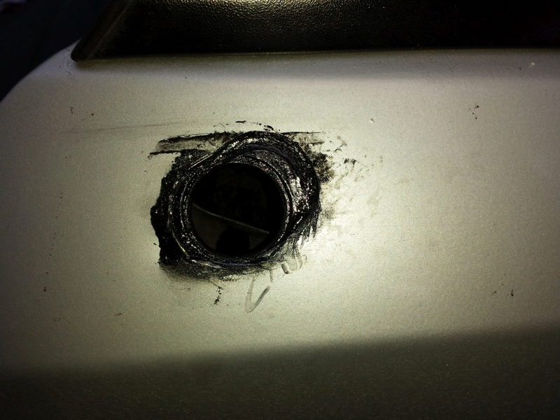

Ok... installed the mirror this afternoon BUT!
Bad news 1.Image
Made a bit of a boo boo with the cutting the hole out... I made a template from RHS mirror as best as I could (not as easy as I thought it would be with mirror on etc etc) but either LHS location is slightly off or I screwed up quite badly.

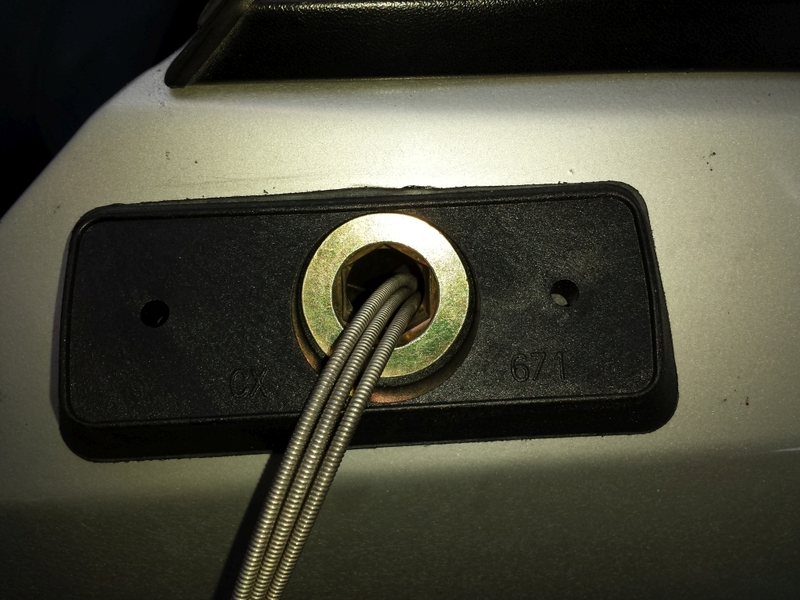

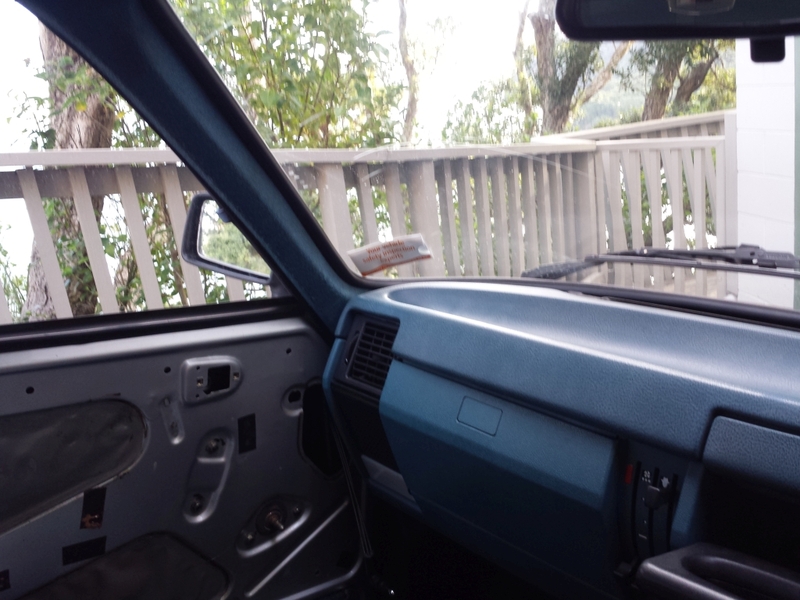

Good news 1.
The base covered up the mess nicely.
Because of the funky big screw with the hex head and the adjustment cables going through the middle, the installation called for a special tool MR. 630-12/49 or in this case a dodgy homemade tool.
Tool in action - worked surprisingly well.
Everything in place, except for the trim, which was missing from the mirror kit but no big deal.

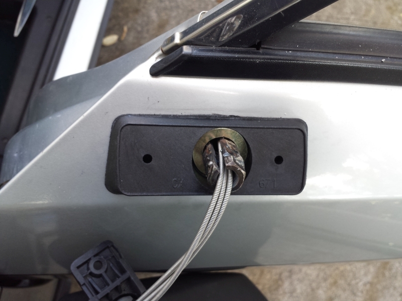

Re: LHD mirror vs RHD mirror
Bad news 2. WTF moment of the day but I was warned by Stonehopper earlier in the thread albeit his was GS, not GSA.
There are a whole bunch of different part numbers for mirrors but not sure which is for what - obviously LH drive driver's mirror doesn't work with RH drive. I think it's safe to assume doors are manufactured for all markets.
Now I'll have to hunt for RH drive estate or enterprise mirror...

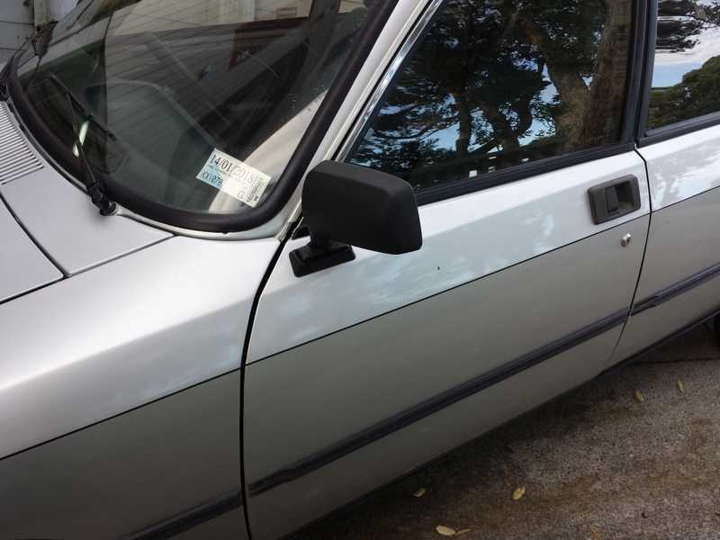

I had a '68 Fiat 125, it didn't have ANY external mirrors and there is no requirement for it. According to the current legislation, a car needs either driver's side external mirror OR interior mirror if manufactured before 2000!!! Bonkers!
I don't have any info on NZ spec GS/As but looks like hatchbacks got driver's side mirror only and estates/vans got both. This is looking at a lot of photos on Google image search (which is by no means a definite source).
Most of GSAs I've seen around don't have passenger side mirror and the one that has was retrofitted, he has a similar issue with the mirror sitting far too forward, obscuring some of the mirror glass.
