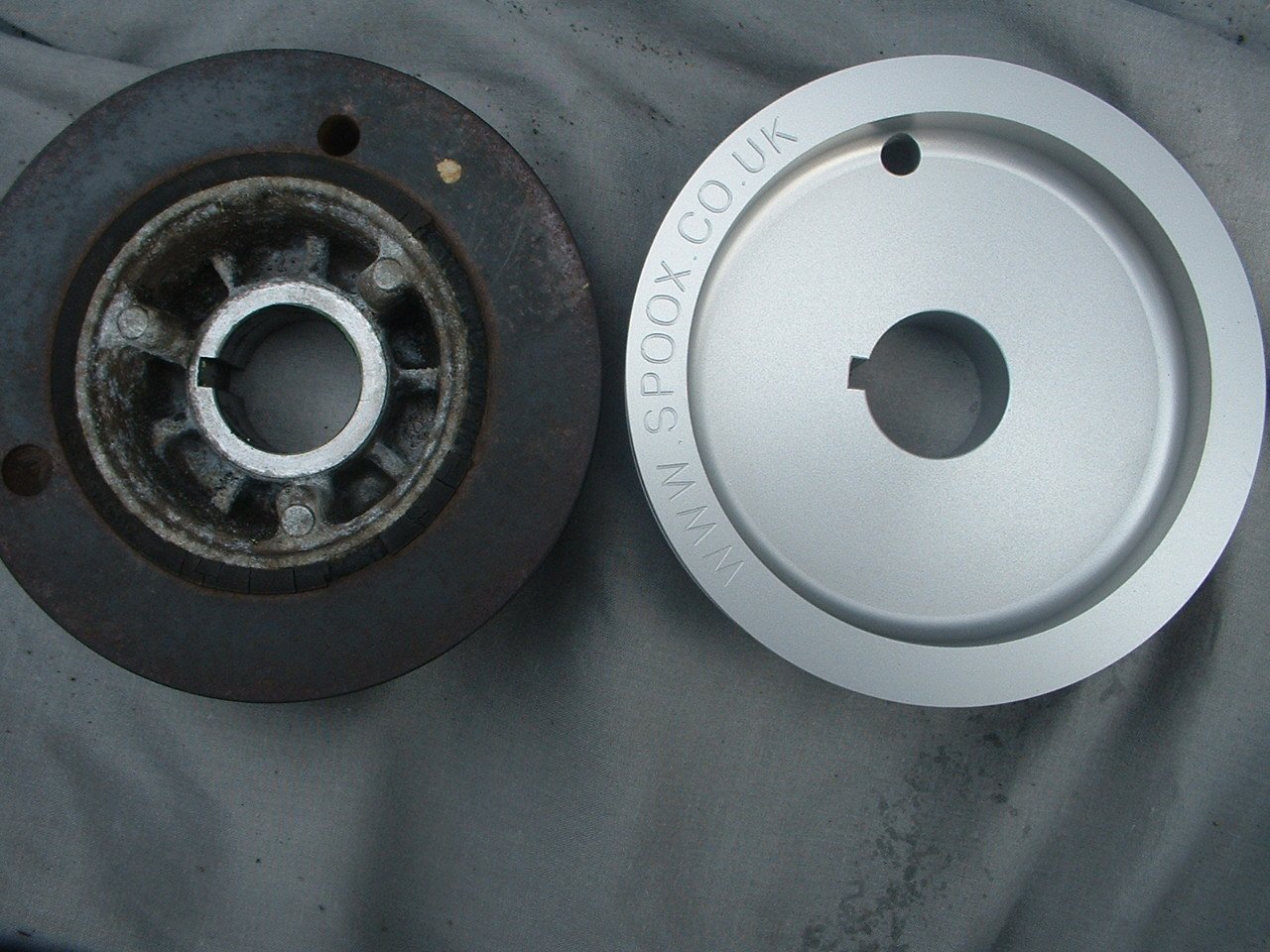

djadams Yes Thanks sorted now ....this was my problem
Well after finally relenting I have bought a solid pulley (couldn't find one anywhere and also appealed on other sites).
The difference between the two is about 25 degrees and comparing the two, looks to have been running too advanced.
Hoping to get it all back together tomorrow and see how the engine sounds ...
I'm guessing I've been lucky not to damage the engine and hoping to get my boost back .....
[/quote]
So when I renewed the timing belt I reset the timing because it looked out but there was error in the timing pulley which sent me off on a wild goose chase, finally bought a solid pulley as above and all sorted
[/quote]

Re: My first Activa
Good to see solid pulleys are now available
It's normal that the timing hole slips on the OE duel mass pulley and they should never be trusted
I still have here a solid pulley from a 205 engine I use only for timing when swapping a cambelt. It can't be used for running as it's not designed to run with a 6PK auxiliary belt...
The 2.0TCT is reputed to be a 'non-interference' engine so could in theory tolerate a massive timing error but I'd hate to put it to the test!
If yours is/has been running well then the timing won't be far out...

Cheers Jim it really was your post that convinced me to try a solid pulley, finding one was another problem. WWW.SPOOX.CO.UK supplied one that weighs 1Ib 3oz (old pulley 3Ib 4oz) (£92.94).
Your old 205 solid pulley would have been ideal - worth hiring that out to those in need

Ah yes... Wow! When I replaced my cam belt, my TV damper had slipped just like yours, rendering the timing hole utterly useless (as diagnosed for me at the time by CitroJim, if I recall correctly!) I bought a new pulley (with TV damper) from Citroen to ensure it was all timed correctly, but I think having a solid pulley to use as a locking tool, and then putting the slipped one back on afterwards would have been fine (or indeed using my new one to time it, then putting they old one back on and keeping the new one somewhere safe to use again for the next belt change...). I should have another 20k miles of use left before my next belt change, I'll sort something out then!

djadams so exactly the same issue except that I timed the engine on the original pulley, which seemed OK when testing by turning over manually by hand, as Jim said the valve / piston clearances must be very generous.
I hadn't driven the car at all, as I had no belt history, I couldn't really tell why there wasn't the power I was expecting, it went to a Citroen specialist and a Citroen dealer both of whom ran diagnostics without pinpointing my error.
The Activa is now in daily use as yours is, but I will hopefully reduce that when winter weather arrives.

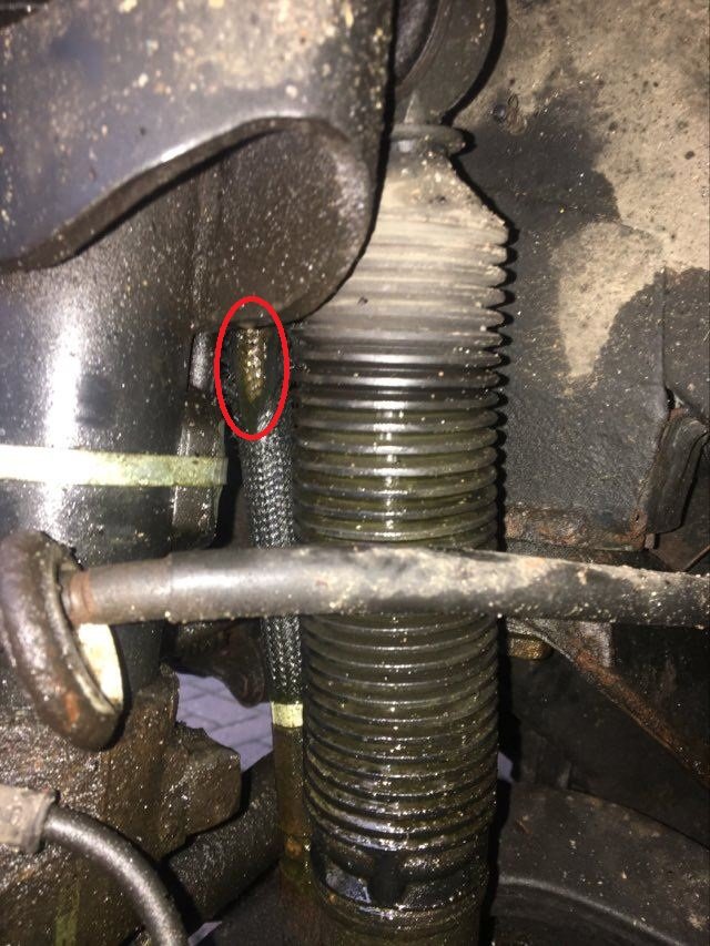

Got a burst pipe somewhere STOP .... limped home 2 miles as it was pissing down ..... pump belt is OK ....investigate location tomorrow, suspect a scabby OSF pipe.

I've cast my mind back a bit .....
As above - I had noticed some slight chaffing on the front ram hose nylon outer sheaf but it's done 16,000 miles since the rams were done according to the invoice, but that has now been severely chewed probably by the upper mounting lug for the ram, quite hard to get a decent photo in situ, I suppose I should have taken more notice of that initial chaffing when I replaced the low pressure return line.
Maybe I made the contact area worse when I fitted the suspension leg low pressure return line
I will have to make sure I get some decent clearance when at normal height on assembly.
I need the following part No. for: VIN VF7**************[VIN obfuscated, can be read by forum staff]
FRONT RAM HOSE Are they individual ? I need the rear/outer one
(SUSPENSION LEG GAITER also perishing)
Well my initial suspect is not guilty.Skull wrote: 18 Jan 2019, 14:35 Week has flown - not much done but I had a look at the weep from the front n/s suspension leg seemed to be the coming from the low pressure return connector which is held on by a metal clip .....
Which leads me to the other problem I've discovered - one of the ram flexi-lines has been chaffing on either the suspension leg or the back of the return connector (and may have dislodged it a bit ?)

Skull, there's a way of dressing the ram hoses to prevent chafing. See my website
They are identical front and rear but are 'handed' in that they're different lengths..
Hopefully someone will have a decent spare in their stash somewhere. Sadly I no longer have
You may find a mob such as Pirtek can make you a new one using your original fittings...
Here's hoping it all turns out good
