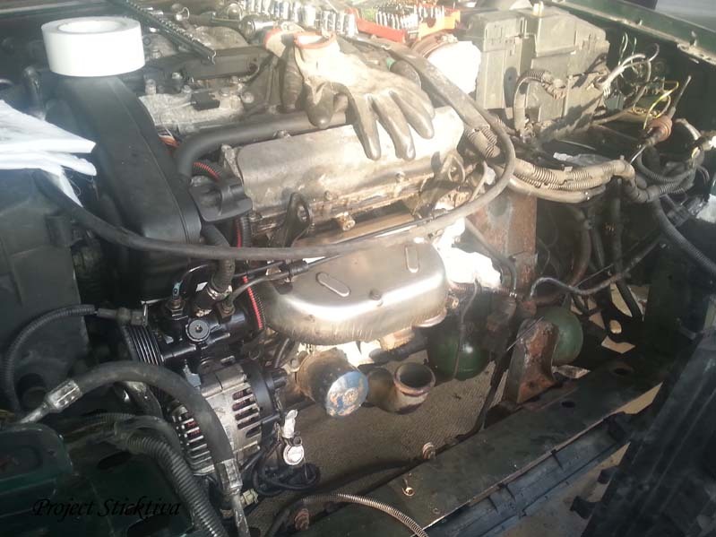

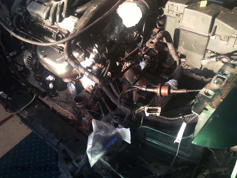

More work today.
Popped down to FraudFords to get a new set of Alen Keys and bumped into a Mobile Air-Con guy in the car park....anyway for a Tenner he stopped by on his way home and emptied the gas....result.
Anyway that allowed me to get on with the Air Con Rad and pipes, started exhaust, various BSI etc removed and gloved in bags. And Yes, some corrosion on the connectors.
So V6 owners, how well does your car suck ??
And how well does it Blow ??

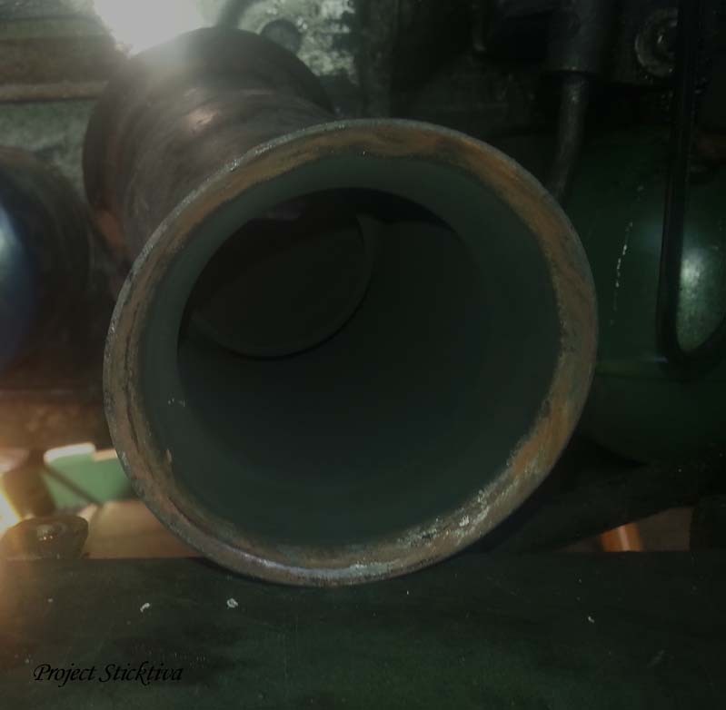

note the BIG restriction here, very poor.
Stripping goes on...all cleaned up as I go....so much crap from the low area of the rad, VERY much an area to look at when cleaning the car.

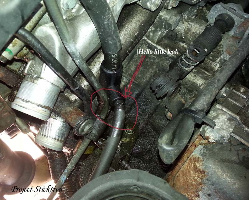

a leak discovered..
That's it for today.....and not one knuckle damaged

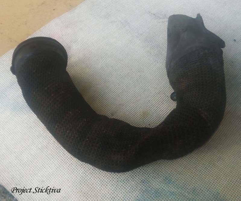

That air intake hose is a real problem Sticky and you have to be so careful refitting the airbox to make sure it's all tickitty-boo
That split in the hydraulic return pipe is very common too... It can let go suddenly and dump all LHM and strand you..
As happened to my V6 last year in my nemesis town of Bicester :twisted:
An event that precipitated me getting a C1...

CitroJim wrote:That air intake hose is a real problem Sticky and you have to be so careful refitting the airbox to make sure it's all tickitty-boo
I bet that split is the main cause of the LHM volume loss on this car then. I can see myself making a few modifications as I go on (whatever) I end up actually rebuilding.
