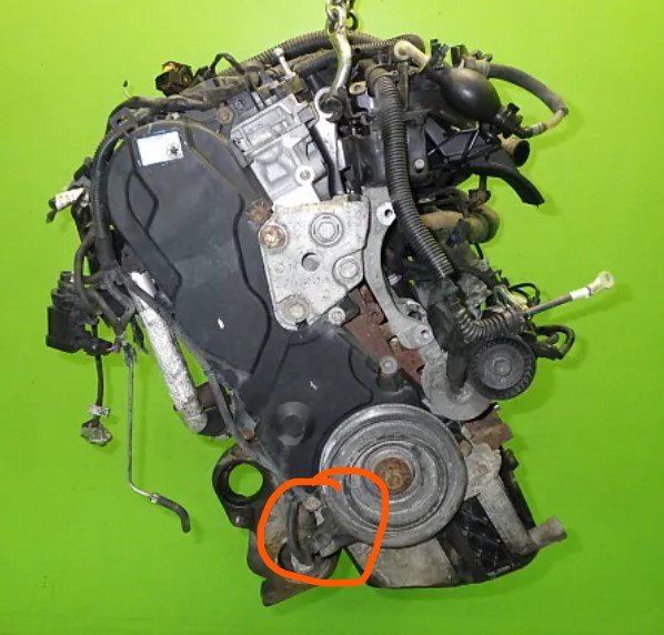

Hi.... getting an intermittent error with my speed sensor ( and the odd hiccup on the road).
I think it's just a bad connection to the engine speed sensor.....but having difficulty finding the exact location.
Could anyone help out with a photo pointing me in the right direction.
I have cleaned all the plugs I can find in the engine bay but would like to be sure I've done the culprit of my woes!
Thanking in advance...Adam

Re: Location of engine speed sensor 2.0hdi RHR
Unread post by wheeler »
It should be right at the crank pulley around the 8 o’clock position
This is where it is located
Unread post by baser2010 »
Yep....got under there today and gave the connections a clean.
Ordered a new one...hopefully the drama will be resolved.
Update!
Sensor plug clean seems to have done the trick.
800kms of driving since and it has not come back.
I have the new part in the spares kit but I think I'll just run with the existing as it seems fine.
