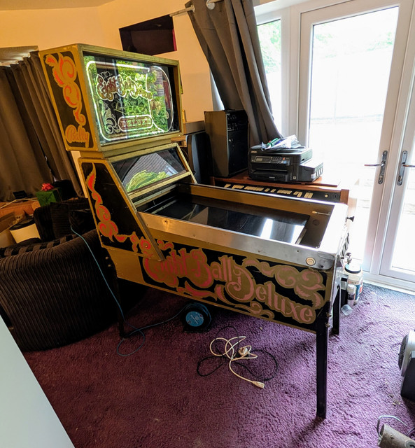

Made a little progress on the pinball project today.
First was getting a few things ordered. Most importantly in the first instance being a pair of flipper button switches. The normal switches on this would actually have been on the play field itself I believe, whereas I need to fasten them to the side of the cabinet. Helpfully Gottlieb ones from the same sort of period used a flat bracket which will do just fine for my purposes. Hopefully putting Gottlieb parts in a Bally cabinet won't make it spontaneously explode...
The other bits on order (well not on order, I've actually asked a friend if they have any spares floating around first) are a compliment of eight solenoids which will be installed in the cabinet to provide audio and tactile feedback for when things fire rather than just relying on simulated audio through speakers (8x solenoids - two flippers, two kickers, three pop bumpers and the replay knocker). Additional to that will be a chime unit. This won't be needed on (most) solid state tables obviously, but will make things seem far more authentic when we're simulating electro mechanical tables.

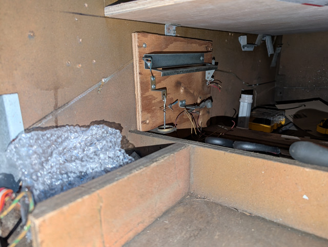

Made a bit of progress on the cabinet as well. One step was pulling out the remains of the original wiring loom which I won't be using any of.

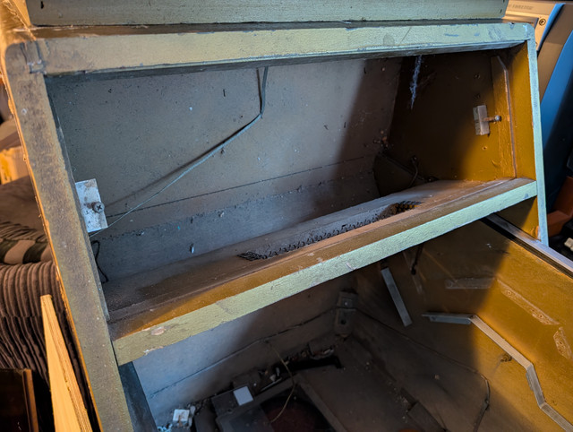

A change I needed to make to the cabinet to allow for the use of the display panel essentially becoming the playfield was to drop that down so the surface of the screen is at *roughly* the same level as the playfield would originally have been. The sandwich of the display panel and panel it will sit on is exactly 90mm thick on the wide side, so I simply dropped down the original rails by that amount.

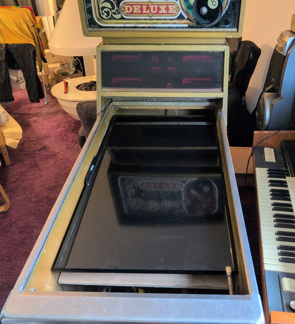

The board containing the tilt devices had to move slightly as it would have wanted to occupy some of the same space. Was pretty easy to just shuffle it a little further back in the cabinet.
With the display dropped down a bit it is starting to look a bit more like an actual machine again.

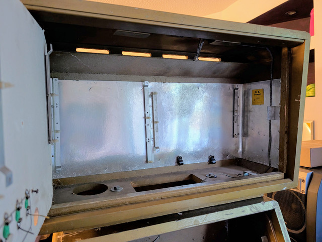

In the space behind the playfield display there will be a trim piece, probably also fitted with some high intensity LED flashers to work in concert with when some high power flashers on the simulated tables would have fired - as that's obviously something you just can't get from an LCD display.
There will also be a thin wood trim added around the edge so the asymmetric bezel of the display will be hidden from view once we're done.
I've taken some measurements in the back box. It looks like we *might* have room to install the PC in here.
Aside from the historical symmetry as this is where the original MPU and driver boards would have lived it would just be convenient. There are already a bunch of nice mounting rails in there and it would be a nice way to help reduce clutter in the base of the cabinet. The big question is going to be if I have enough depth to play with - it'll be close, depending on how much depth I'm going to lose for the display that will also be there. It's not the end of the world, as I actually have a bunch of open space behind where the middle display will be, which is just a peculiarity of this slightly oddly shaped cabinet.
Usually space in this area is at a huge premium in more conventional cabinets.
To be honest space is likely to be an issue once we get going with this - there's a lot of "stuff" to cram in there yet. Plus a LOT of wiring. Actually fitting it all in isn't so much a problem as fitting it all in in a way which maintains any semblance of serviceability and doesn't look like a complete rat's nest.

The colourful spaghetti looks good, but by eck those meatballs have been cremated!
Not well versed on such matters but I'd not have guessed a surform was the tool for wiring strip out
