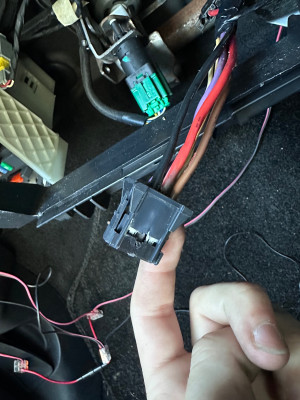

Hi all, does anyone know where I can get a replacement for this? All the ones I’ve ordered so far are much thinner and this one has burnt out so doubt they’ll last much better!

If it was me, I'd get a breaker to cut one out of a scrapped car, then chop off the melted connector and replace the lot.

If this is for the cabin fan, maybe the fan has a fault so is taking more current than normal. Also check any fuses for it are the right ones and the connector is clean/making good contact with the pins/spades so are not arcing. The pollen filter could also be in need of replacement.
