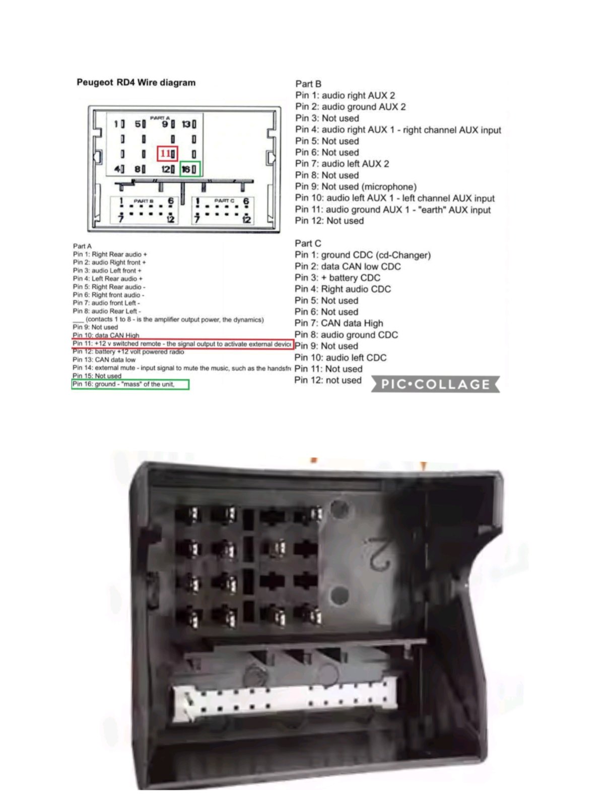

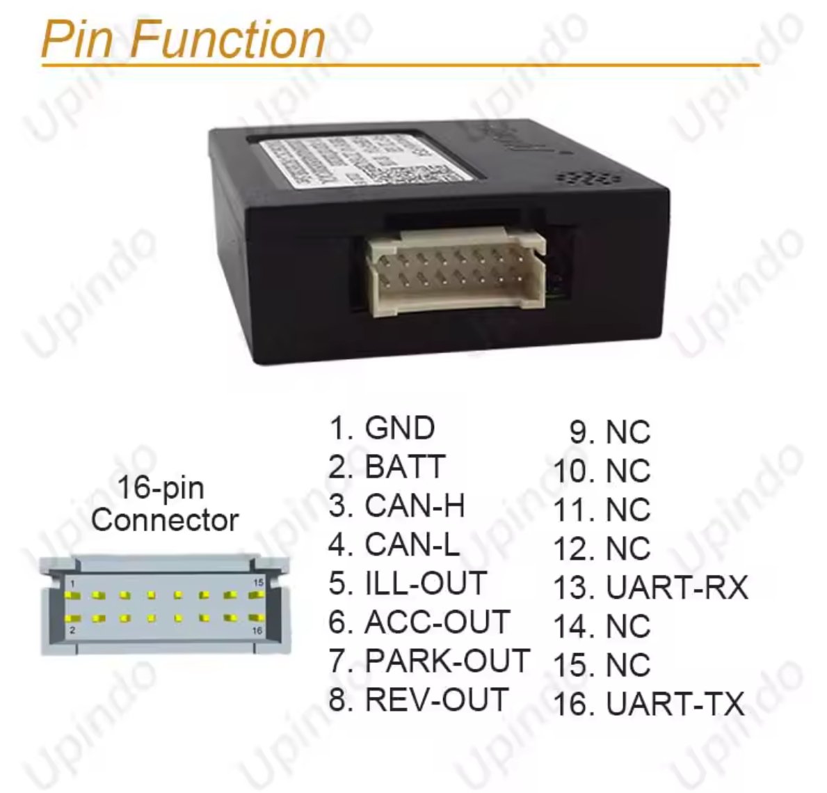

The same battery drain exists with the aftermarket radio connected, and when nothing is connected (everything is disconnected). Only with the oem radio everything is fine. The aftermarket radio has a canbus decoder, so it only receives and decodes information from the canbus network and sends it to the unit, I'm not sure if it can send something over the network and communicate.
Connection of head unit is very simple, plug and play, it is impossible to make a mistake. I tried 3 different canbus decoders (manufacturers) , everything is the same.
I also post pictures of the connectors (pinout) if needed.
