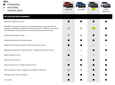

Surely you would of checked the trim level had everything that you wanted before buying the vehicle? I don't understand how people can make a major purchase like a vehicle and not make sure it has everything they wanted. There are the various trim levels and then there are optional extras. Did you not check the specification over when you bought it?
The other issue is that they change trim level equipment all the time. In your case I believe the previous 2008 models from 2020 had the connected navigation, but the 2024 2008 GT does not:
But to be honest, I wouldn't worry too much. Just get an app like Sygic Navigation and use this via Android Auto or Apple CarPlay which your vehicle has. Basic features are free, including the maps, but for only £14.99 a year, you get all the premium features and that includes like traffic data, Speed limits and warnings, petrol prices and speed camera alerts, road speed warnings etc.
