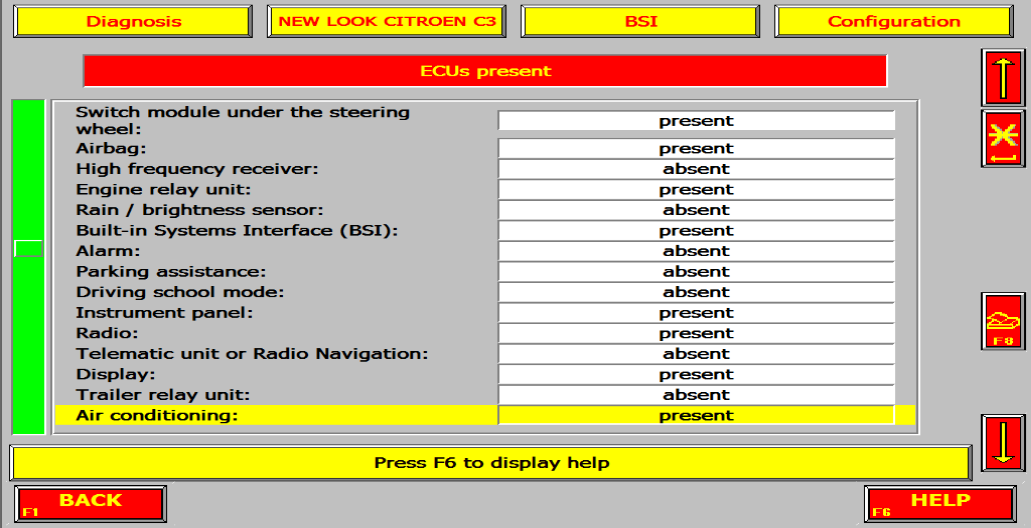

Hi wheeler. Thanks for the quick reply. I indeed tried different configurations. Ignition off, ignition on, engine running AC off, engine running AC on. Nada.
My C3 does not have climate control, only AC. Lexia detects the existence of an AC ECU, at least that's what I think it does. But then simply says unable to start dialogue with the ECU. I can recheck and upload an image of the actual Lexia messages later.
If it didn't have an AC ECU then it would have said so?
Could it be that the the AC unit is not factory installed but rather was installed by the dealer?

I searched for the info you mentioned and found that the A/C ECU is present and the A/C appears as Enabled or rather Present (vs absent).

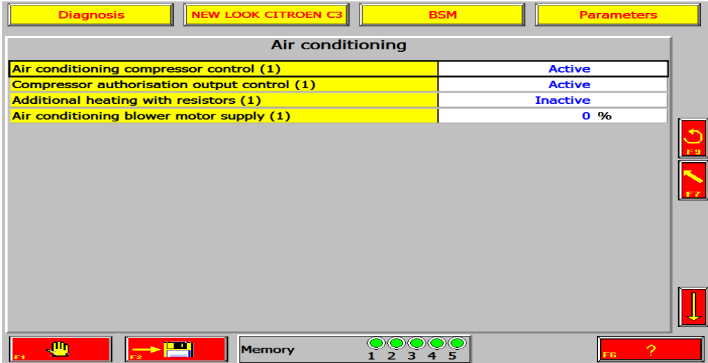

I then tried the Actuator Tests available in the BSI Diagnosis:
All tests were executed correctly, but nothing happened. The first time I tried with the engine running and Lexia showed an error stating that the test failed because it wasn't possible. I then tried with the engine off and the tests were executed, but the compressor did not start. I also tried both heating resistors but no noise was heard. No actuator test related to the A/C unit had a response, although Lexia states that the test was completed. Just to make sure the tests were working I tried testing other actuators like doors and wipers, and they were executed OK.
Afterwards, I started the engine and the A/C and, although the compressor was not running I went to the live measurements screen and got this:
So the A/C appears to be working, at least from the BSI's point of view, although the compressor is not actually running. Finally, I reviewed the configuration of the A/C parameters and got this:
I'm surprised and really at a loss. The BSI detects the A/C ECU, runs the actuator tests OK but the unit itself does not work. Could it be a wiring problem, a blown fuse or a faulty sensor?

Well this shows that there is nothing wrong from a control stand point.
So the alternative is a physical problem.

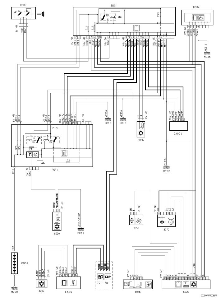

I just didn't have access to the circuit at that moment in time.
I've assumed that the A/C is just the "manual" A/C. The only difference is the controller and resistor pack (labeled 8025 and 8026). The other type of controller would be the electronic versions, but the connections to the rest of the car would be the same. That is; 1 power line, 2 ground lines and 2 CAN lines.
The compressor is labelled 8020.
The evaporator sensor is labelled 8006.
The "high side" pressure sensor is labelled 8009.
The fresh/recycle air door actuator is 9070.
The BSM (labelled PSF1) electronically controls the compressor clutch. That is; there is no relay!
The engine ECU (1320) monitors the refrigerant high side pressure.
The BSI monitors the evaporator temp and requested temp then modulates the compressor clutch to attain a required average temp.
The A/C ECU (8025) derives a "temp" (not really) from the temp knob as requested by the user. This "temperature" is sent over a CAN BUS to the BSI. The BSI then compares the requested temp to the temperature at the evaporator. It the then sends a request over a CAN BUS to the BSM to increase or decrease the PWM of the compressor. If the high side pressure is too high or too low, the engine ECU sends a signal over a CAN BUS to stop the compressor from running.
The manual A/C doesn't actually set a temperature. It's really just warmer or cooler. The automatic A/C has a "sniffer" that senses the cabin temp and compensates to keep an actual cabin temperature.
The power for the compressor clutch comes out of pin 1 of the Yellow (JN) 5 pin connector on the BSM.
ALL the other signals are communicated over the CAN lines!!!
If the A/C is not working and you cant "talk" to the A/C ECU I would start looking at power and/or earths to the A/C ECU. A6, B2 and B4 of the A/C ECU connector.
By the way, if you have a manual slider to select fresh or recycled air on the "manual" A/C panel, there will be no actuator 8070.

Here is the climate control A/C circuit.
8045 and 8085 are all in the one unit, the cabin fan speed controller. They are not separate bits!
8050 is the cabin fan.
8030 is the "sniffer" that I mentioned.
8065 and 8071 are the temperature blend door actuator and the air outlet selector actuator.
