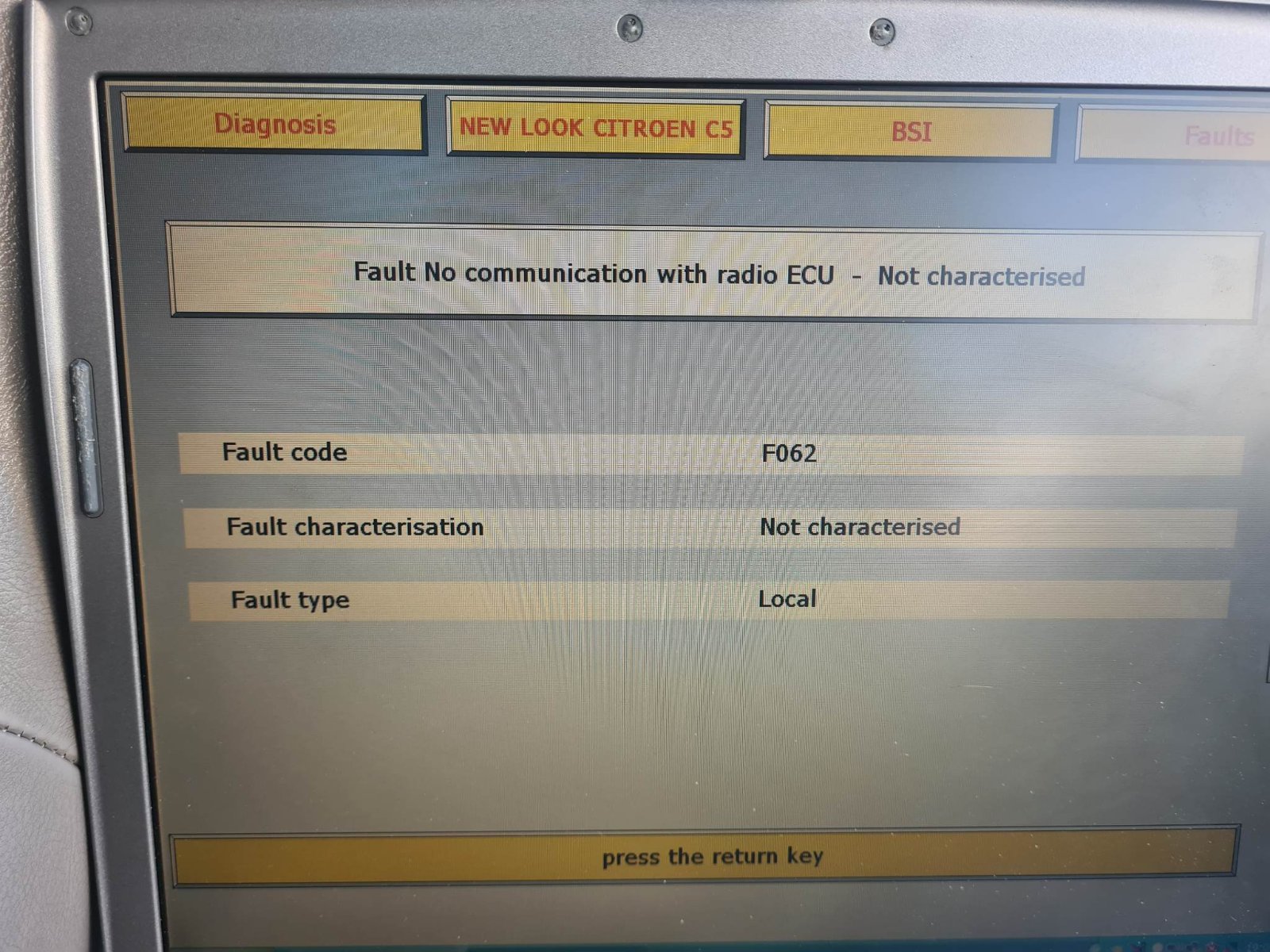

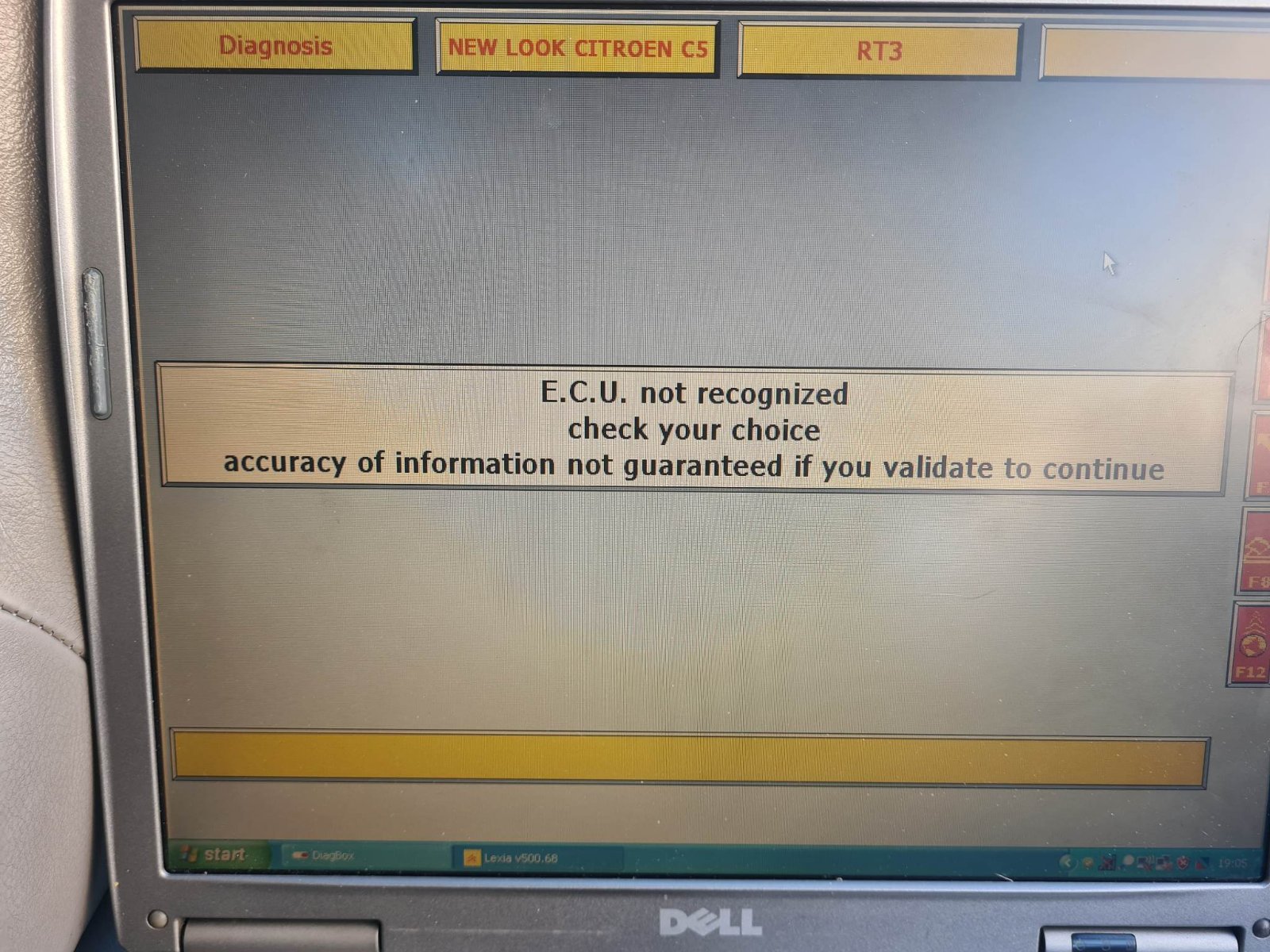

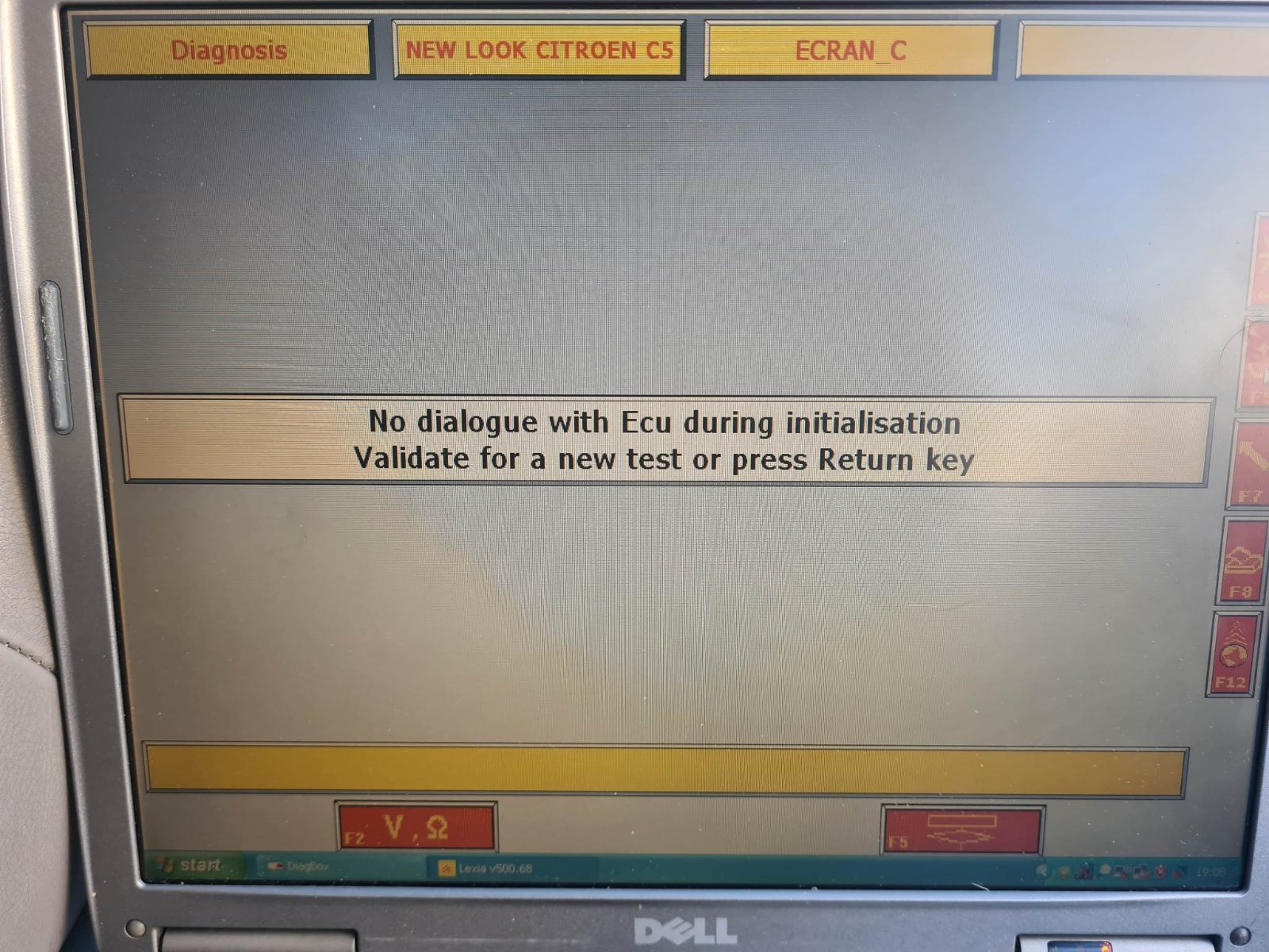

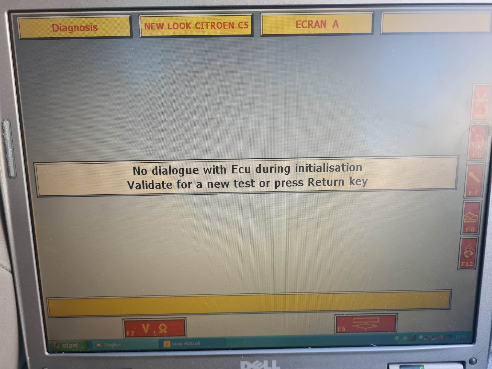

Coding replacement RT3 - cant find ECU in lexia

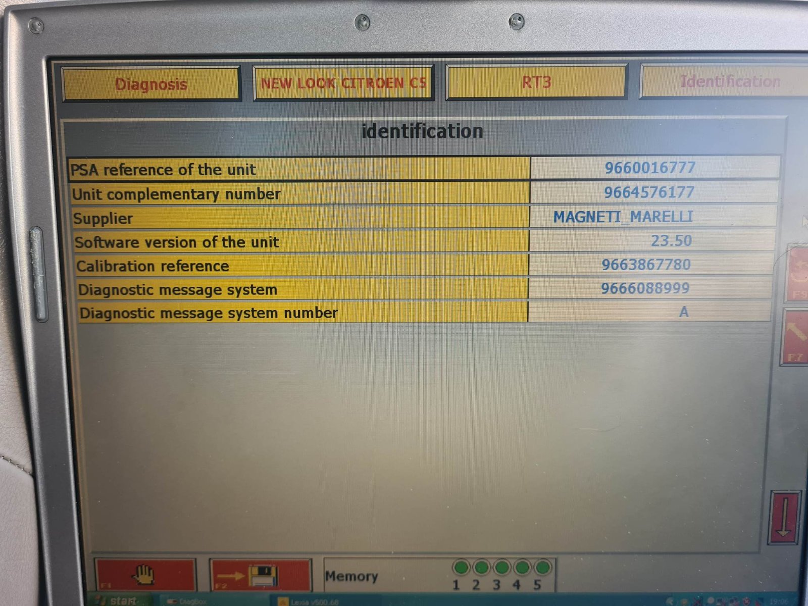

This is the RT3 unit and was made by Magneti Marelli
The RT3 was available in a few different hardware versions, the later ones supporting MP3 playback. These units had an optical connection to the Display Screen.

Its an RT3 with MP3 function to give it the proper name (HDD etc) . Yes its properly wired up inc the dev cable. It was working till i switched something off (and yes ofc, you warned me). I`ll go take a new photo

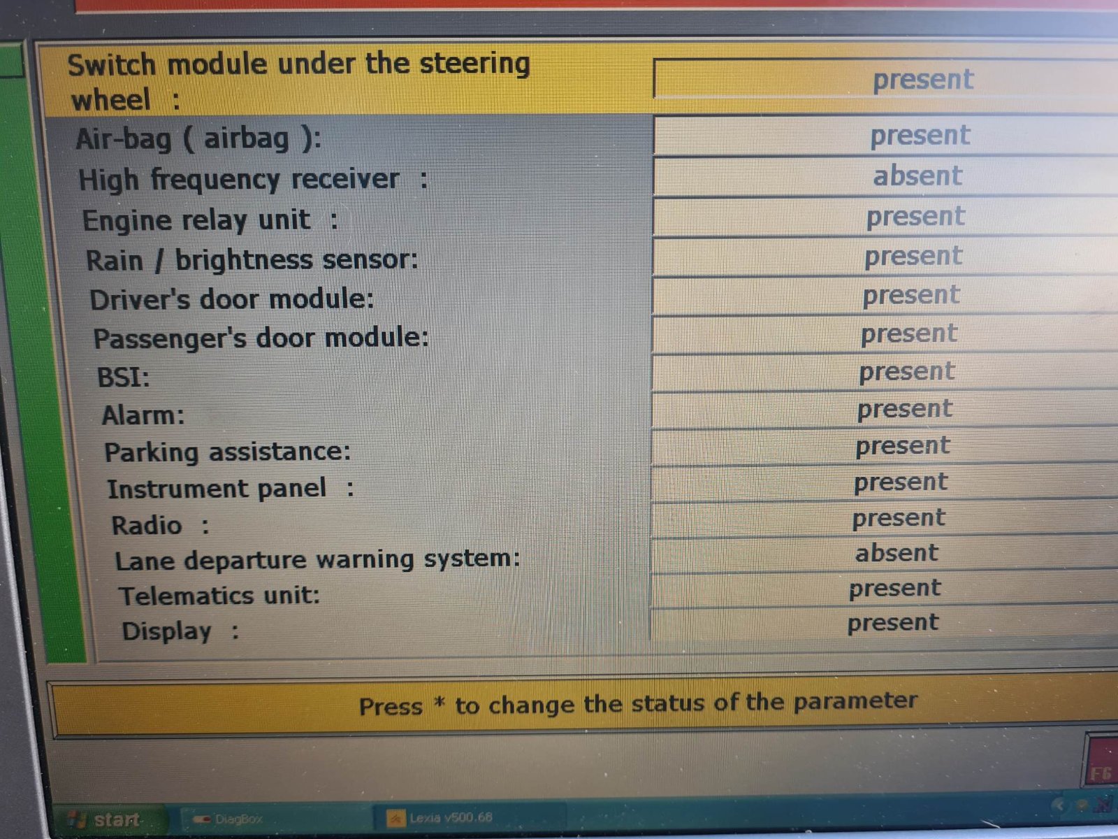

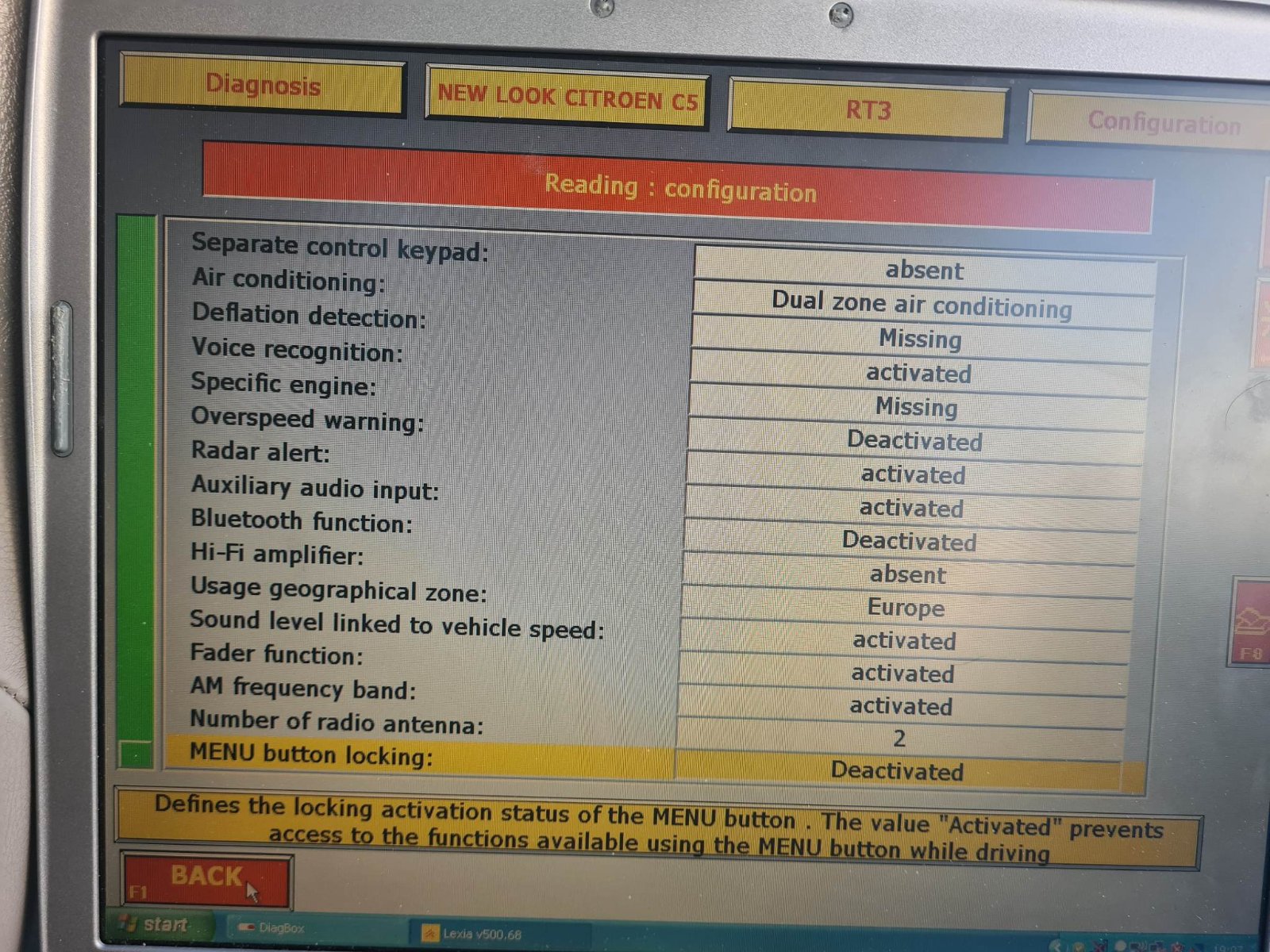

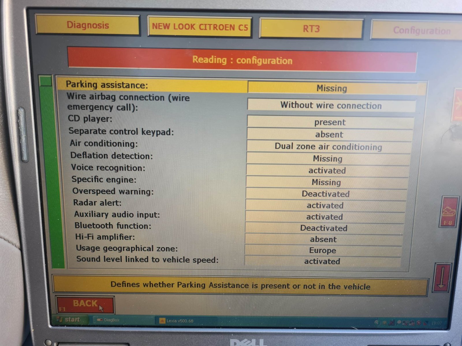

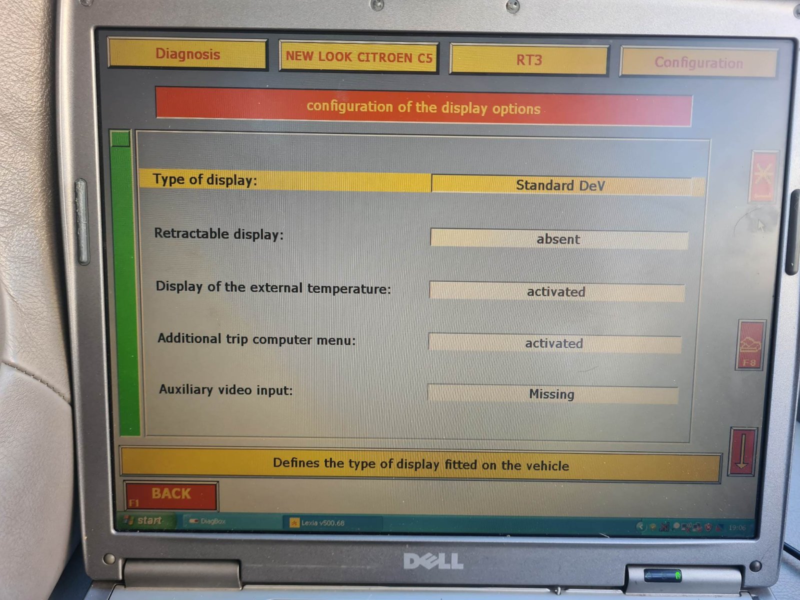

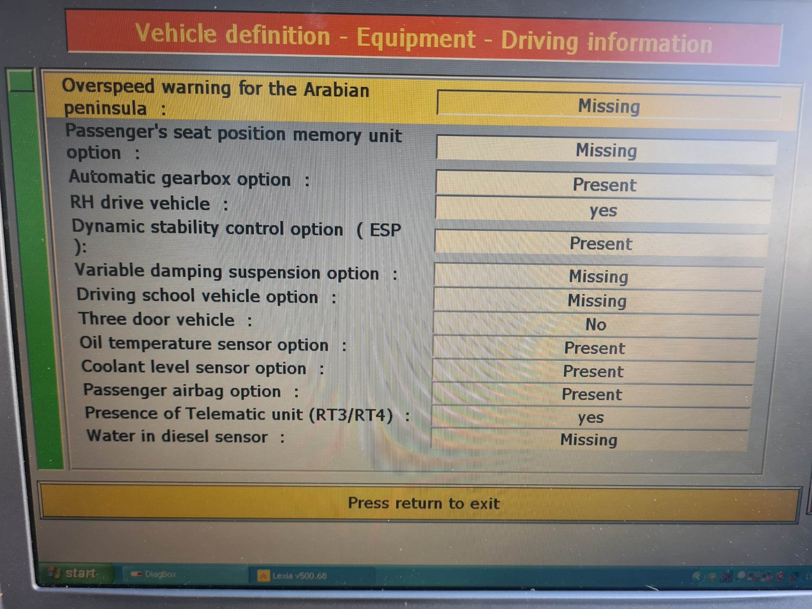

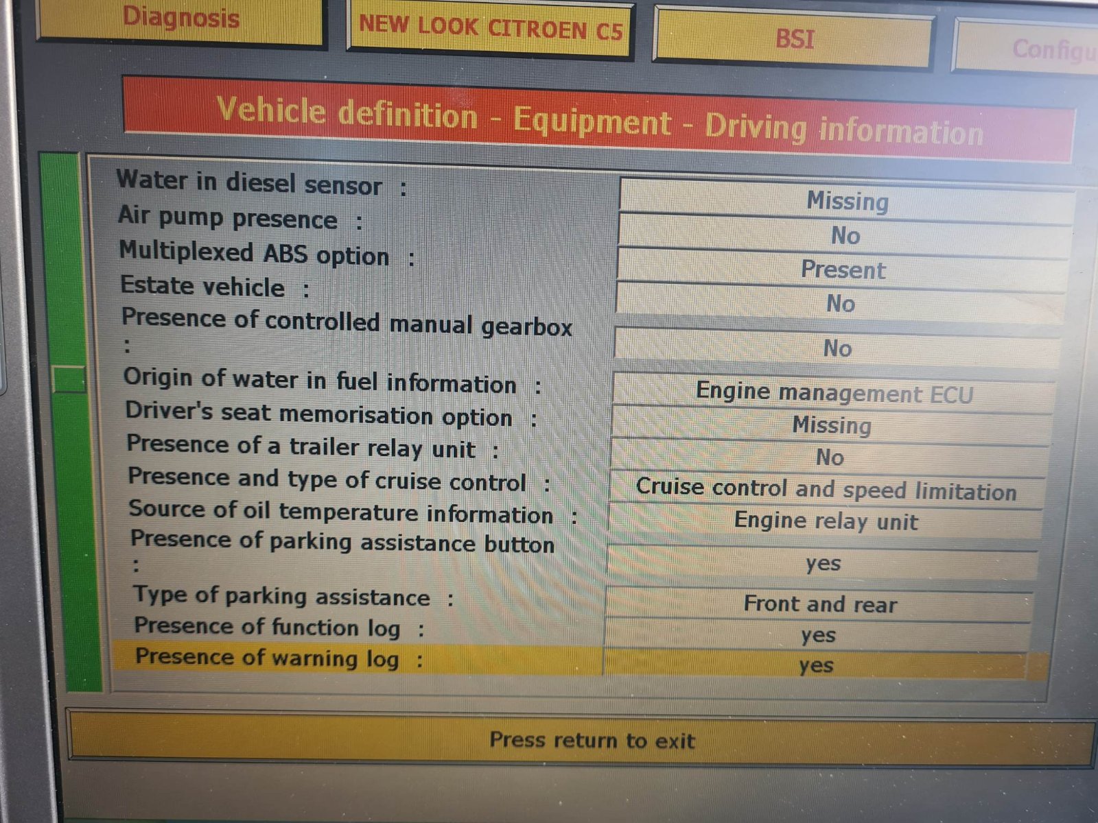

Ok, no worries all sorted now, but what I need is a page by page screenshot of the current configuration pages of the RT3, so I can see the option and the setting.
Also, please confirm you have the Colour version and not the monochrome version of the RT3.

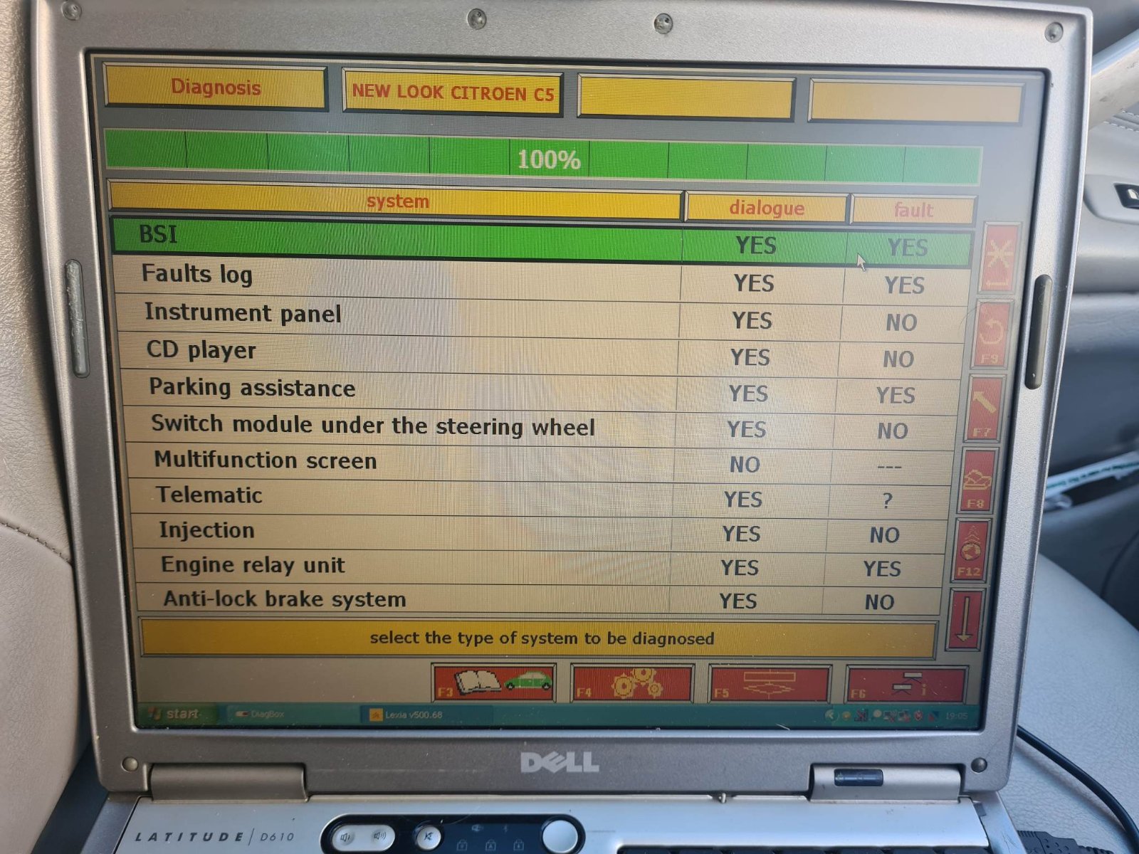

Its colour, software version is 6.63 . Taking photos shortly in diabox

Ok leave it with me while I go and get a G&T for this one.
Posts: 42019
x 6955
Re: Coding replacement RT3 - cant find ECU in lexia

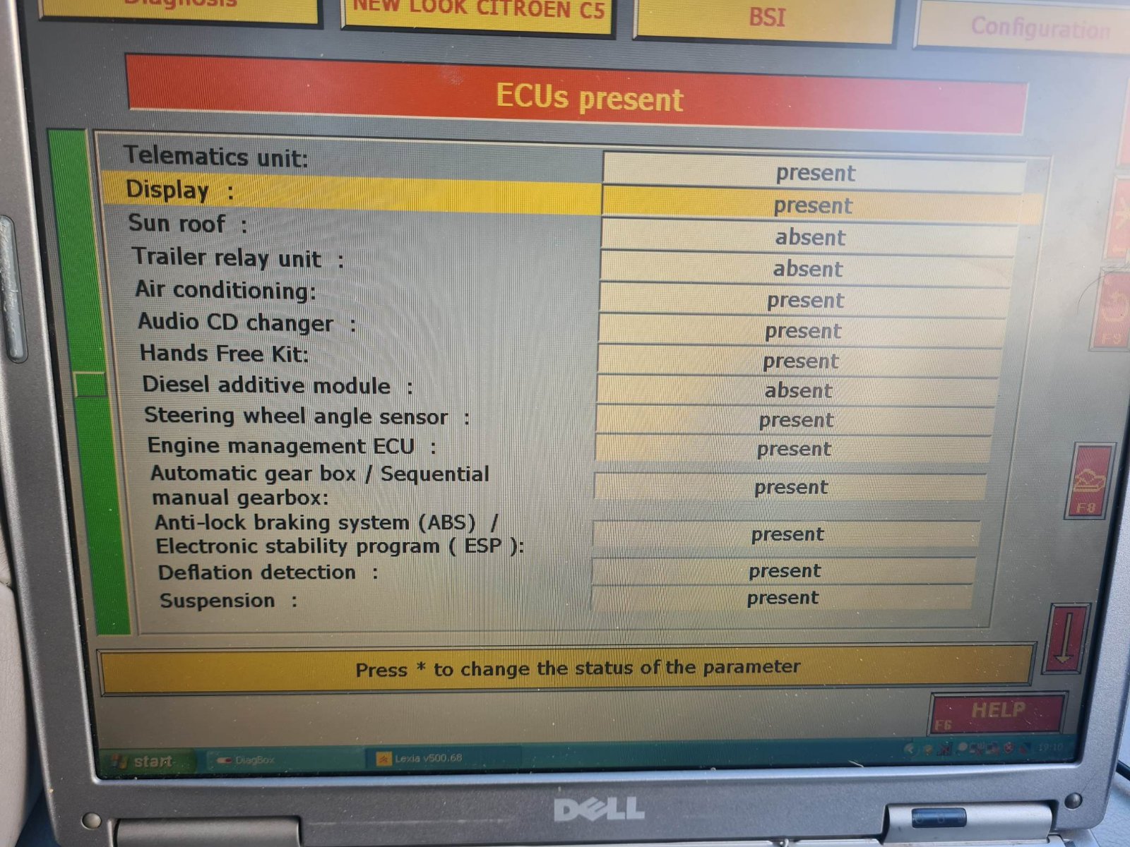

Screen one. Should not have hands free kit with telematics unit.
Screen 2 RADIO - this should be set to absent with a telematics unit IIRC. This should only be active for standard RD4 radios.
Screen 9 - Deflation Detection should be present for your 3.0 litre.
Parking assistance should be active Front & Rear.
Aux Video input - suspect this should be missing.
Harlequin
Posts: 915
Joined: 11 Jan 2006, 21:11
x 24
Unread post by Harlequin »
no deflation - 3 of the 4 sensors went bad so i had them all removed, yes i can put new ones.
radio now remvoed , hands free now removed
parking assist has dodgy wiring at the front somewhere i think, so doesnt work anyway
aux input now off

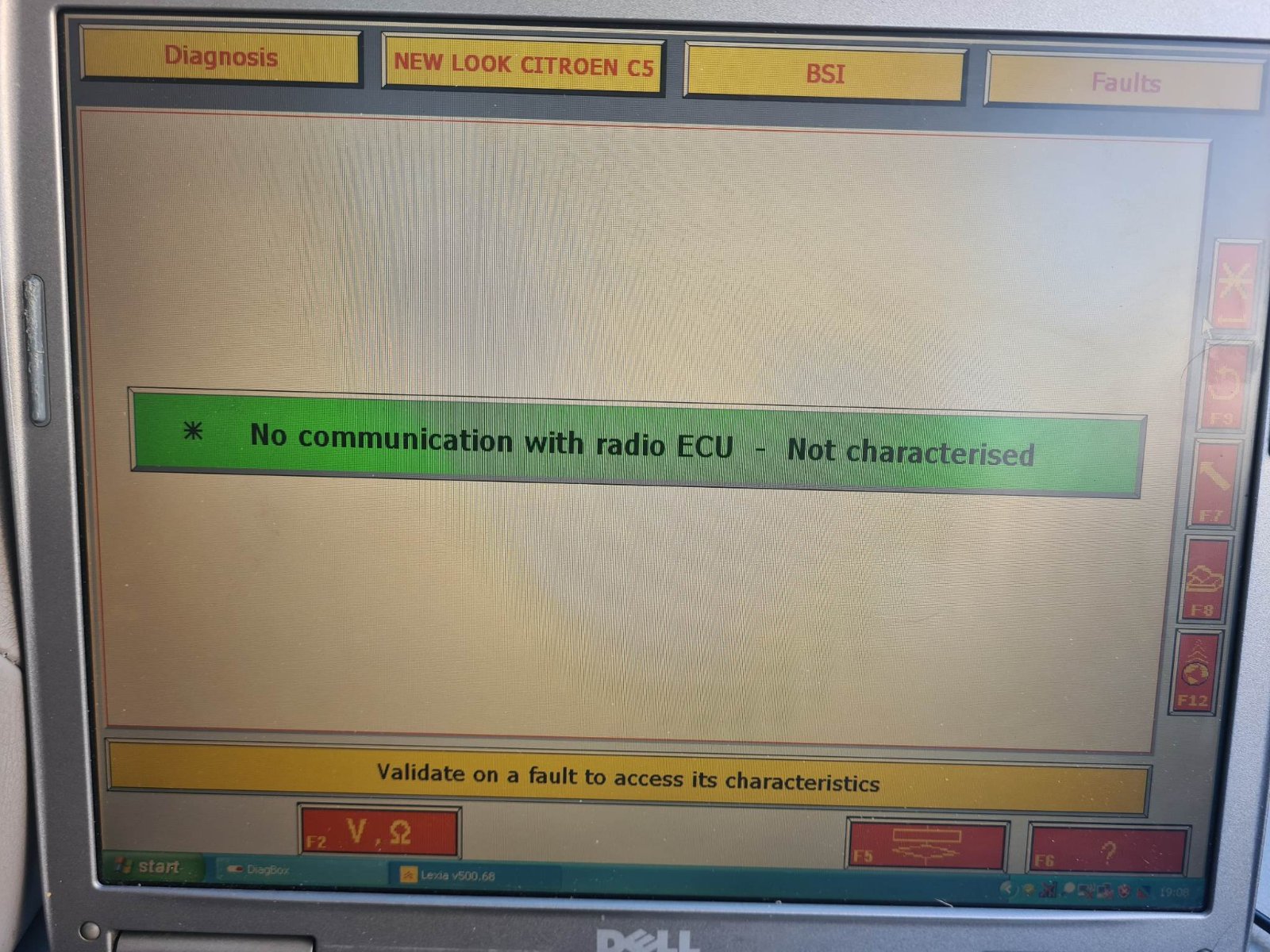

Holy Thread resurrection - as a final note, sent bsi/ecu and keys off to be reflashed and paired to a chap in wales and voila, solved the problem. Lesson learnt
