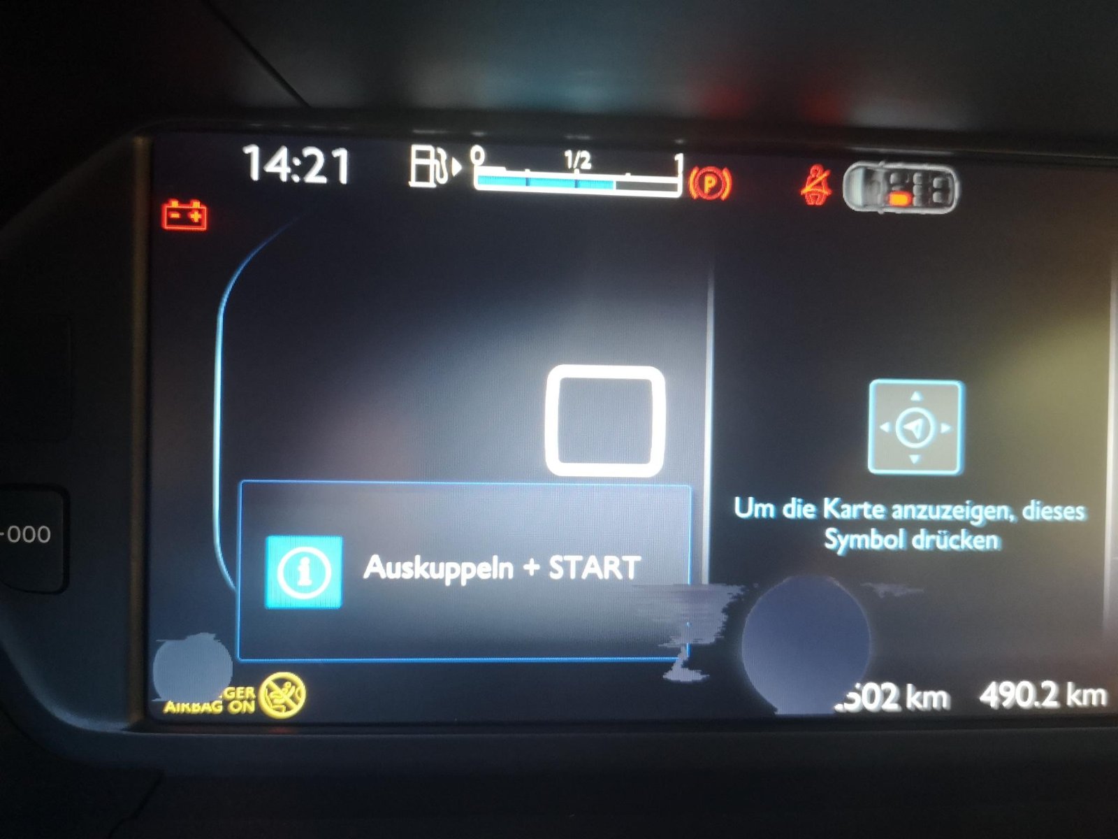

I haven't encountered the white hue issue. However I think I have the same problem with the dark spots (see images attached) that you've been describing. I can't read the total trip length anymore
Could you tell me a bit more about the fix? How expensive and foremost who was capable to unmount/replace the screen? Difficult?

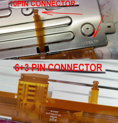

Seems like I found out the problem. Thanks to "Rick4hun" from MHHAuto.
The service who repaired my display likely put bad display in my unit. They are all labeled as "LLB123LT01" but have different connectors.
The older version has 10 pins on the smaller connector. Newer version has 6+3 pins on the smaller connector. You can see which type you have by the board in the unit.
This is older 10 pin connector board. This is newer 6+3 pin connector board. The newer version does not have MAX16814 module on the board.
You can see it in the upper section here above the connector. So right now I have a 10 pin board with 6+3 pin LCD screen and it is probably the cause of the problem.
The problem is I can't find anybody who is selling 10 pin LCD screens on aliexpress. There are multiple seller who have photos of them in the listing but when asked for authentic photo, it is a 6+3 LCD screen.
