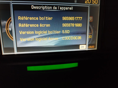

As I managed to get cd unit working again by swapping it for another one, I changed language from Italian to English with the 5.5 cd I had. However I’m wondering whether you have soft with polish language?
Version of my current soft is 5.5D

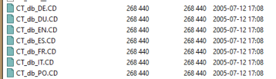

However if you have the V5.5 then it is a VAN Network system. I checked the versions I have and when opening up the 5.50 to 5.95 Upgrade CD, I see that there are the following:
files listed within the ISO:
If the one shown with 'PO' is Polish, then that language may be available, but equally, it may just be info regarding the mapping CDs and nothing more. The only languages available will
be what are shown when you opt to choose the language when it asks you to input the firmware CD.

Po probably stands for Portugal. I would expect PL for Poland . Anyway, is there some major difference in these two soft versions ?
Not sure if I need it if I’m after language change that is unavailable in newer version.
