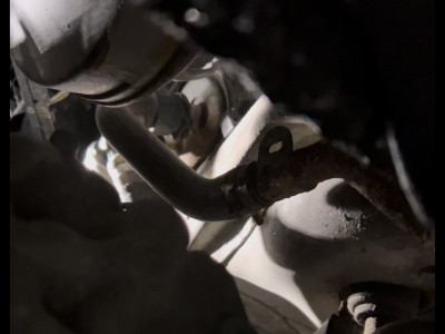

Does anyone have the parts number for this rusty coolant pipe?
In the left wheel well of a 2012 Peugeot 508 GT 2.2.
VIN VF3**************[VIN obfuscated, can be read by forum staff]
Parts number coolant pipe? Ruuuusty.

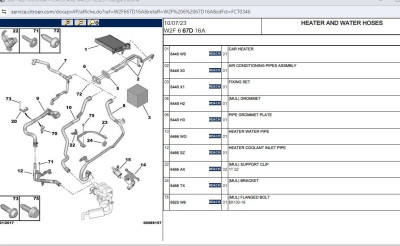

Re: Parts number coolant pipe? Ruuuusty.
Here's the cooling system diagram:
Item 1, which is the bottom 'hose' seems to be the only near the LH wing. This is £160.06

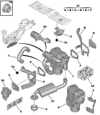

Although, it appears to have a webasto unit under the wing? it might be part of that. Need a better picture...
- Posts: 37688
- x 5800
Yes, this one is fitted with additional heating Richard:
Looking back from the wheel well. Looks correct that it’s coming from the webasto and in to the heater core (?).
Number 8 here maybe?
I’m driving the car daily so I would like to get the pipe before I’ll take it apart..
Forgot there was a separate diagram for heater hoses...
Only 10 is fitted on yours 6466WG @ £80.98
But it looks like it might be 12 which appears to be part metal? 6466 SZ @ £242.28
Strange. The shape and the brackets of mine looks like “8” (6466SL ?), but I read somewhere that it was discontinued, could “10” be the replacement? Looks like a all rubber hose.. would be nice not to have a metal pipe in the wheel well…
Oddly, item 8 says:
08
6466 SL
01
HEATER WATER PIPE
- REPLACEMENT PRECOND HEATING UNTIL RPO 17042 OR DW12C FAP TURBO DIESEL AND PROGRAMMABLE AUTOMATIC ADDITIONAL UNTIL RPO 17042
Whereas 10 says:
10
6466 WG
01
HEATER WATER PIPE
- REPLACEMENT PRECOND HEATING OR DW10CTED4 FAP TURBO DIESEL AND BVM6 AND PROGRAMMABLE AUTOMATIC ADDITIONAL
01
- DW10BTED4 TURBO DIESEL WITHOUT FAP AND BVM6 AND PROGRAMMABLE AUTOMATIC ADDITIONAL
01
- DIESEL TURBO DW10BTED4 FAP AND BVM6 AND PROGRAMMABLE AUTOMATIC ADDITIONAL
01
- PASS COMP PROGRAMMABLE ADDITIONAL HEATING OR DW10C FAP 103KW DIESEL AND AUTOMATIC ADDITIONAL HEATING
Yours is DW12C and RP date 12945, so it looks like part 8 is correct, but doesn't show up on the database for some reason against your VIN. £95.30 in the UK. Sounds like it might a nightmare back and forwards to the dealer to get the right part!
Ok, that confirms it, 6466SL it is.
The staff at the local Peugeot dealer is friendly and laid back, but it usually helps if you know exactly what you need..
Now I do. Thanks!
Summary. The 6466SL i out of stock from factory and no known delivery time.. So I cut the pipe in the "rust free" ends and put a hose (22mm inner diameter) in between. Should work for now.
