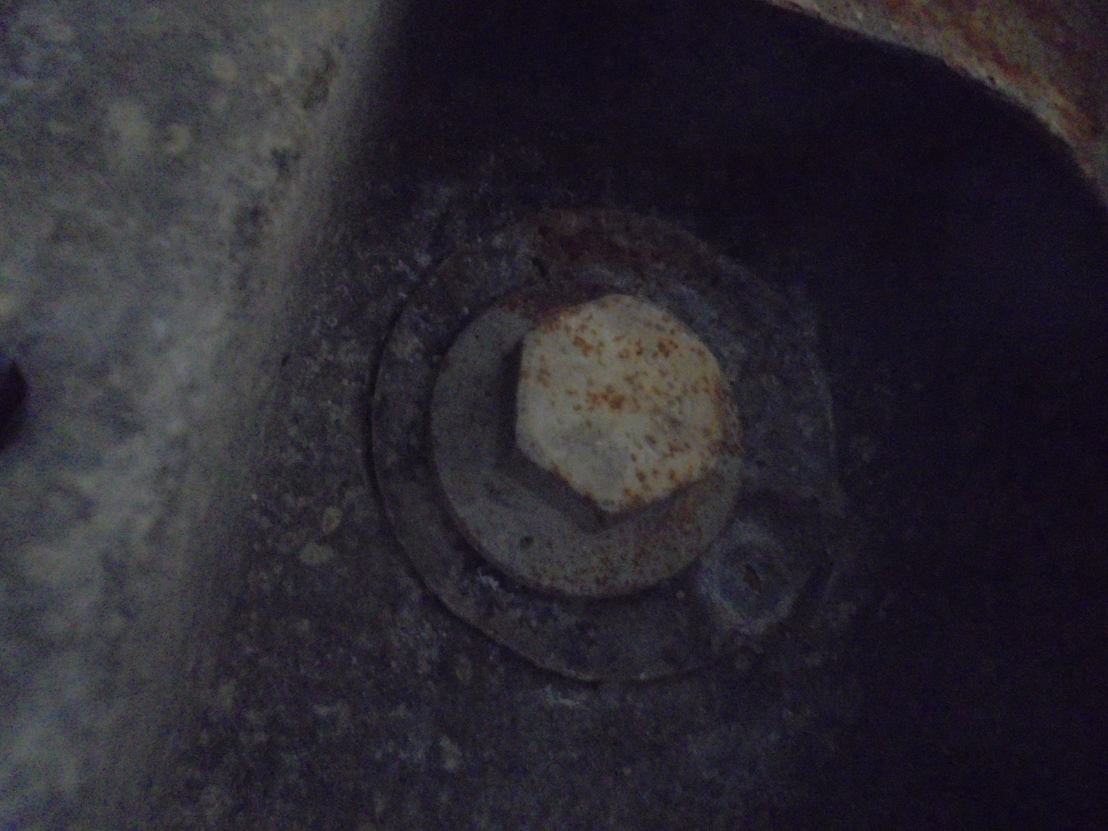

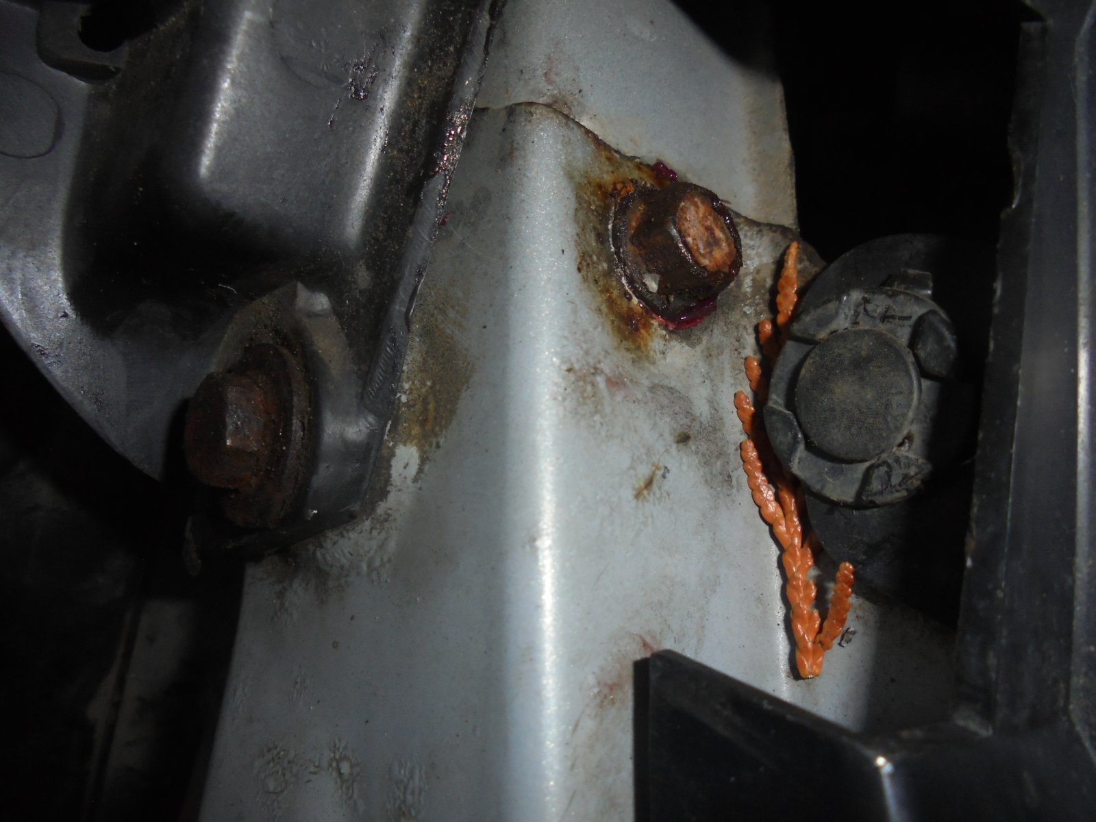

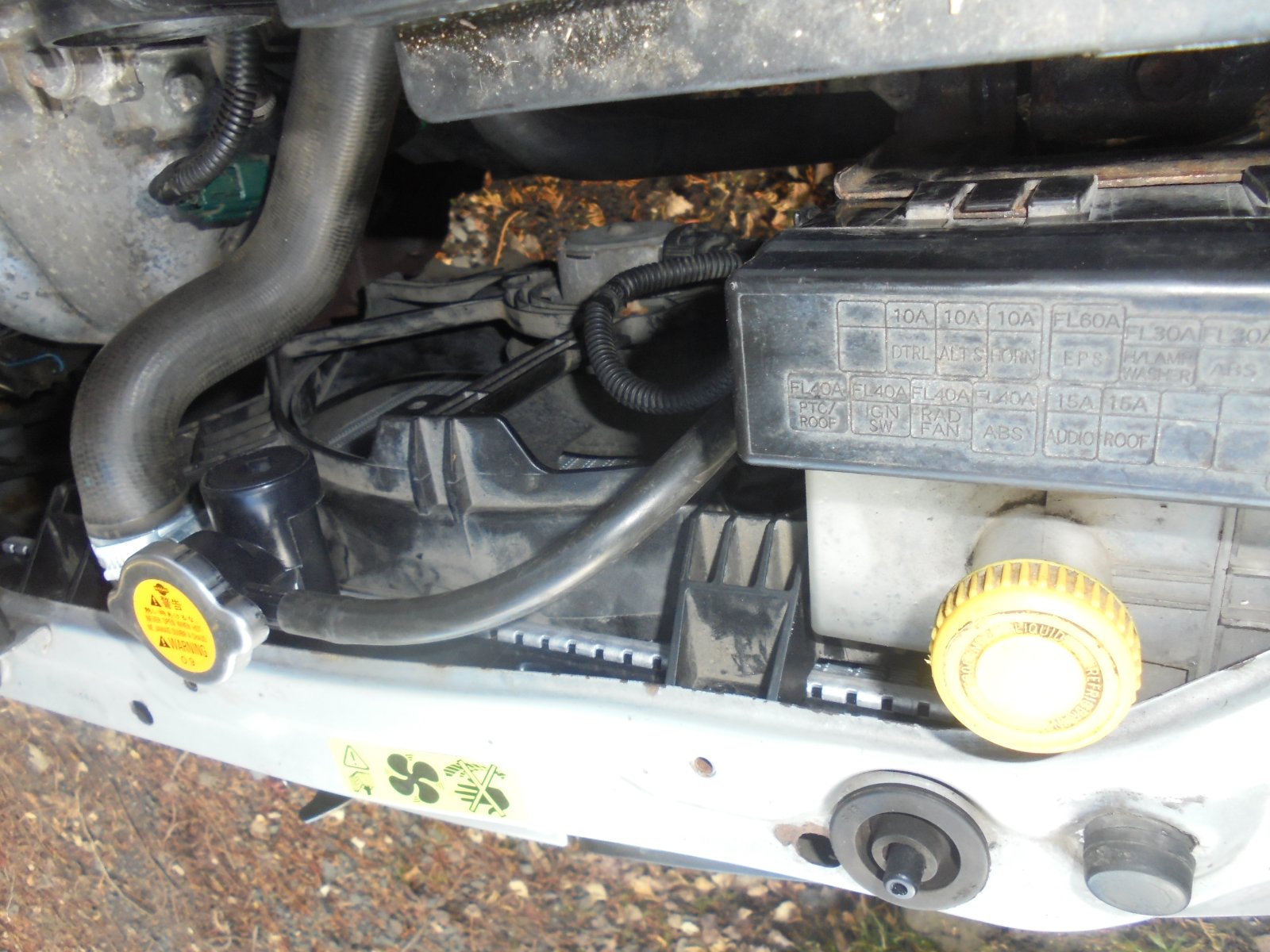

Finally got round to fitting the new radiator to the BB Micra. I have access to the Nissan technical manuals with the workshop procedure for replacing a radiator in the Micra K12, but went off piste.
The radiator is sandwiched between the radiator core upper support and the radiator core lower support. The official procedure drops the lower support and removes the radiator from undernearh the car. After surveying the scene I did the opposite removed the radiator at the top after unbolting the upper support...far easier.
Main reason...only two bolts to remove each side to free the upper radiator core support and two headlight mounting bolts each side to free up enough space to raise the support enough to pop the radiator out of its rubber mountings. In contrast the lower radiator core support mounting bolts had spent their lives under the car soaking up the salt of 18 winters without ever having been undone, and were probably screwed up into a blind hole. Fair likelyhood they would nightmarishly shear off.
Exhibit A Exhibit B Job done, not completely need to get some antifreeze. Neil
