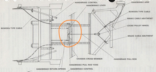

Had TPA out again today. Took the opportunity to investigate why the handbrake was being a bit sticky. As the pull cable had been well greased and the cable at the drum end was moving perfectly freely my suspicions were pointed at the cantilever mechanism under the floor being sticky or the return spring having failed.
Sure enough, it was quite stiff to move, especially towards the end of its travel.
After dousing the whole contraption in penetrating oil and working it a whole bunch it freed off. I'll need to get the car jacked up so I can give it a proper clean up and lubricate it with something better than WD40, but it has at least proven I was on the right track. I do think the return spring might be a bit tired as well which wouldn't help.

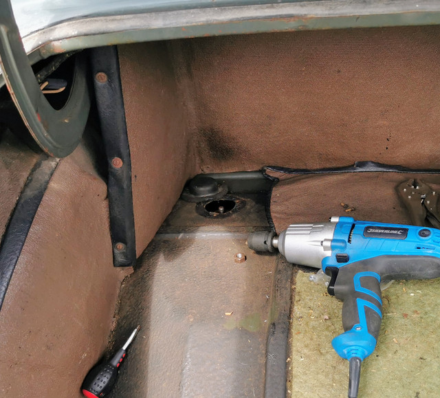

I've also got one of the shock absorbers on the Rover swapped out.
Pretty simple thanks to Rover having actually provided proper access to the top mounting nut.
Basically a ten minute job.
Only slight headache has been the whole upper housing spinning on the nearside one, but I've found the vice grips now at least so can deal with that next time.
The one which came off is utterly knackered. Providing absolutely no damping whatsoever in one direction, but is virtually impossible to move in the other - if I stand on it, it will compress over the course of about a minute. So that won't have been doing anything any favours. It feels based on the old fashioned "bounce test" that there's a lot more movement on this side than the other.
Will hopefully get the other one done tomorrow and will see if that's helped the ride at all.

Other damper now done.
How did I get anything done before I bought an impact gun?
Impact spun the nut straight off without having to bother clamping the top part of the shock in place or anything like that.
Again it was a ten minute job.
Just like the other side this one was providing absolutely no damping in one direction but far too much in the other.
This hasn't fixed the issues with the ride being horribly bouncy, but has definitely helped. So the springs are definitely binding up I reckon - really isn't anything else involved which can affect things. The feeling is that things are over-damped, it's like driving a HGV without any cargo on board. The springs themselves could well just be tired as well. I haven't *seen* any cracked leaves, but I've never had the rear jacked up with the wheels off yet. That might be a job for the weekend if time permits. Will get them given a proper painting with some lubrication at least as best I can without taking everything to bits anyway.

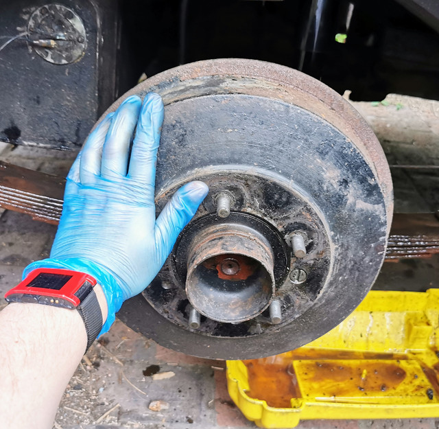

Yesterday evening before the rain arrived I decided to take a look at the springs. Well, one of them, I ran out of dry weather before getting to the second one.
These are some chunky brake drums.
At one point in time these wraps around the springs would have been useful. Sadly that time is long past and they were simply holding in a considerable amount of mud, grit and rust.
So I've scraped all the crud off and given everything a good slathering with engine oil and have left it to soak.
Nothing broken I can see at least. It really does need to come apart to be properly cleaned and greased long term though. If we could get it to something resembling an acceptable state in the meantime though that would be nice!

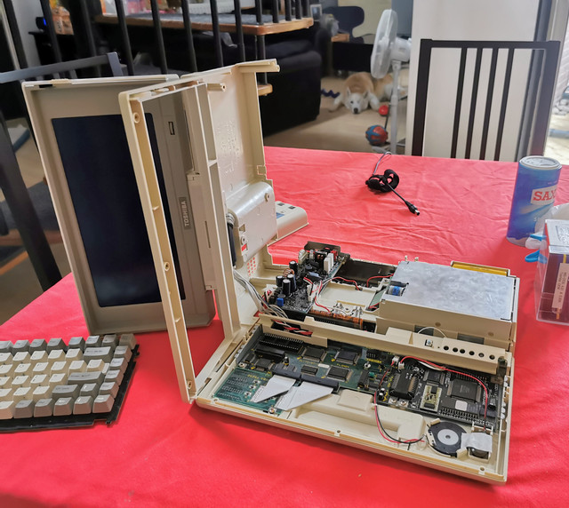

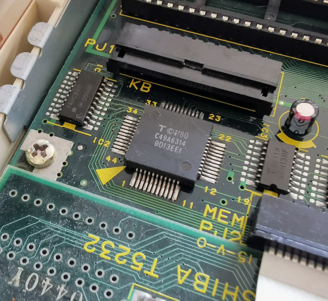

Ran into an old Toshiba computer gremlin yesterday afternoon that I'd not seen before.

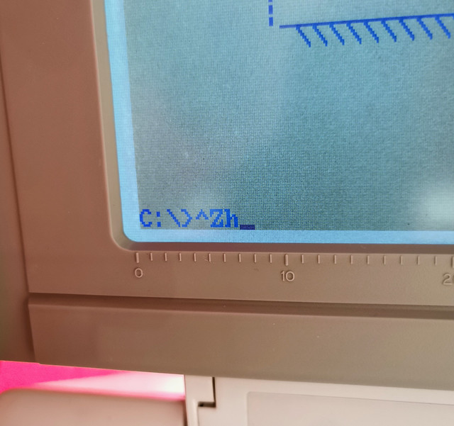

I was typing away when Word Perfect seemingly lost its marbles. A little further investigation showed a keyboard issue. For instance, pressing H results in this.
Which is ctrl+Z followed by H. Turned out to be a few keys affected. Booting up from a floppy disk showed no change so it must be a hardware issue. In we go.
Swapping out the keyboard for a spare didn't change anything sadly. These systems like most of the Toshiba machines don't have a controller on the keyboard itself, the matrix connections are fed straight into the motherboard and decoded on there - on the T1200 this IC here.
I could change that IC alone, but given it only takes about 15 minutes to swap out the logic board and I'd need to take it out to work on it anyway I'm inclined to just swap it for a spare. Not as though I'm short of them. This is a worrying sort of failure though as it's not as far as I can tell due to any external factors, it's just decided that it's lived long enough. Not a huge issue when it's stuff that's fairly readily obtainable like 4116 memory chips in the Apple II, but when custom chips start just randomly dying that's more of a problem. See also the PLA in the C64 for a commonly documented example...
Hopefully this is just a genuinely random failure not the start of a bell curve...I've had very little trouble with these machines up till now beyond the power supply issues and some LCD panels decaying, plus the occasional hard drive that's grumpy as you'd expect about having been forgotten for 20 years.

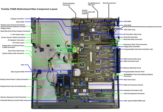

I was working on the webpage for the T3200 when this started playing up. Probably the second most time consuming part of that was putting this together for the page.
I may well go back and tweak it a bit before it appears on the page - the dark blue lines for one I'd like to make brighter as that's a ten second tweak. There's a lot less integration on this than on the last board I did one of these for so there was a lot more shuffling of labels involved.

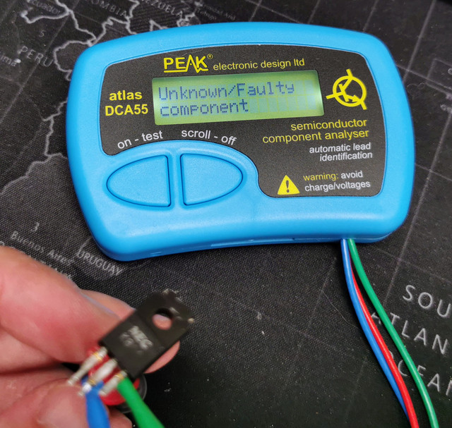

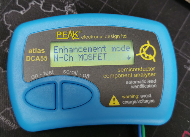

This gizmo finally turned up a couple of days ago.
Which helpfully enabled me to identify some of the completely unlabelled devices on the T1600 power supply boards.
Helpfully it also allowed me to weed out a few dud components.
So I was able to continue rebuilding this board with known good components on the topside.
You'll never guess the plot twist which came up next...
It still didn't work. So something is still amiss with the board, but on this side.

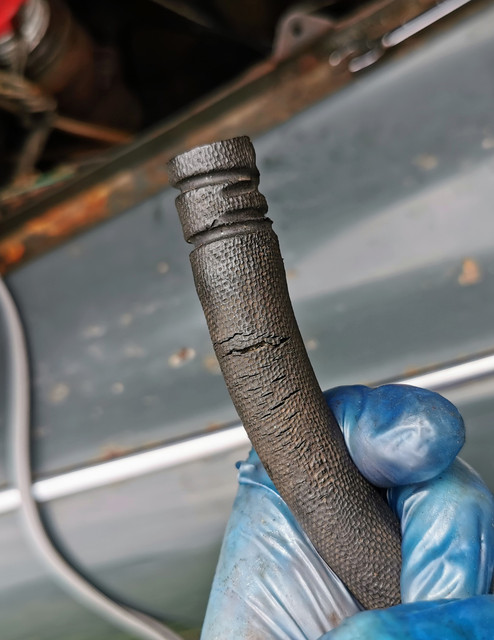

While digging around in that vicinity I did spot one obvious vacuum leak on the brake servo line.
That won't be helping anything.
That's probably disintegrated recently following the failure of the original brake servo a month or so before I got the car, which had resulted in a bunch of brake fluid being drawn into the intake. Easily replaced though - albeit having no impact on our current issue.
