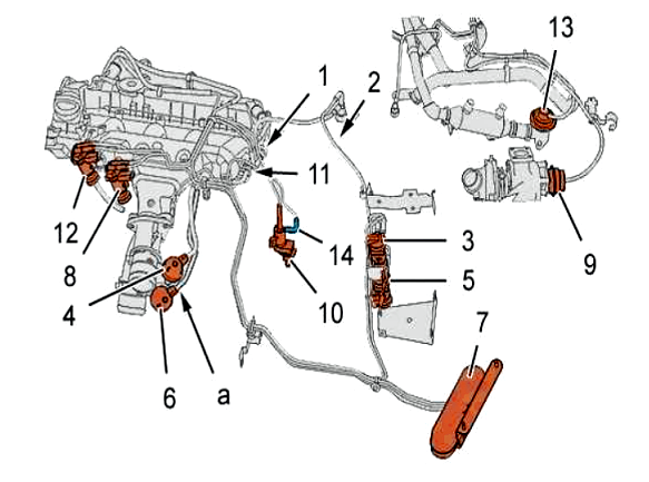

There's no operating parameters for the system that I have, but component / flow chart:
" a" Yellow colour identification on the rubber pipe supplying the inlet air heater meter.
Flow Chart (1) vacuum pump.
(2) Brake servo (ISOVAC).
(3) Butterfly housing control proportional electrovalve.
(4) Butterfly housing meter.
(5) Inlet air heater control proportional electrovalve.
(6) Inlet air metering device-heater.
(7) Vacuum reservoir.
(8) Turbocharger capsule valve proportional electrovalve.
(9) Turbocharger capsule valve.
(10) "Swirl" control electrovalve.
(11) "Swirl" diaphragm.
(12) EGR valve vacuum proportional electrovalve.
(13) EGR valve.
(14) Vacuum pipe linking the "Swirl" electrovalve to the "Swirl" diaphragm.
Connections of the unions on the electrovalves ( 3), (5), (8) and (10) :
"b" Control proportional electrovalve
"c" Colour reference on the electrovalve
"e" Electrovalve outlet pipe with colour reference (at "d")
"f" Electrovalve inlet pipe
Colour References
N.B.: The pipe ( e) should be connected facing the colour reference "c" on the electrovalve "b".
Connection of the unions on the electrovalve ( 10):
"g" Colour reference on the "Swirl" electrovalve
(14) Vacuum pipe linking the "Swirl" electrovalve (10) to the "Swirl" diaphragm (11)
Colour Reference
N.B.: The pipe ( 14) should be connected facing the colour reference "g" on the electrovalve (10).

Thank you very much, Marc.

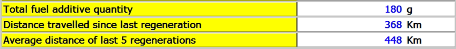

Every 450km, 180g. There's a video with a run up a hill watching the PDF parameters in an earlier post, though I'm not sure what, if anything, it tells us. Whether the regen is actually doing anything or the pump is actually injecting Eolys... that I don't know.

Your data suggests your DPF may not be overloaded. Below is my data for comparison after I received the warning "clean diesel filter asap", which will have resulted from 3 consecutive failed regenerations. I have also noted your DPF pressure difference is 58mb. I do not know the value which triggers a regeneration (Does someone know) but 58mb seems pretty low to me. Mine was around 300mb.
My "distance since last regeneration" was 700km, yours is 368km. "last" generation would normally mean last "completed and successful" regeneration.
My "average distance of last 5 generations" was 200km, yours 448km. 400km is the official expectation, but depends upon driving conditions. 200km for my driving was very low and was a clear indication the DPF was becoming increasingly difficult to regenerate (due to long-term build up of ash). Indeed, I was aware from my DIY "LED regeneration indicator" (no patents pending!), that regeneration was being attempted a lot more frequently. What I did not appreciate was that the previous 2 attempts had been unsuccessful - the car does not tell you until it fails 3 in a row.
