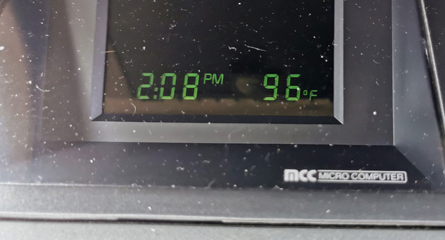

Yes that's obviously a temperature reading taken in the sun...but guess where I'm sitting/standing while working on things...yes, in the very same sun.

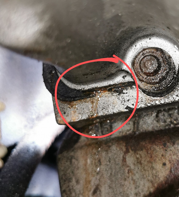

Rover 110 is peeing coolant down the side of the block. Only feasible place for it to be coming from is from the head to block seam unless something is cracked very near to it.Rp0thejester wrote: 22 Jun 2023, 18:21which cars have the head gasket issue? Just out of interest.Zelandeth wrote: 22 Jun 2023, 15:27 I'm getting the impression I've done something to anger the gods this month.

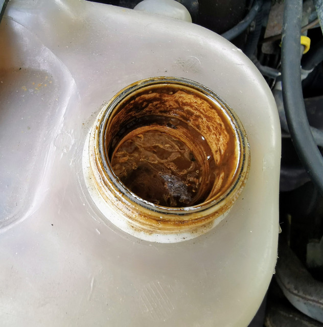

Renault 25 pictured above has started to pump oil into the coolant. This engine doesn't have an oil cooler or anything which could be a likely candidate for such a condition so it's basically head/head gasket issues it looks like. Or of course something more sinister...but head gasket failure seems more likely. I can't see any signs suggesting the head has ever been off in 34 years and 102K miles.

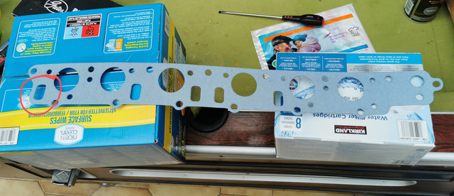

On a slightly less depressing note, things *may* be looking slightly less grim for the Rover though. As I'm sure you would, before committing to pulling the head off I wanted to be as absolutely sure as possible the water wasn't coming from somewhere else.
Using a camera to get where I can't see directly I noticed something which very much made me go "Hmmm..."
See it?
Zoom, enhance...
That is a bead of water running down the face of the head, *above* the seam with the block, apparently from the bottom of the inlet manifold.
The inlet manifold which I know is water heated. Which for some unknown reason my brain had decided didn't have a wet connection to the head...yeah, given there's only one coolant line to it that would work real well wouldn't it? Of course there's coolant passing between the manifold and head.
That corner, where the seal looks distinctly compromised from what we can see of it, I believe corresponds to the circled bit on this new gasket in the photo below.
There's no reason I can really logically think of for that void being there other than for a coolant passage...
So I think we'll try replacing that before we go to the lengths of pulling the head off. Though I'm not actually sure it's all that much less actual work.
See it?
Zoom, enhance...

That was a shocking way to treat a potential customer for a head gasket job Zel
Good news on the Rover
Fingers crossed...

I have to agree that the inlet manifold gasket does look promising! A small point though Zel, if you do have to remove the head there is no need to bin the oil, perfectly acceptable to ensure your oil drain container is clean and then reuse the oil when you refill. If you are concerned about possible swarf in the oil then run it through a funnel with a very fine filter cloth cone in it which will remove any solids.

Well, think you've dodged a bullet with that garage! Better to find out their view now, rather than half way through!
I'd save the oil too, if worried about bits dropping in it then it's ideal for putting back in and doing a short interval change after the head swap -
- which I agree with others is after the inlet manifold gasket replacement as first attempt. Good spot by the way! Not that obvious in the photos!
