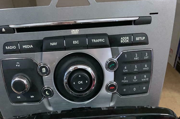

Congratulations! There is an NG-4 radio installed on a Peugeot 308. In fact, it does not work - after turning on the ignition, you can only hear the periodic buzzing - of the DVD drive or something, and that's it... the screen from above, accordingly, also does not show the image - either from the parking sensors or anything another.. Let me know if something can be done about it, maybe you have come across something similar? I am attaching a photo of the radio.
The Internet says that it is possible memory, you need to replace the flash drive inside and flash it, but this is not accurate)
Reason: Moved to NG4 Forum
Posts: 42019
x 6911
Re: NG4 sytem on Peugeot 308 didn't work anyway :(
This system does not have flash memory, it has an automotive grade 40Gb HDD.
However, the EEPROM chip may have become corrupt and there's no way I know of to repair this yourself - it needs specialist software and connections to 'reanimate' the system.
The other issue can be the operating system files have become corrupt / HDD failure. The Automotive grade PATA HDDs for these are now extremely hard to find, and SATA drives can't really be used as the system does not support the TRIM command, so will soon slow down if you attempt to install a SATA drive.
You may need to look for a second hand one if trying to up date the firmware fails or the replacing the drive + firmware to reinstall operating system does not work.

and is it possible to install a previous (older) version of the radio? will it work in tandem with the display on the torpedo? because it is impossible to find NG4 here, or at the exorbitant price of 400 USD
my car has front and rear parking sensors & I need to use it)))
like this one:
Posts: 42019
x 6911
That unit is the older RNEG (MyWay) also made by Harman Becker, which has the SD Card Slot in the centre.
The RT6 (eMyWay) made by Magneti Marelli looks the same, but doesn't have the SD Card.
Either should be options for you, but be aware that having had the NG4 fitted, you might also have had the 'Services' Module fitted in the car, which would be linked to the NG4. This handles the telematics emergency calling and locating features and means the microphone in the car may be routed via the services module along with other wiring.
