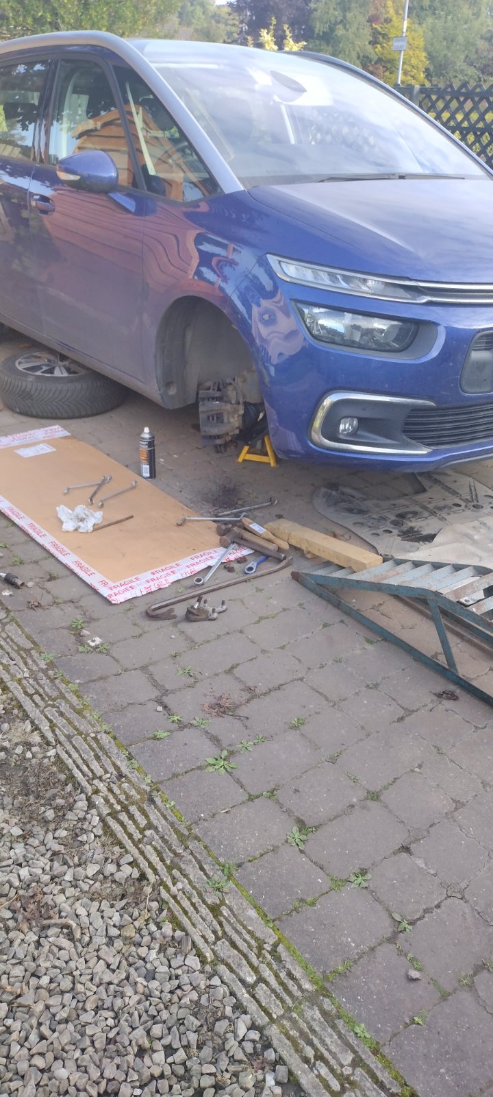

Further checking of the C4 reveals the play is actually in the ball joint, looks easy enough to change out, so will get one on order. Job for the weekend.

New joint fitted. Easy enough, but on this car you have to remove the undertray first as it covers the entire subframe, so no where to put an axle stand otherwise, and there's no room for any sockets on the joint, so they have to come out a flat at a time with ring spanners. Top nut on the taper is 21mm, a size I don't have, but my inherited 7/16 Whit spanner is a perfect fit

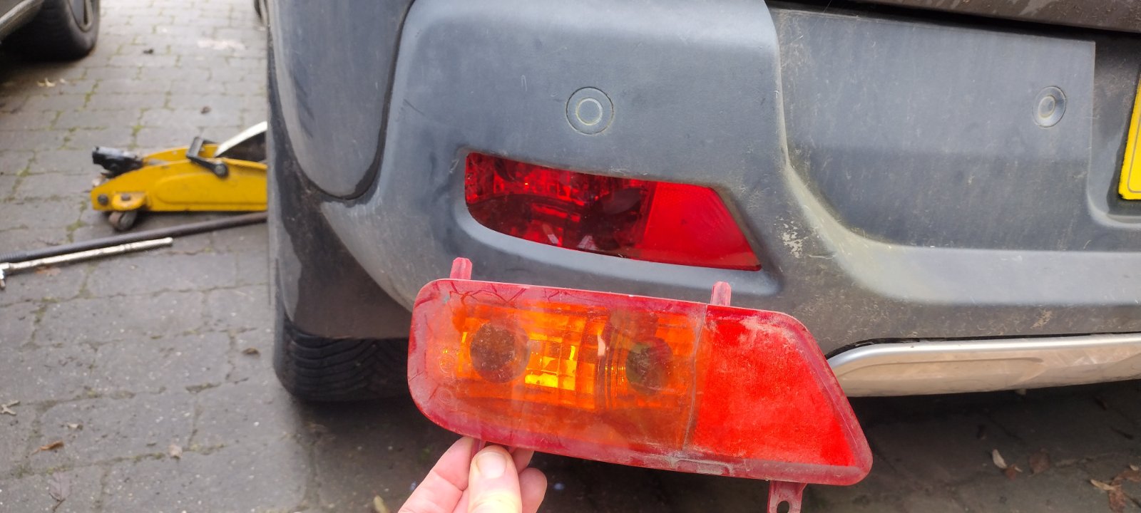

Pre MOT check on the 3008 showed the NS fog light was distinctly orange. I thought about ignoring it since it's not a required light - and taking the bulb out if the tester complained. However, easy enough to get out (2 T20s into plastic that were not rusted to oblivion) and a new one was procured for £13, so it got changed out. As a bonus, the bracket was loose - originally had a plastic pin / rivet to the bumper, but the head was gone - but was easily fixed with a dose of hot melt glue. Also found that the chassis rail along side the silencer was looking pretty crusty, so cleaned up and rust converter added, will get some paint on it later. Stitch in time to save having to weld it in a couple of years!

Shocked a lens should fade like that these days. I thought it was only old Soviet-era Iron Curtain cars that suffered like that...
Maybe Citroen bought the recipe from them!
If push came to shove, you could always have used a red bulb - as my Picasso uses...

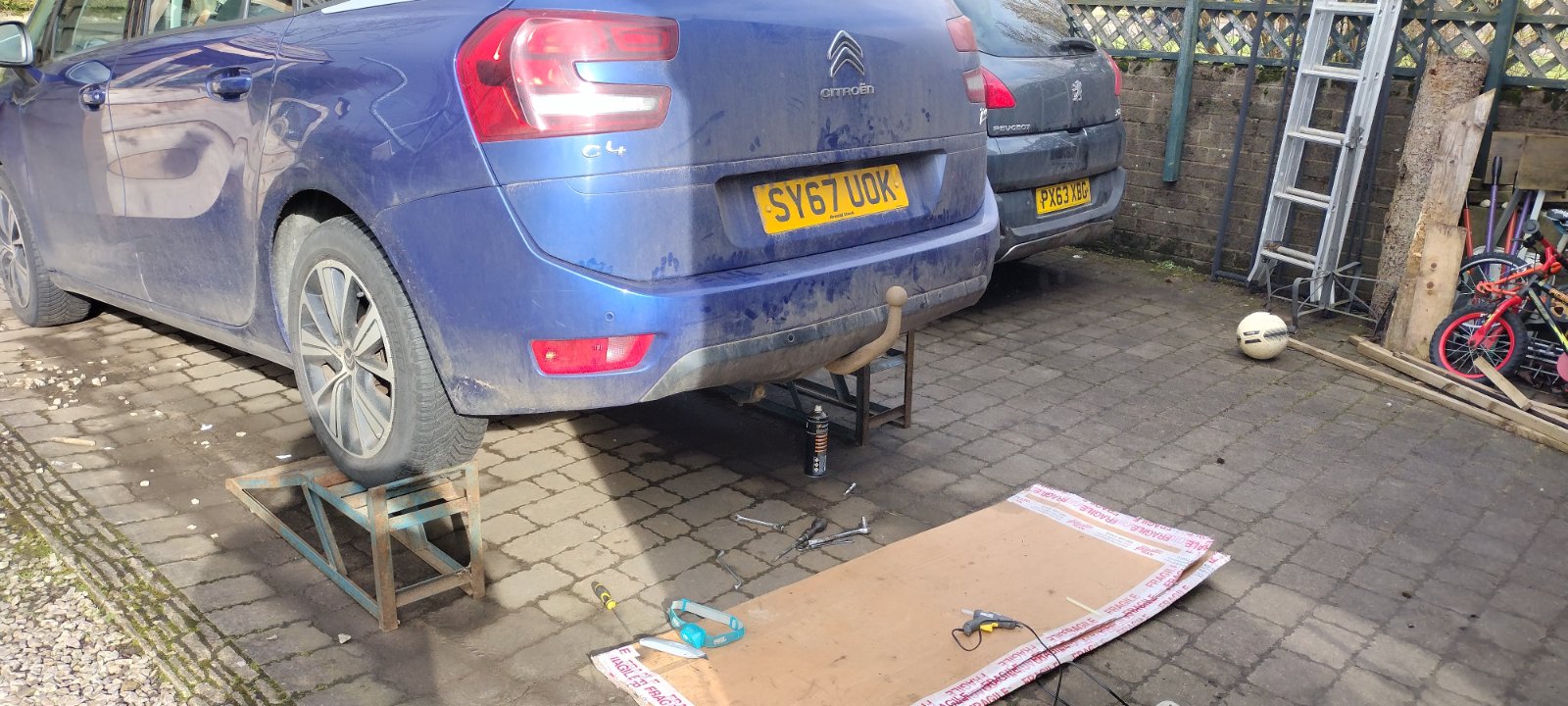

Then as I was putting the jack away Mrs arrives home and says the rear parking sensors are not working on the Picasso - a quick look shows the centre left sensor is absent.... hmm! Had a look about, and then underneath and I see the exhaust is all crooked - so my initial thought is that it has been hit and knocked the sensor out, and twisted the exhaust, but there is no witness mark on the bumper. Get it on the ramps and get under the middle, to find that in fact the flange on the end of the rear exhaust section has rotted off - pretty lucky it didn't just drop onto the road I think! I thought it was SS - the very back part is, and it's all one piece from the back of the DPF to the tailpipe - but no, it's mild steel here. Replacement is in 2 parts, I guess you can't get it out in one piece - so you can just replace the middle section - however this has the NOx sensor in, which are notoriously difficult to remove without ruining the threads, so I guess we're in for a new pipe and NOx sensor.... Not sure I can bothered fighting with it on the floor! Have put a splint on over the joint with a couple of jubilee clips for now to stop it dropping off... So what's the connection with the parking sensor, well.... I got a bit of access (towbar blocks the way!) and I could see that there was a plastic bracket / clip that is supposed to hold the sensor in place, and which looks to be heat sensitive, and plastic welded to the bumper section. It looks to me like the exhaust failing has caused it to tip round, and instead of blowing on the floor, it has been blowing up inside the bumper, and there has been enough heat (probably from a DPF regen) to melt the clip, but leave the sensor intact! Managed to cut away enough of the old clip to re-position the sensor and then glue it back in with hot melt glue, so that at least is fixed.
3008 has had a light rattle from the NSF since the MOT - I remember first hearing it very soon after and thinking perhaps the bonnet stay was loose (i.e. that sort of light rattle), but it wasn't, and I couldn't find anything else. Still there, and I finally got around to jacking it up today to have a look, and found, rather to my surprise, that the spring is broken! About 7/8 of the bottom coil has parted company and is sitting loose in the cup, there isn't enough gap to get it out past the strut, so that is what's rattling. So the tester either missed it on the test (seems unlikely) or it broke at the end of the test, or immediately afterwards. This was the spring I replaced only about 3 years (and not that many miles) ago.... was a KYB so not a no brand cheapy, but it hasn't lasted long!

Sounds like a great day of improvisation there Richard!! Well done and good luck with the replacement Nox sensor fitting

Gosh Richard! That was all a bit of fun...
I've heard that NOx Sensors can be the very devil to remove. Any reason why? Or is it just normal exhaust corrosion that does for it?
