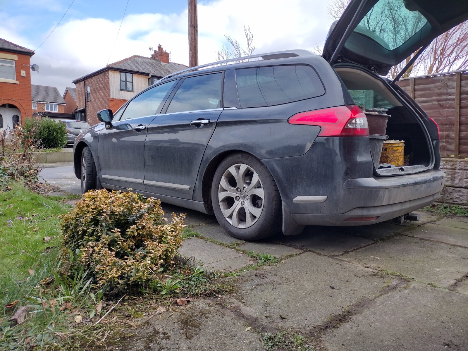

Thread title comes from the last few photos that have been on the above thread, and perhaps unsurprisingly from what it looked like this morning:
Slightly squished rear end
Because
A tad full
A tad full
Once engine on, Economy Mode Active cancelled and suspension pump heaved it back up to normal running height. It does make me think that a normal car, sprung as softly as the C5 would have to creep along carefully on its bump stops to the tip, whereas the C5 hides the load beautifully. :)

Always found that mine, estate and saloon, felt better when loaded to the gills, and for a few days after too.

myglaren wrote: 26 Feb 2023, 19:12 Always found that mine, estate and saloon, felt better when loaded to the gills, and for a few days after too.
Interesting, not just my imagination then! (Thought the same, thought was wishful thinking!) I'm currently wondering if I have spheres that are down on pressure as it's not quite the magic carpet at present.

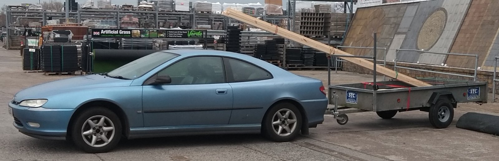

Ok, next, brief description of the Coupe:
Earning it's keep
Earning it's keep
2000 "W" Peugeot 406 Coupe SE. Base 2.0 16 valve EW10J4 petrol. Was AL4 - 4 ** (3 speed in my ownership!) speed automatic when bought, now with 5 speed BE4 cable change manual gearbox.
Was daily driver for about 3 years, off the road now as think engine is getting rather tired (169,000 miles covered)
Black leather interior, Ariane blue paint. Body bit tired, leading edge of bonnet bubbling (and worse viewed from underneath) and the common Coupe failure point: bottom of the rear quarter panels both heavy surface rust.
Engine has ok compression values if you allow each to level out, but it takes a good few revolutions to do so (about a dozen before gauge stops moving) either valves or piston rings or both aren't sealing very well.
Bought a newer EW10A from a 307 and intend to fit that. £80! So not a hard decision!

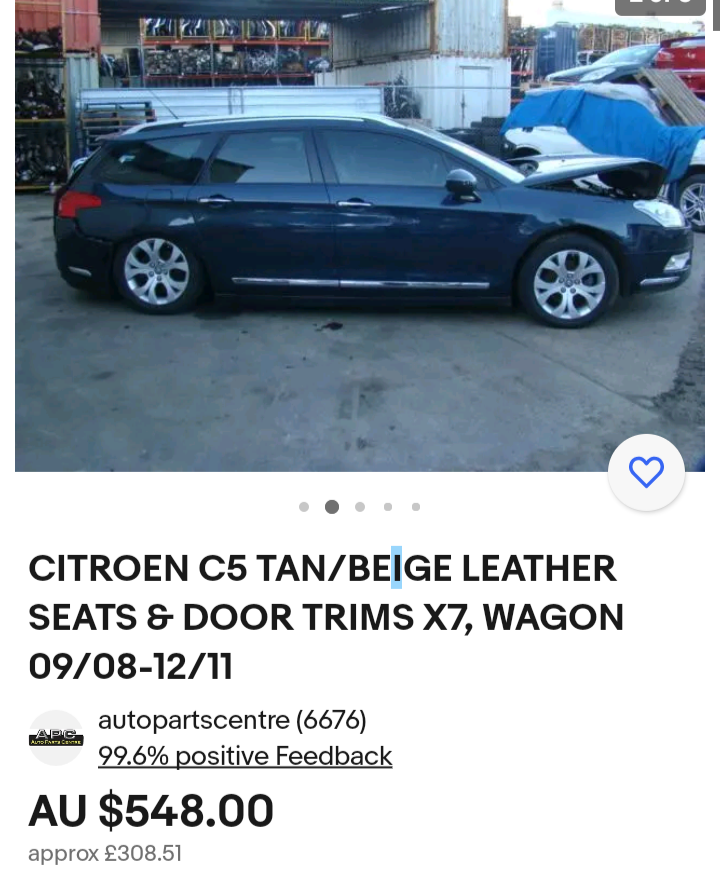

If I could have found an Abyss Blue one I'd have jumped at it (not a fan of the monochrome car colours generally black, white, grey, silver, not my choice) but does not seem like anyone bought one! (Google images brought up an X7 tourer in a scrapyard, in Australia in that shade!! Looked very much like my opening image here but in a preferable colour!)

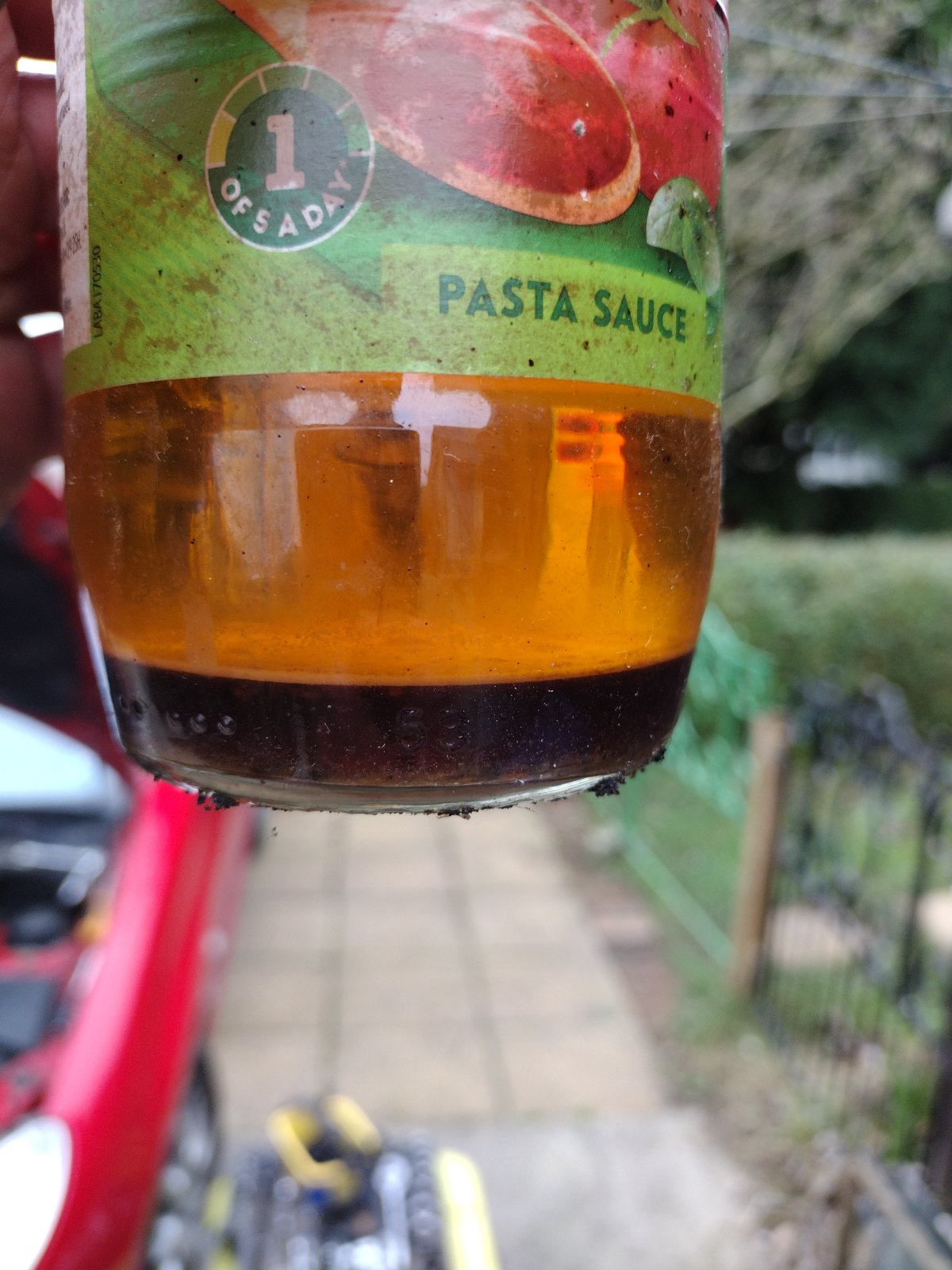

Interestingly, (to me at least / to me alone!!) This is some diesel I drained off during my C5 issues. It's sat in a jar in the garage for a few months (lid on the jar, kept closed)
There's a significant layer of something settled out of it!
That ain't pasta sauce
