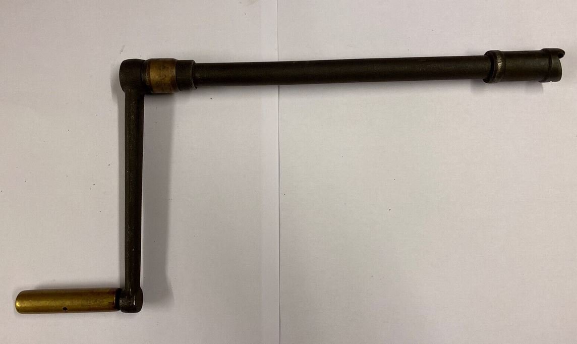

One of these would be more reliable :-D
Starting 'andle
Starting 'andle

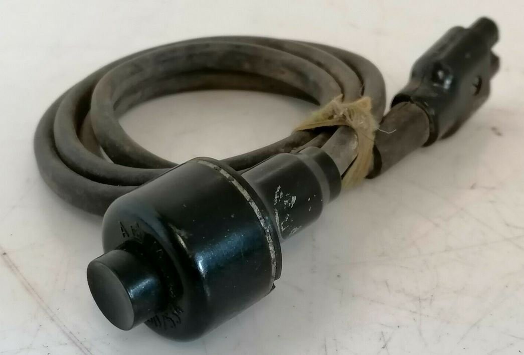

If it's British engineering you want, Neil, then I think you need to get creative.
How's about repurposing a bomb release button from a Lancaster.....
Lancaster bomb release button - ebay
https://www.ebay.co.uk/itm/195488595864

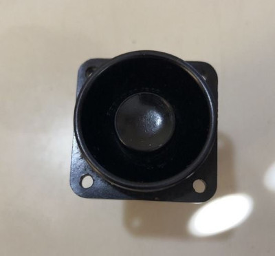

Or maybe a "WWII Air Ministry Starter Button Stores Ref: 5c/898 Spitfire,Hurricane,Lancaster"
WW2 Starter Button - ebay
https://www.ebay.co.uk/itm/115602786403
