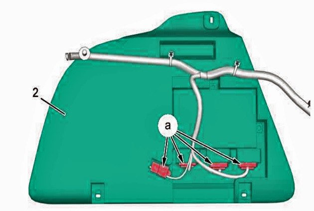

If you have the Connected Nav system, then the amplifier is incorporated into the loudspeaker unit (bass box) which is located in the rear right-hand side of the inner boot area. There should be 3 bolts (the top bot is covered). Once carefully removed, the connections are on the inner side, so be careful not to pull it away too much before unclipping the connections.
This is the other side showing the connections:

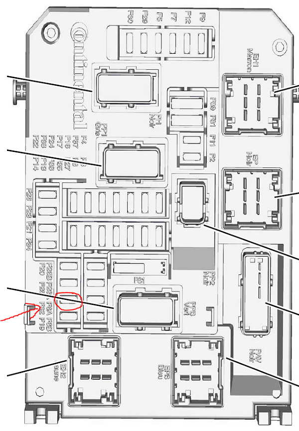

In the BSI, Fuse F32 (amplifier - radio - telematics - head-up display screen), which I have circled in red below:

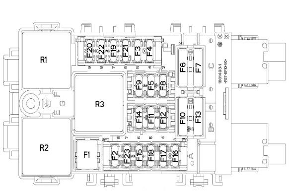

In the Cabin Fuse box (BFH3, Fuse F12) below:

On the older equipment with RT6 unit and amplifier, there were a couple of fuse locations:
