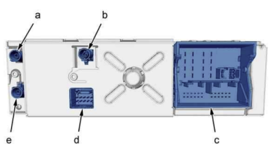

The LVDS is the cable that connects the colour MFD to the rear of the Head Unit.
Shown here as 'd' in the diagram at the back of the MyWay (RNEG):

Yes, do you know what is the connector type?
x 6957
Re: RNEG LVDS connectors type
Like this:
