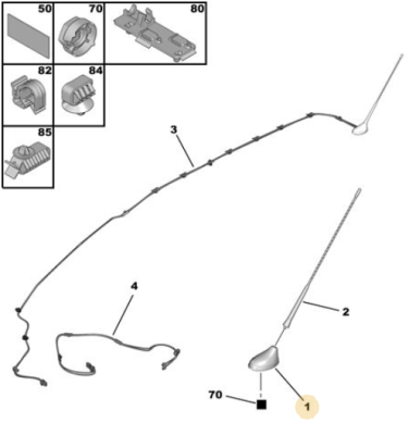

Ok, so if you need a new aerial, it is item (1), part number: 9810547980, £72.97 inc. VAT from Citroen
Remember you only need a test aerial with a FAKRA connection. A cheap ebay one will do. Plug it into the GPS port shown at 'B' in the diagram below. Then crucially, you can't just start the car and expect it to work. Place the aerial on the dash temporarily, but you must physically drive for at least 10 minutes for the system to lock onto the satellites and geolocate itself. Idling stationary won't cut it. If you get some satellites, then you know it's the aerial.

Yes, if it's the aerial base you need, the part number and price is as shown above my diagram. You can only order these from your dealer direct.
There is of course, still the possibility that the wiring may be compromised along the way to the aerial or the rear connection at the back of the head unit - so worth a check of the obvious, like ensuring the FAKRA connection at the back of the unit wasn't loose.
The actual aerial loom antenna that screws into the base is available too - these can get damaged in car washes and the like.
Part for item (2) 9810589480, £37.09
