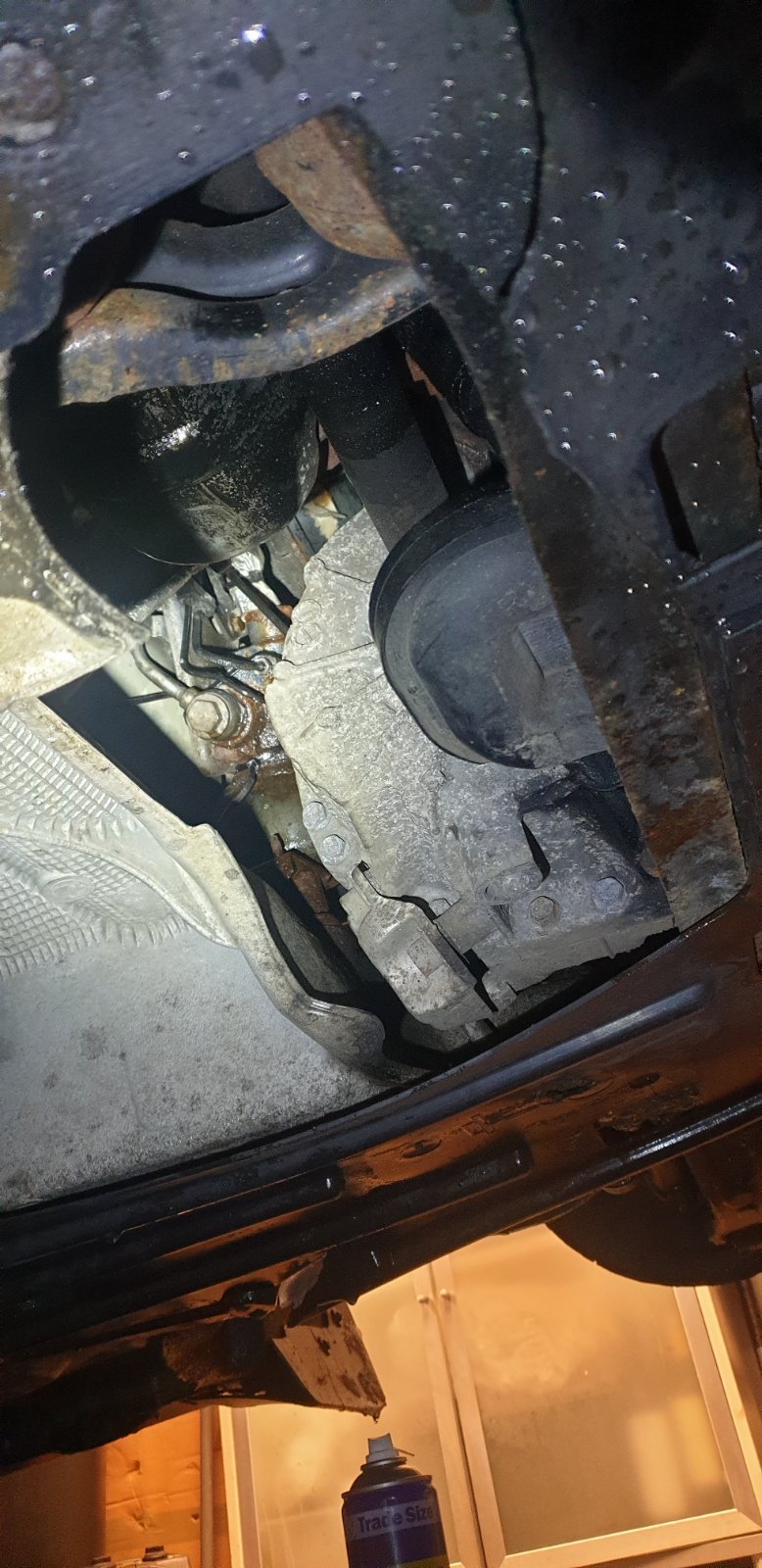

Back to the questing of lowering the front subframe. I looked at some threads about lowering it and it SOUNDS straightforward. My main concern is the big mounting bolt I can see roughly mid way from front to back of the subframe. It looks large and rusty at the top. And I'm not certain what it screws into (large captive nut/ weldnut?) And I'm concerned this will break or the item it screws into will break.
Also, how high must the car be raised and how low does the subframe actually lower? I can only raise the car as high as driving up on ramps, suspension raised and axle stands.
Graeme M

The sub frame mounting bolts are screw into either a captive nut or welded nut but if never undone the will break or be broken.
I got my off reasonably well first I soaked them well with plusgas or similar then used I think a 21mm ring spanner on the nut with a 24mm socket,breaker bar extended with a scaffolding pole to loosen them off. My impact wrench the first time couldn't budge them.
I hope this helps.
Kenny

Hi Kenny thanks, hm I have a 6' breaker bar and 22mm spanner available. But if the bolt breaks....
I was also concerned that if the subframe is lowered it might allow the physical removal of the front suspension regulator but the lowered subframe might be in the place I need to lie to actually undo things....
Might be easier to take out the engine 🤣
Graeme M

The bolts are quite robust so I think they will be okay. Make sure the spanner is the exact size. The bolts thread are mostly protected by the mounting bushes in the sub frame.
I suspect you will have to remove the sub frame from the car to get the regulator. Good luck.

I wonder about the subframe having to come all the way off. I think because I can remove the pipes from the regulator then it's simply the physical space to get it out that's the issue. I had checked and the lot will not come out any of the available spaces. If I'm doing the subframe method I'm going to have to really concentrate on the order of what gets loosened before the subframe. Does the steering rack remain bolted on the subframe for this?
this view is the largest access space avail. Even a sphere on its own can't fit through this.. I've tried

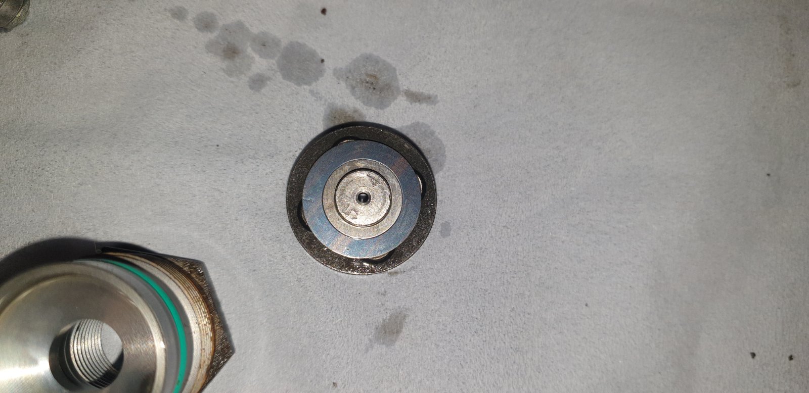

Few details about the front regulator:
As it arrived, sphere was incredibly tight to remove
Pipe unions and accumulator flange
Pipes off to look at the ends - can anyone form the 3.5 pipe end?
Front hydractive 3+ damper valve  -much like Hydractive 2
Damper valve
Damper valve
Best measurement of the damper hole out of interest
The C5 Front H3+ firmness regulator damper center hole seems to be about 1.8mm, the rivet is etched with 5 - 4. It looked visibly larger than 1.8mm but could have been an illusion. Compared to the 1.3, 1.25 ( if I recall ) on the Xantia Hydractive rear and front firmness regulators this would be a lot different. I think the Xantia ones were etched with '2 - 6'.
