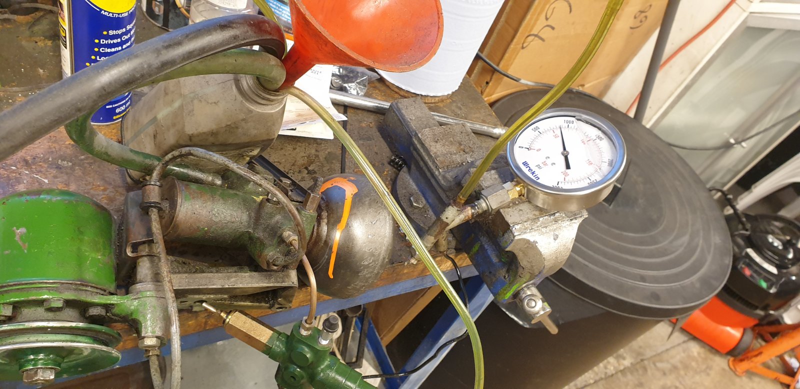

I also plan to make some effort to protect it from rusting so badly. The front unit came with a front accumulator sphere attached and after removal (epically tight light the rears) I chucked it on the sphere tester. It is a sphere marked as 2008 and 75 bar and it measured 60 bar after 13 years. Actually not bad.
front 2008 accumulator 60b from 75b
I now wonder if the front accumulator that's actually on the car - and will also be from 2008 - might actually be about 60 bar too and that got me thinking that I could simply have fitted the two of these 60 bar accumulators to the rear. They're a bit high in pressure but not excessively.
Anyway, re the supplied rear spheres, I obviously didn't fit them and resigned myself to refitting the old rusty pair that are down to 40 bar. I did however work out that fitting the old front sphere that came with the regulator would actually render the rear circuit as having nearly the right amount of gas as two 52 bar rears. A 60 bar sphere and a 40 bar one (original old rusty rear) have a P.V value of 37000 combined and comparing that to the correct 2x 52 bar spheres of 38480 is very close so I decided to stick it on and see and it actually works very well. Remember the two rear center spheres are connected directly together to basically make one bigger sphere of 52 bar. The 60 and 40 combine to make a similar gas volume. You couldn't do that trick on the corner spheres of any Citroen as they need to be closely matched or you'd get uneven suspension at the same axle. But the unique arrangement of the C5 X7 and C6 with the double accumulator makes this possible. I still want to have the correct pair of 52 bar units in place but this will suffice for now. I'm just back from a lengthened route home with the C5 and it rode beautifully. I was also mistaken in thinking the rear electrovalve was faulty.

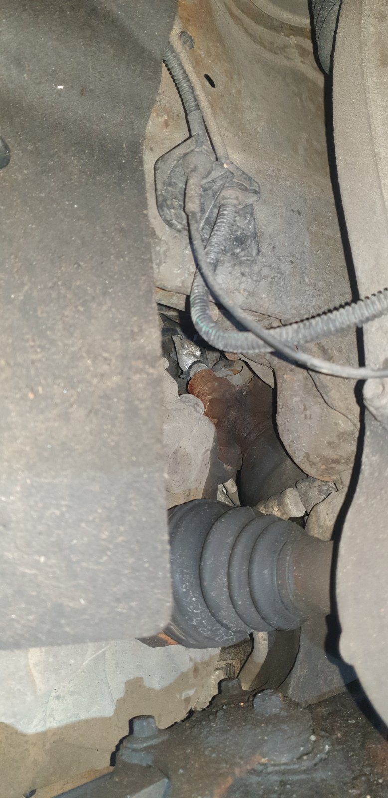

Attempt and FAIL at removing the front suspension accumulator. It is absolutely inaccessible! Has anyone tried this before? You can see it (touch it actually) via the N/S wheel arch with the wheel removed but I could not get my chain wrench on it - not enough space around it: you have a steering rack pipe in the way, the track rod in the way and the subframe in the way. From underneath behind the engine you can see it easily but it's too far a reach to get anything on it - if they'd mounted it 90deg differently you could get a chain wrench on it and use a 3/4" extension to -maybe- crack it off. Tried the medieval chisel method and that would have worked using a very long chisel and lump hammer except the sphere and firmness regulator are fixed to their bracket with 3 flexible mountings so any shock the hammer and chisel could deliver are absorbed by these rubberised mountings...
You can't reach it from above because the brake vacuum can is in the way, as is the electronics box and oh, yes the engine too. It is completely stuffed in the corner low down and inaccessible. Contrary to the C6 whose front accumulator is simply found behind the wheel arch shield on the other side I believe.
I even got out my old, small chain wrench and I did manage to get that on it via the wheel arch with the steering at full lock to move the track rod more out the way and it might even have worked if it hadn't broken its chain! My usual chain wrench is an HGV type and it is just too bulky to fit.
I've been looking at the multitude of chain and oil filter wrenches and the only type that looks like they might do the job are those three- legged self adjusting type because they have the central location for the 3/4" drive so access from the wheel arch might work and might be slim enough to fit if I perhaps disconnect the tie rod end but the largest I have found so far is 120mm and that's about the limit because the grey spheres are about 120mm diameter. There is no access for any of the giant pipe gripper type wrenches so that's not going to work and a hefty strap wrench might work but I doubt any are strong enough for this.
It actually could be done if either the steering rack or the engine were removed... not even joking. Has anyone done this job?
Here's an idea of how tucked away it is, this is the front view even if you could get something on it there's no swing room

Ah! thanks but the trouble is that the DIY tool needs space to swing the square section lever and you just can't do that on the X7. The only way I can see something working is if it's a type that kind of goes straight over the sphere 'crown' and has it's square drive in its center as that way it can be possibly done from the LH wheel arch. The kind of 3 prong oil filter wrenches seem about right but I just don't know if they can take this likely mega torque ...

The front subframe needs dropping to get at the centre sphere.
Recently had this job done on my C5, when all the spheres were replaced. Sphere was at 30b pressure instead of 75b; ride quality noticeably improved with the new sphere.
I was invoiced 2 hours workshop time. I suspect it would have taken longer had all the nuts/bolts not undone easily (subframe had been out not so long ago to replace anti roll bars).
Good luck!

Factory workshop manual says that the subframe must be removed, then the sphere and its bracket can be removed as one once you've done all the other unplumbing and disconnecting. You might find that you can remove the sphere without removing the mounting bracket first though.

Thanks guys, my word that is actually insane. Subframe must be removed/lowered!
I mean the actual removal of the sphere by hand is an elbow deep operation but I've done worse - once it's cracked there's enough room to remove it. It is simply the loosening that is the problem.

Well, consider that the C5 spheres have a far longer lifespan than those on the Xantia, for example, and you could understand why Citroen haven't thought ease of access to be a major consideration. Still, having to drop the subframe is still a pain in the proverbial!
