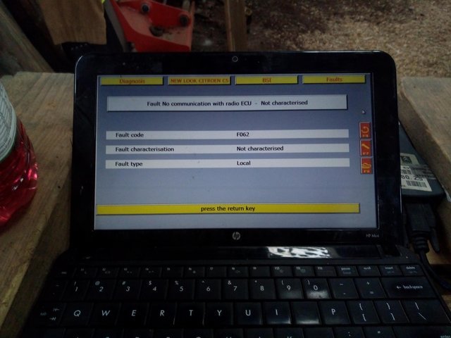

Another try but same result .. cant communicate with Radio ECU (or multiscreen ECU) so can't stop the beeping.. any thoughts marc on the next possible strategy for Snoopy?

Right, it's taken me a while to re-read back on this thread to find out what the objective was
So the F062 error is a BSI communication error with the Radio. and can't as, we know, communicate with it.
So when you hook up the Lexia, go into the repair menu and look instead for the 'Multifunction Screen' option, as I think on these it is the screen ECU that does the controlling of the Head Unit.

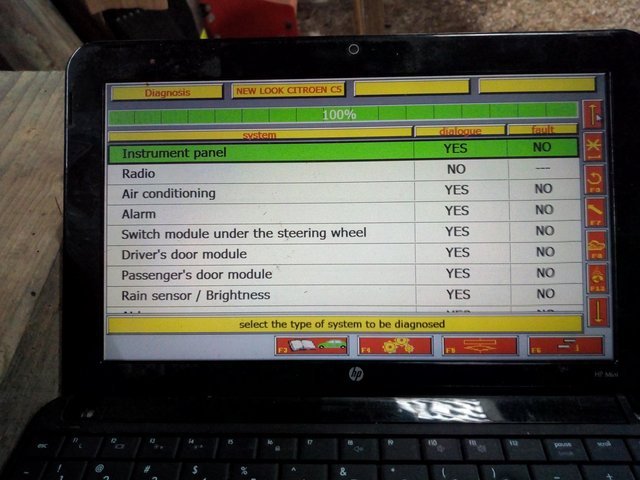

still no luck everyone
the top menu has :
Diagnosis
Downloading
Replacement parts
PDI
Personalised Maintenance
Battery charge status
there is no repair menu.
However, in diagnosis it shows what the pics in my previous post shows.
We cant communicate with:
Radio
MF screen
Hands free phone
so we cant seem to do anything further without accessing those menus (in particular the MF screen)
Is the BSI blocking access at this point? has it got a fault that is not allowing comms with any/all of those 3 items above?
Radio
MF screen
Hands free phone
Looking back at the pics of the diagnosis menu from last week, one thing I have noticed.. the 'hands free telephone' option is now at the bottom of the list after 'power steering' (with no comms)
