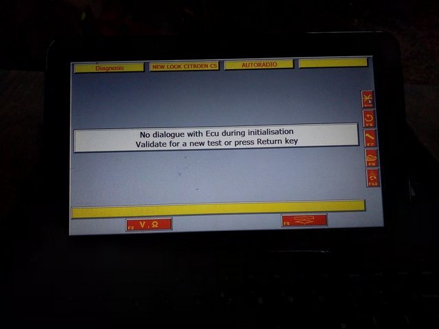

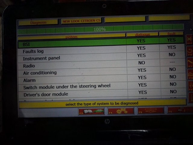

Another try but same result :( .. cant communicate with Radio ECU (or multiscreen ECU) so can't stop the beeping.. any thoughts marc on the next possible strategy for Snoopy?

I do NOT know if this information will help, so be careful with it. I am running v7.15 of DiagBox, and it could not 'see' the radio OR the multifunction screen. However, when I went through the Telematics option it could 'see' and communicate with the radio (which looks like the system in the first post). I was then able to add the CD Changer to it, although I cannot recall the options I chose to do so. DiagBox clearly told me to only make changes to the Telematics system with the engine running (as if the car went into economy mode while changes were being made to the Telematics system could write it off). As my car and the Telematics system already 'knew' each other I was not getting any beeping.

Just another thought in addition to the last posts, I don’t know if it’s relevant but we tried refitting my old head unit ( still stuck on ’ insert upgrade CD’ ) and Lexia couldn’t communicate with that either.
Lexia is also showing a BSI fault - we tried doing what I understand is a BSI reset procedure (disconnect battery for three minutes, switch on side lights etc ) but this didn’t make any difference. In doing this we noticed that both my front sidelights weren’t working. This is just the bulbs but I don’t know if that current change would make any difference. I haven’t changed the bulbs yet as I have started on one of them and spotted that who ever changed it last, possibly didn’t push it fully in which has caused melting of the plastic in the surround so it won’t go back in properly - it’s looking more like’ bumper off ‘ time.
When the BSI fault was ‘erased’ Lexia still couldn’t communicate with the radio but on checking, the BSI fault had immediately returned.
Until jgra1 plugged in the DiagBox I wasn’t aware of the BSI fault as everything else works perfectly - is it possible that a BSI fault could cause the problems that I have with one or both head units ?

Right, it's taken me a while to re-read back on this thread to find out what the objective was :wink:
So the F062 error is a BSI communication error with the Radio. and can't as, we know, communicate with it.
So when you hook up the Lexia, go into the repair menu and look instead for the 'Multifunction Screen' option, as I think on these it is the screen ECU that does the controlling of the Head Unit.
Under the Multi-function screen, you should then see an option for RT3.
Select this and it will then attempt to communicate with the unit.
When it does, you should see a further list of options including configuring of the VIN.
So DON'T go into the AUTORADIO menu - stick to the MULTIFUNCTION SCREEN section.
I've found a video - that might help - this chap has a Fiat - which is the same as the 807 and C8 - and had the same RT3 telematics systems fitted, so ignore this fact. He is using Peugeot Planet 2000 (the Peugeot equivalent of Lexia. You just use Lexia when you get the choice of SCANTOOL or LEXIA.
Although the menus are in French, if you watch carefully, it may help you work out the correct options that should be similar on the Lexia and later, how to code the VIN in.

However, in diagnosis it shows what the pics in my previous post shows.
We cant communicate with:
Radio
MF screen
Hands free phone
so we cant seem to do anything further without accessing those menus (in particular the MF screen)
Is the BSI blocking access at this point? has it got a fault that is not allowing comms with any/all of those 3 items above?
Looking back at the pics of the diagnosis menu from last week, one thing I have noticed.. the 'hands free telephone' option is now at the bottom of the list after 'power steering' (with no comms)
