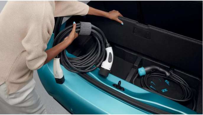

Regarding charging cables - the Zoe would have originally come with a three phase 16/32 amp Type 2 to Type 2 charging cable.
It should look something like the one below on the left:
This can be used at "slow" public chargers, or on dedicated EV home wall chargers like I have. It can also be charged on the AC connector on a rapid charger - not all modern rapid chargers have AC connectors any more (Instavolt and Ionity do not) but many do.
A "granny" charger was not supplied as standard but can be purchased for use with the Zoe to charge it through a 3 pin plug however it's not the recommended method as the Zoe doesn't charge very efficiently at very slow speeds (2kW) due to the design of its charger.
It's also not recommend to charge from a 3 pin plug long term on any EV just due to the risk of overheating the plug/socket. But it's Ok to use for a while. I charged my Ion from a 3 pin plug for about 6 months before I got a proper wall charger installed but I did keep a careful eye on the temperature of the 3 pin plug. A waterproof outdoor socket would be the best way to use a granny charger as using an extension cable has overheating risks due to the quality of many extension cables.
The Zoe granny charger looks like this but any equivalent 3rd party one with the same connectors should work:
