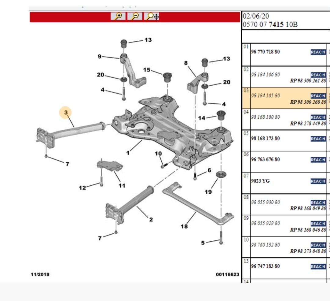

Re: C4 Picasso - engine bay shock absorbers
Would this be the same on a 66 plate grand picasso it's only done 26k. I've had a mysterious rattling noisy for over a month that nobody can find and someone else on another post mentioned these I think. I've gone underneath and both can be easily pushed up and down by hand (but not making a noise) so I thought as they both are the same it's normal? I take it that's wrong and they are supposed to be solid?
k_hickey
- Posts: 6
- Joined: 22 Jun 2021, 21:06
I was sent this from citroen of it helps anyone looks like they only sell the the whole arm for £140 each
Hi I've just spoken with Citroen and apparently these are no longer available as a separate part and must be ordered with the sub frame extension at a cost of £118 +Vat each!!
anyone know where to get some or I feel a modification coming on as I need to sort this as it makes a horrible noise when going over even little bumps
Hi, is any chance you could let me know what is a part nr 13and20 on diagram pleasedanlat1415 wrote: 29 Aug 2019, 21:44 Thanks.
That's exactly what I thought and the same part numbers I already had.
I've managed to order them for another place without any issues.
They're no longer for sale individually, as they've redesigned the full beam with the bushing integrated into it.
So instead of a £5 each part, they now cost around £100 each for the full beam with the new integrated bushes.
Your best option is to find a replacement from a scrap yard/second hand.
The only places I can find them still available today is Russian and Lithuania (old stock) - but they do not ship.
