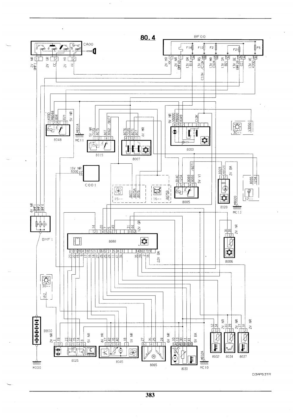

Pressing the AC button on the dash turns on the rad fans but doesn't engage the clutch. I took off the pressure switch plug there is 12V to the switch. I bridged the 2 fatter cables, nothing. There is continuity on the pressure switch corresponding to the 2 fatter cables, so I'm assuming that means the pressure switch is working correct as there is gas in the system. In any case bridging the contacts on the plugs does nothing.
Where does the feed go after the pressure switch? Does it go to a relay somewhere which then sends supply to the compressor? If so where is that relay? I can see some relays above the foot pedals but not a clue which one is which, or should I be hunting elsewhere?

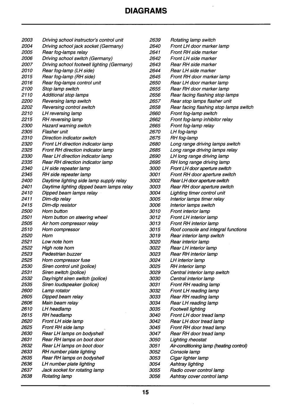

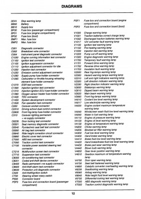

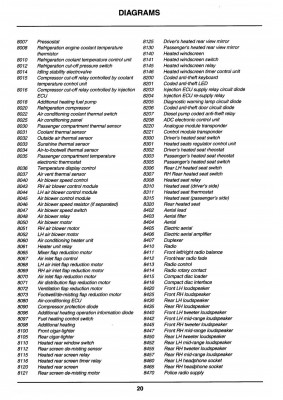

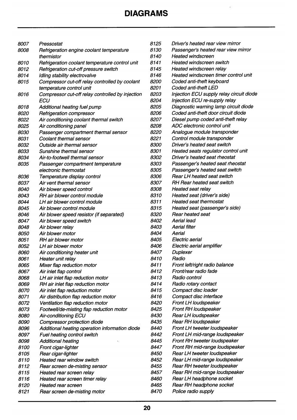

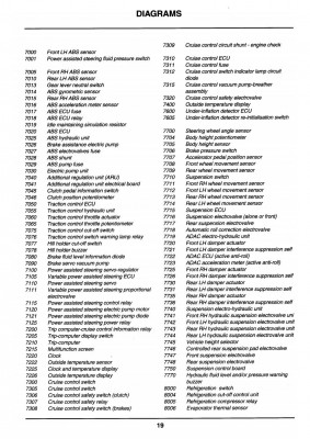

Re: Xantia A/C question

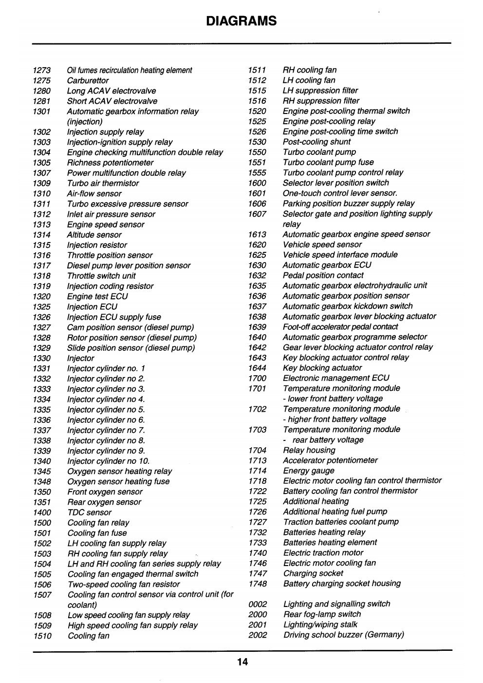

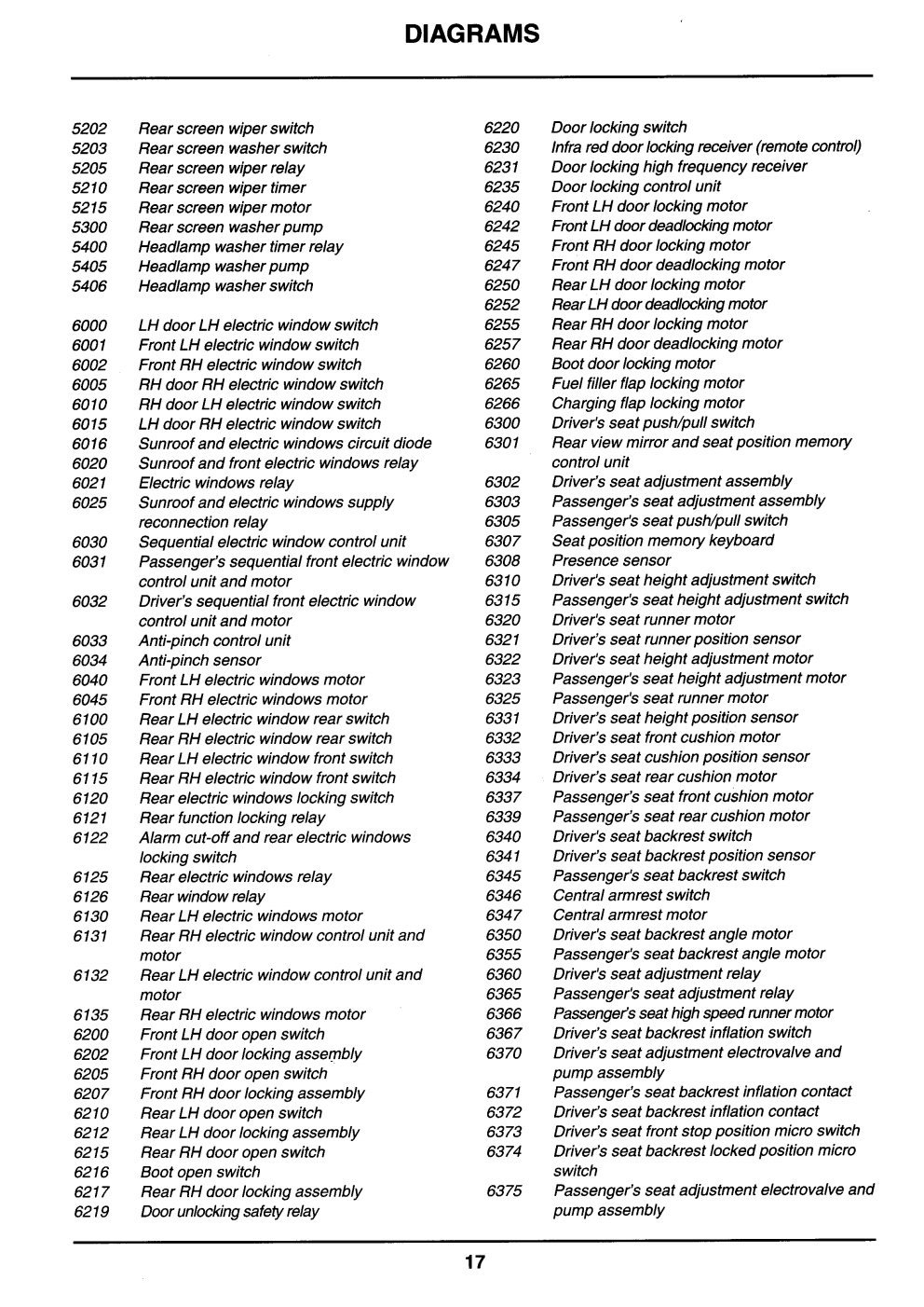

Electrical wiring detail for XANTIA 5dr saloon 1.9TD (XUD9TE, DHX)
RP 7901 = build date 17 June 1998
NB Info is for RHD car, but should be pretty much similar for LHD.
AC wiring diagram
AC wiring diagram
AC schematic
AC schematic
AC component location
Component codes p.1
Component codes p.1
Component codes p.2
Component codes p.2
Component codes p.3
Component codes p.3
Component codes p.4
Component codes p.4
Component codes p.5
Component codes p.5
Component codes p.6
Component codes p.6
Component codes p.7
Component codes p.7
Component codes p.8
Component codes p.8
Component codes p.9
Component codes p.9
Source: BRE0312 1-Feb-1998, for RP7668?

That's a great piece of info, thank you. Just another question, is there another page for the codes, seems that the AC stuff is in the 8000's and the list ends in the 6000's
If I can find the location of relays and description of what I'm looking for I should be ok to whittle it down.
x 1751
Apologies - the last three pages of codes dropped off the end. #-o
Have edited them into the post above.

Success! It was one of the contacts that had pushed through the casing under the compressor relay 8005. Bit of a faff to pull the terminal back up through the opening but I got it in the end. What was happening was that as the relay was pulled out the contact was there and visible, pushing the relay back in the socket was pushing the terminal back into the casing but no contact being made.
