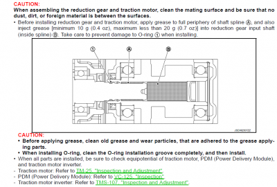

Ok can someone confirm that I'm not going crazy and that there is a mistake in the Nissan service data...
I'm looking at the interface between gearbox and motor - as far as I can see there is a splined shaft sticking out of the motor and a splined hole in the gearbox with not much more to it than that. If so I'm finding the following text and diagram very confusing as I can't work out what the diagram is ??! Is that supposed to be a cutaway of the input spline in the gearbox ? Because if so the text doesn't make sense.
It refers to an o-ring etc however there is no such o-ring in the input shaft of the gearbox - here is a picture I just took and as can clearly be seen there is a spine part way down an otherwise hollow and empty shaft, and there is one external seal around the shaft itself:
There is no o-ring and no groove for one to go into, it's just a smooth shaft apart from the splined section. So what am I missing ?

I think I saw on one of the yt videos that the O-ring sits in a groove on the motor shaft.
- Posts: 8695
- Joined: 10 Apr 2005, 17:23
- x 690
Re: Simon's new Xantia V6 and Leaf blog
That would make more sense.xantia_v6 wrote: 23 Jul 2021, 10:19 I think I saw on one of the yt videos that the ring suits in a groove on the motor shaft.
So is the diagram poorly drawn with the large white area below A actually the motor spline shaft and the dark area B to the right the void in the gearbox input shaft ??
And they're saying that as well as greasing the splines to inject 10-20g of grease into the void beyond the shaft ? Because if so the void in the gearbox shaft is clean and free of grease so unless someone washed it out thoroughly they didn't do that in the factory!
I don't have an o-ring or know a part number for one so I hope the old one will be ok...
If it just seals on the smooth section right at the entrance of the gearbox input shaft it shouldn't be too subject to damage on fitting.

If I've done this right it should start at about 8:10 and he points to the O-ring

In the diagram, the motor shaft is coming in from the left, and the left hand ball race shown is part of the motor.
