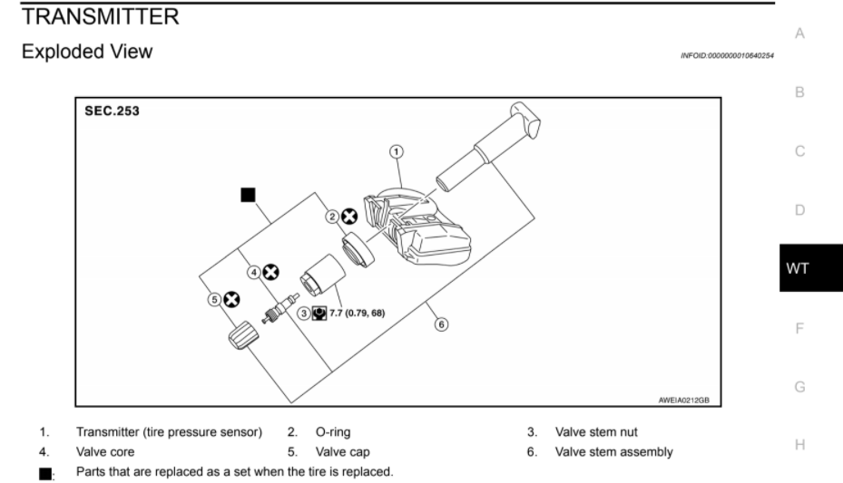

All new to me this TPMS palaver, but the tell-tale low pressure light came on telling me that the rear offside tyre had triggered the system. I suppose its function is simple....if your tyres are not at the correct specified pressure to within a tolerance, up pops the warning light and the little drawing telling you which is the offending tyre.
So to do it, each valve needs a sensor which needs to know which wheel it is on and it needs to be able to transmit temperature and pressure data via radio to a receiver inside the vehicle, and the follow on gubbins to interpret that and shove up the warnings to the driver.
Nothing catastrophic, no nail or gash in the tyre, but the tyre needs to be at 36 psi, and I realise now that my £5 foot pump with gauge from Argos is inadequate for the task. I will have to see whether the light resets itself after pumping the tyre up at one of those digital machines at a garage. If not there is a button in the car which after a few menu selections allows you to do a TPMS reset rather than having to unnecessarily get the Nissan dealer involved. The system doesn't activate until the car is travelling over 16mph so any reset requires driving the car over that speed to complete.
The official Nissan Tech Manual which Simon linked to on his blog, takes 51 pages to cover Wheels and Tyres on the Leaf https://drive.google.com/drive/folders/ ... Ao-XyZWN4Y
When I got the car, the Nissan Garage fitted 2 new rear tyres, done about 14,000 miles since. With lots of cars having these Tyre Pressure Monitoring systems now I would hope the getting new tyres fitted isn't overcomplicated and subject to potential damage to the TPMS transmitters in the process. From reading the manual above, it would appear that registration of a TPMS transmitter to a wheel location, may be a bit of a Nissan tool thing, and not a button press function on the vehicle but I could be wrong.
Has me thinking should I just get new tyres when I need them, from the Nissan garage I bought the car from rather than just let my local indy take care of my tyre needs as usual. I'll go along and have a chat. TPMS is probably part and parcel of normal day-to-day tyre fitting now, although its new to me.

How much is a tyre pressure sensor (not that I need one at the moment.) :?: Depends on the model but as of right now a Schrader Tyre Pressure Sensor for the Leaf is £43 at ECP and £33 at CarParts4less. (same part).
Plenty of easily findable video's on youtube on replacing them DIY should you wish to find a novel use for a scissor jack in breaking the tyre bead. It would appear that they tend to be non battery replaceable, but of course the ingenious on you tube find a way without a great deal of difficulty, so the whole unit doesn't necessarily have to be thrown away when the battery eventually fails.
The TPMS New ID Numbers do need to be coded/cloned to the TPMS System with their locations on the car, which sort of negates the DIY effort, unless you have an appropriate diagnostic tool/scanner so to do.
