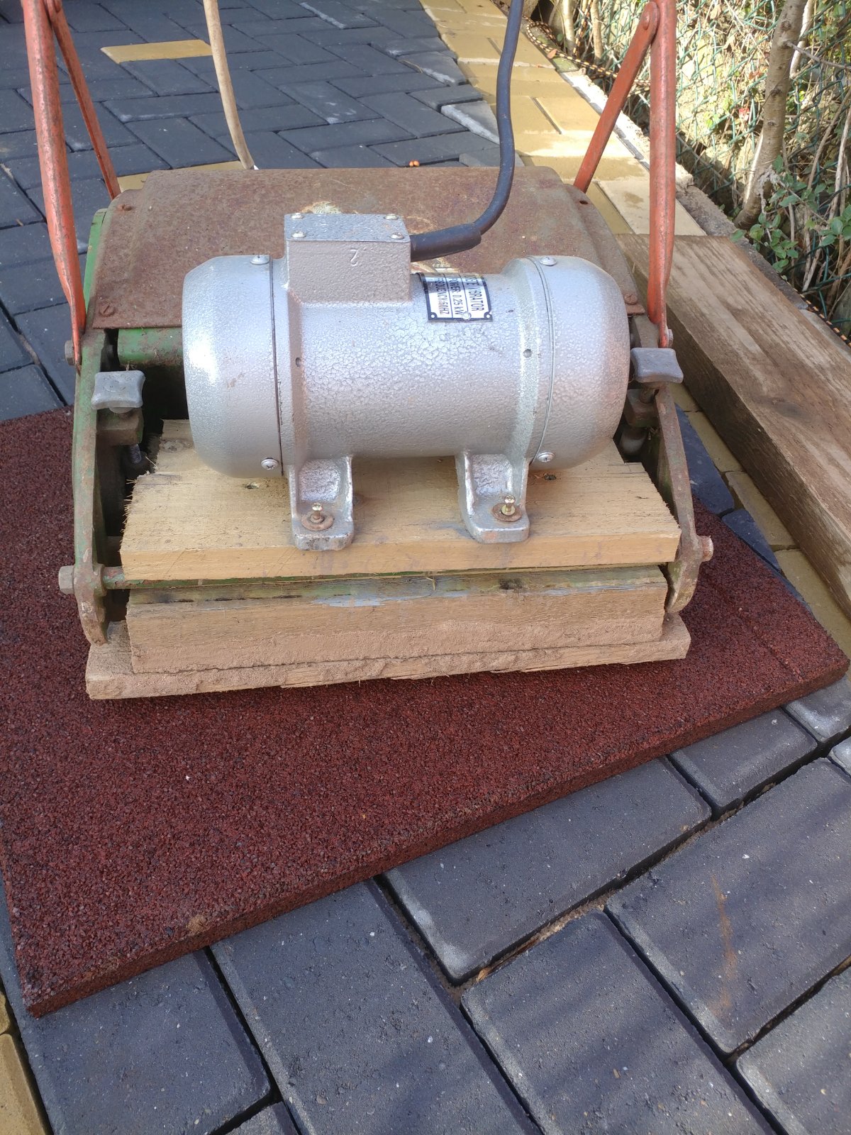

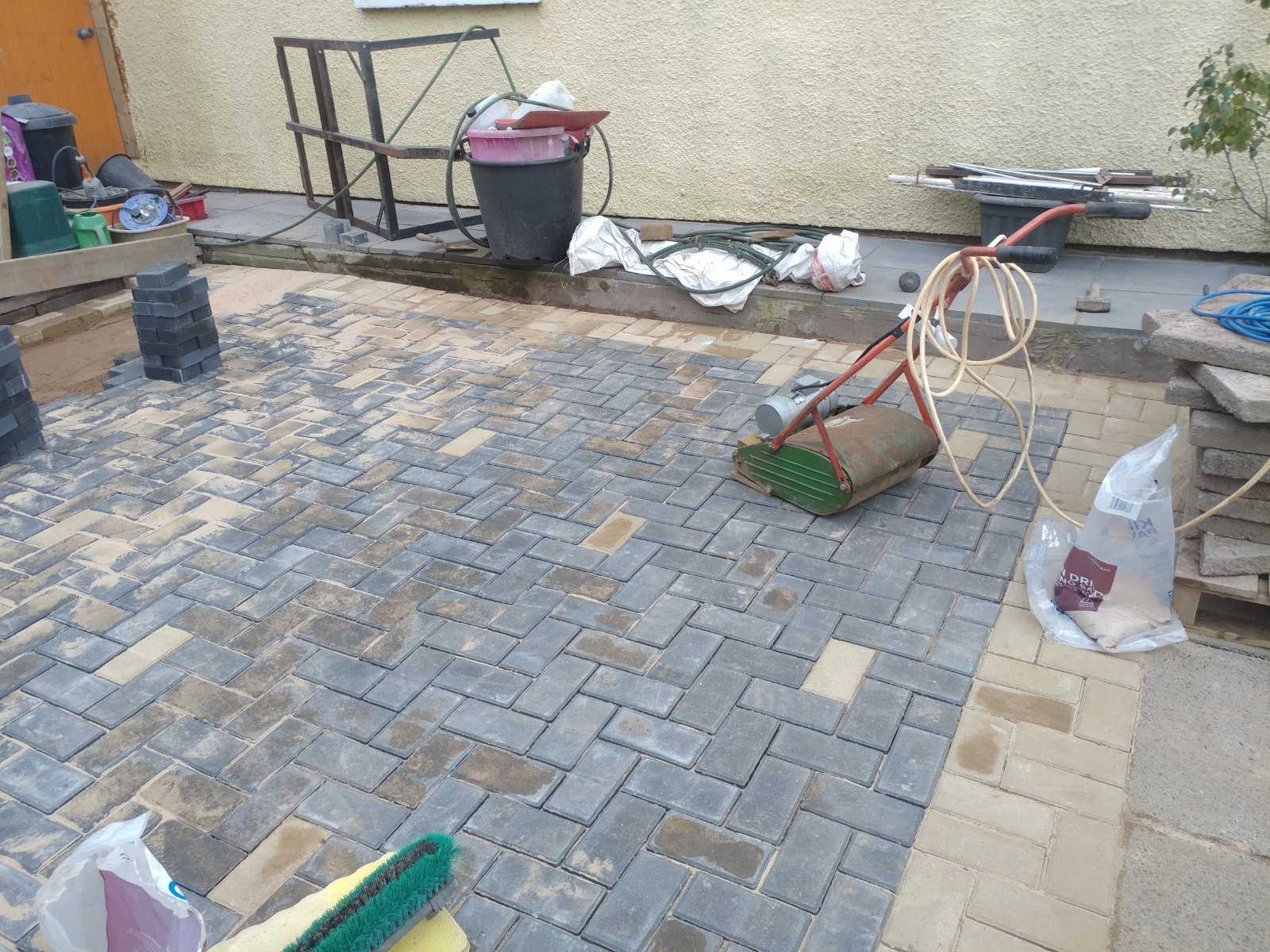

Please tell me you didn't attach something vibrating to it to bed the blocks in ?

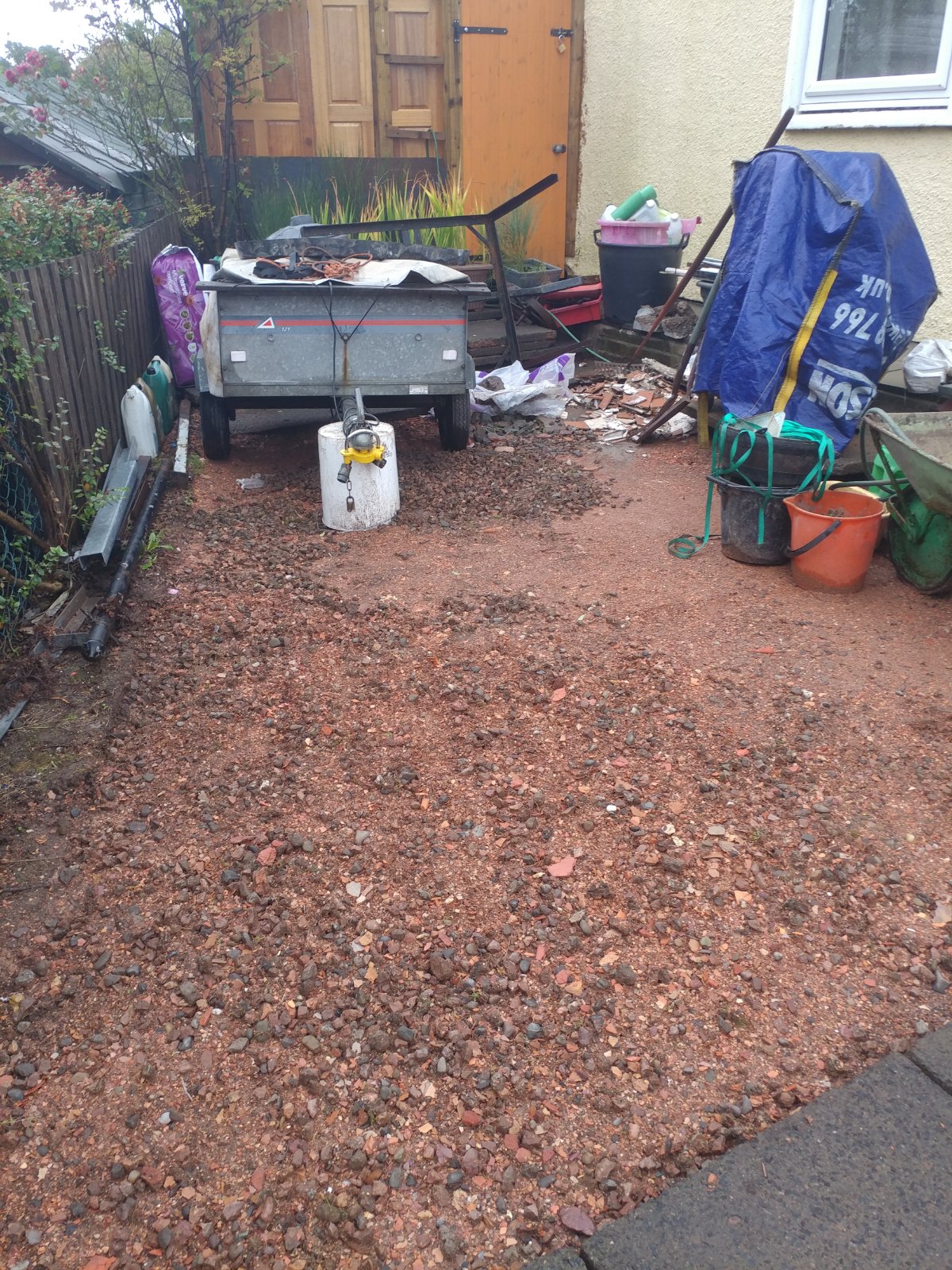

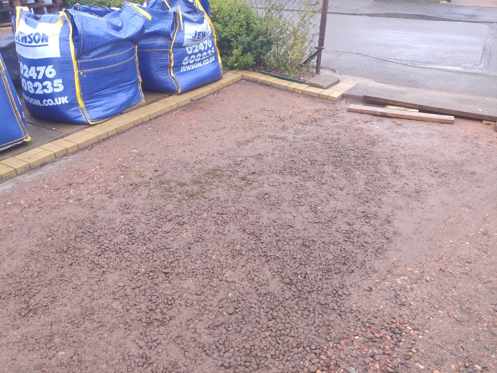

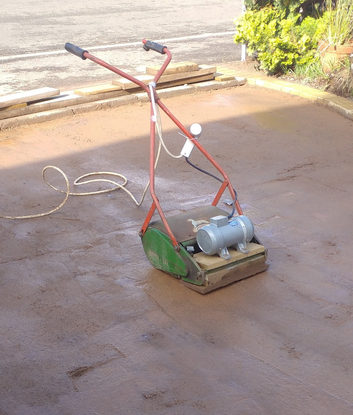

I won't bore you with the maths but this is a commercial concrete mould table vibration unit and, over the contact patch, it produces the same compaction force as a "Wacker". The wooden plate doesn't mark the blocks and it compacted sub base and blindings before the sand base dressing. Once wire brushed, it was used to vibrate in the kiln dried sand. And I still have all the bits to put it back to a lawn mower!

The roller doesn't actually get used for anything other than pushing it away when I am finished. Now, time for me to hibernate again.

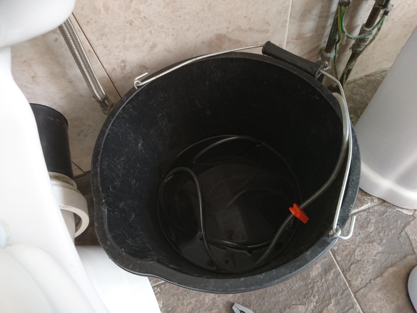

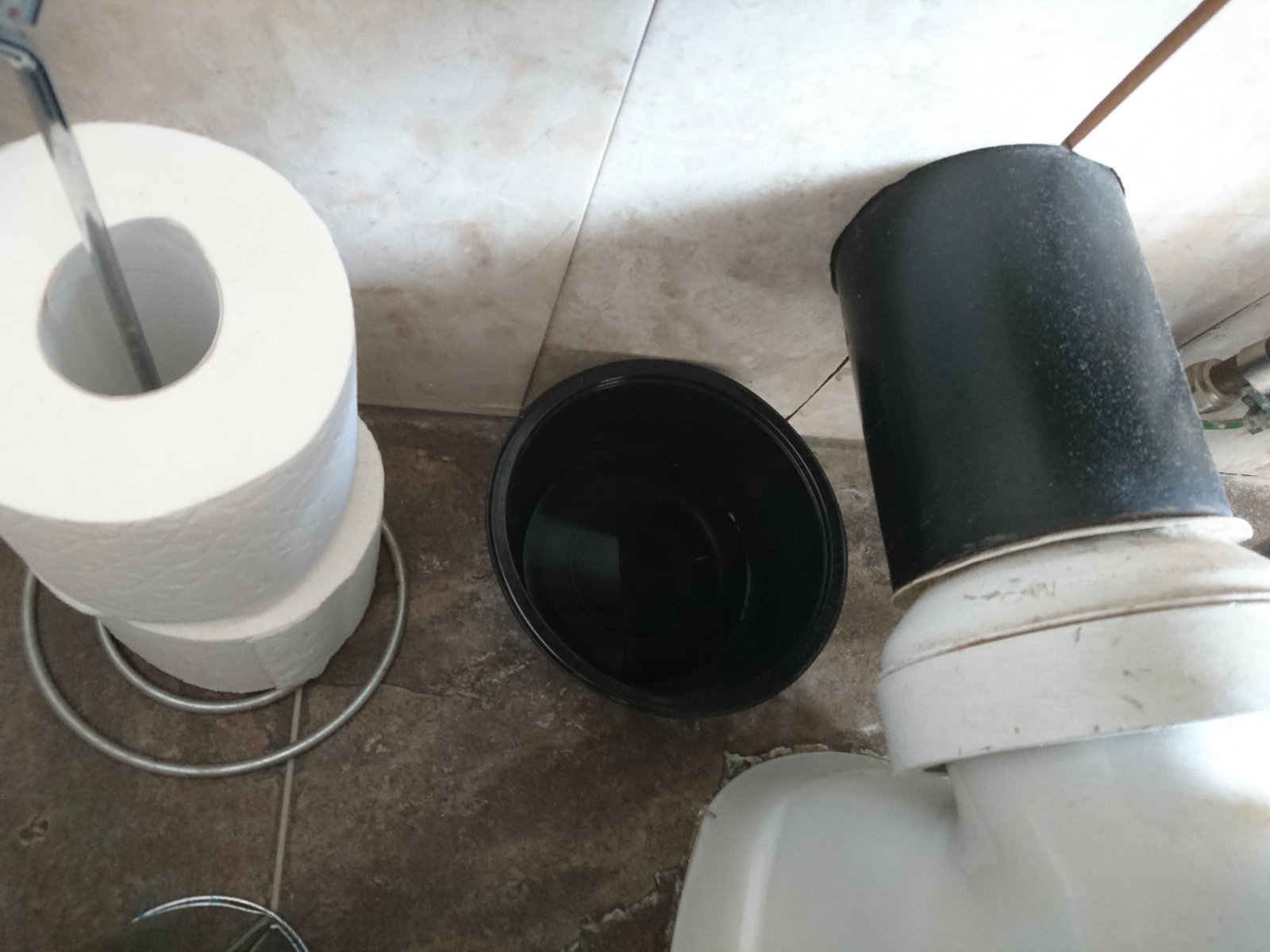

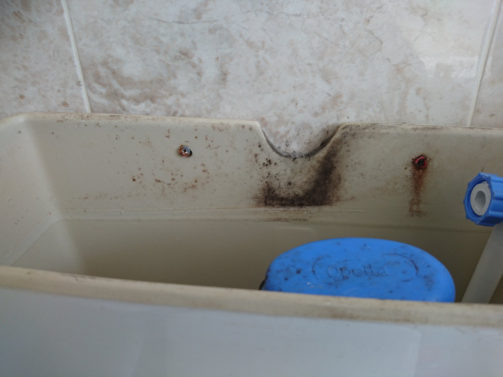

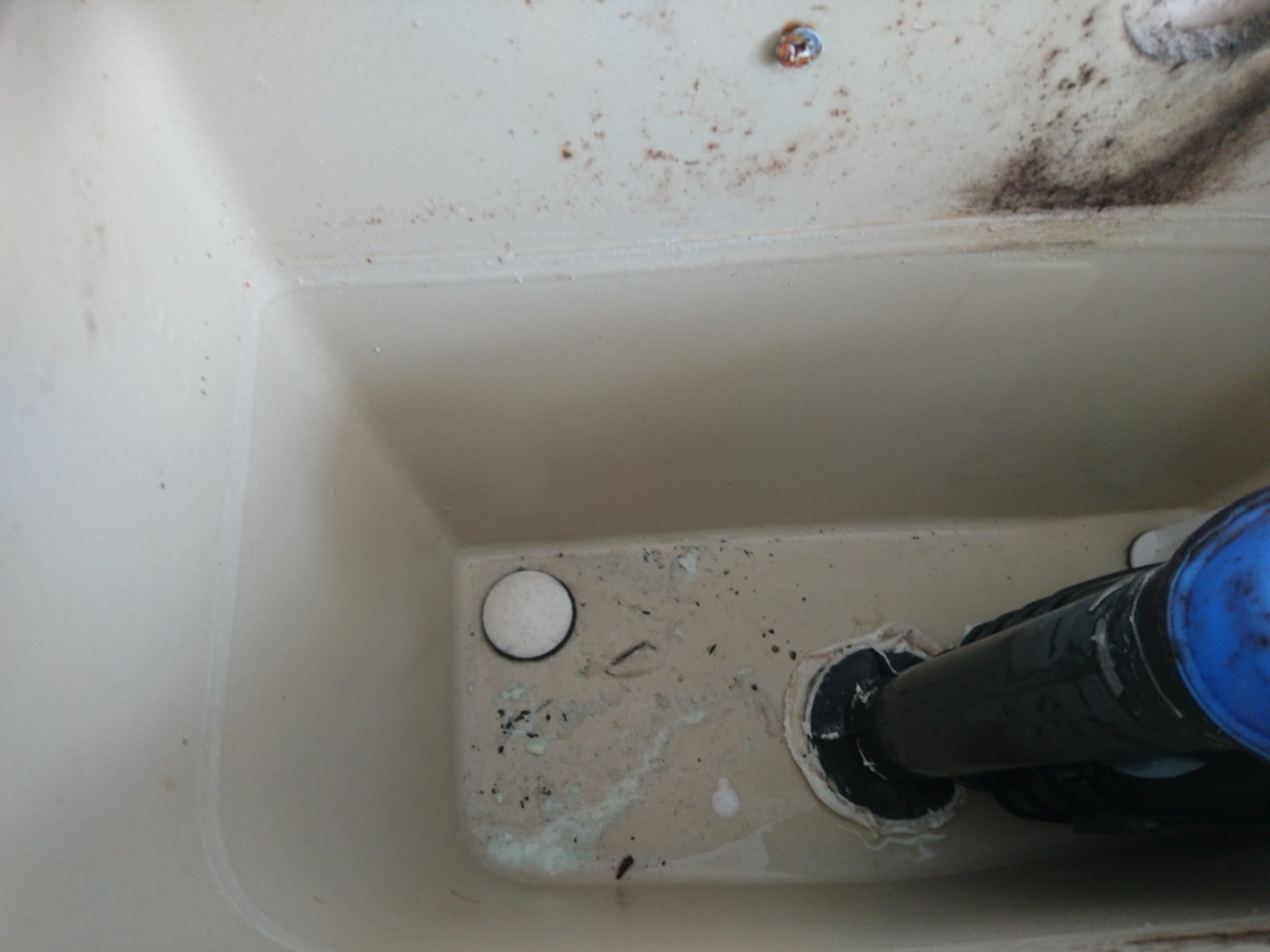

I knew my list wouldn't stay blank for long, I got up this morning, after SWMBO had left to look after her Friday dementia sufferers, and so came down to an empty house and went to make some breakfast. The "list" hangs on the wall beneath the kitchen clock and I noticed a new entry had appeared- "Leak in bathroom behind toilet" My thoughts went black thinking it was the soil pipe leaking. I went to investigate and found a bowl placed behind the loo under the cistern. Relief flooded through me:

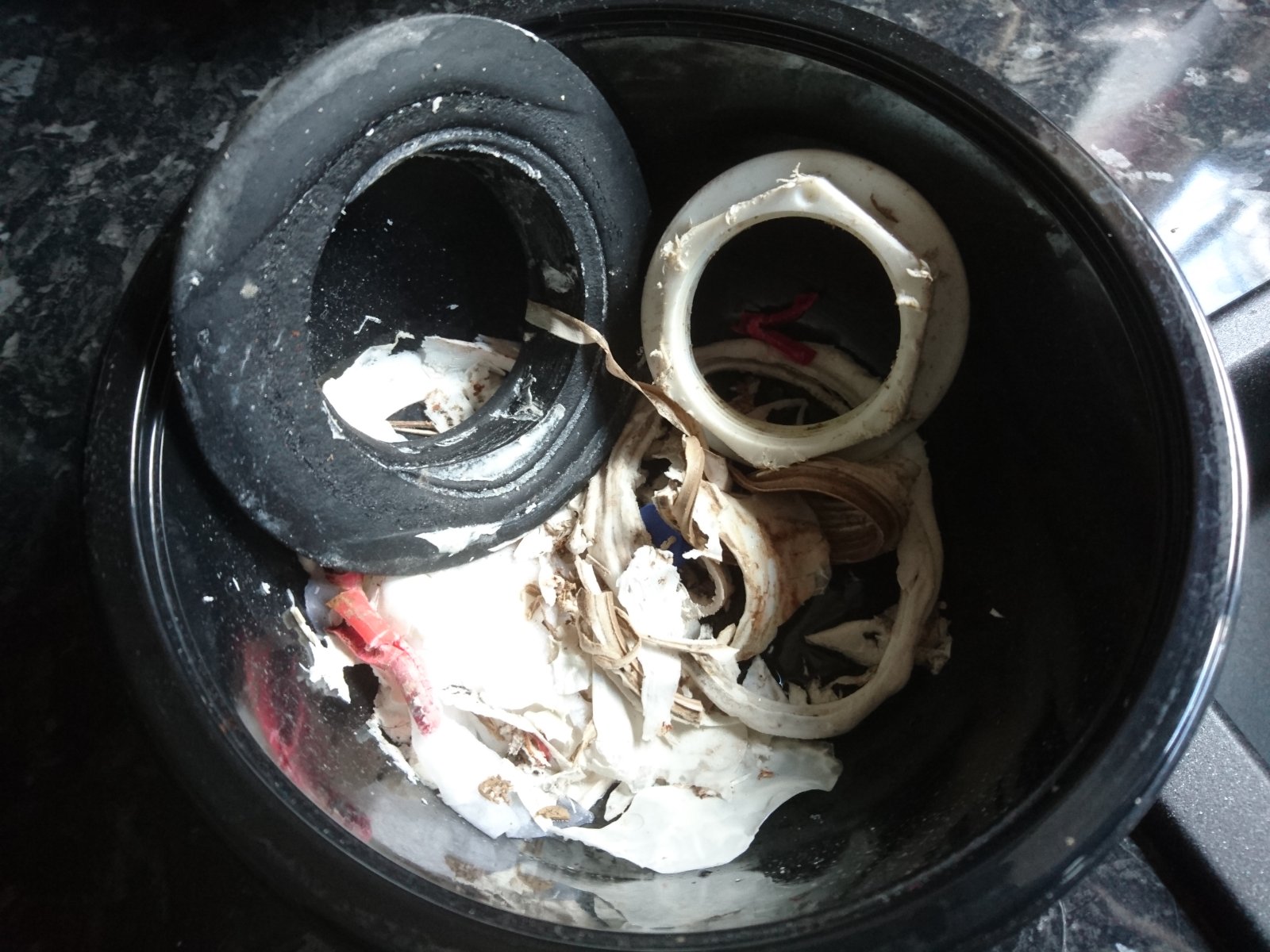

Clearly she had placed a bowl to catch the drips which were coming from the cistern to pan joint. I duly turned off the water and emptied the cistern with a flush and a syphon for a closer look:

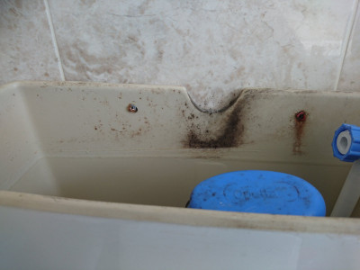

I spy a previous attempt to cure the problem which actually produced a different problem. I stood back and looked at the waterline on the back of the cistern and sure enough it was not parallel to the top. Aha!!
The "filler" had been put in unevenly causing the cistern to tilt which in turn had resulted in a leak on the upside of the tilt!!
So I set to work removing all the filler and silicone and broken bits of rubber and then decided that the syphon was looking a little bent where the filler had forced it ovoid so I popped down to B&Q and bought a new one which is now installed and hopefully another Job Done and crossed off the list!!

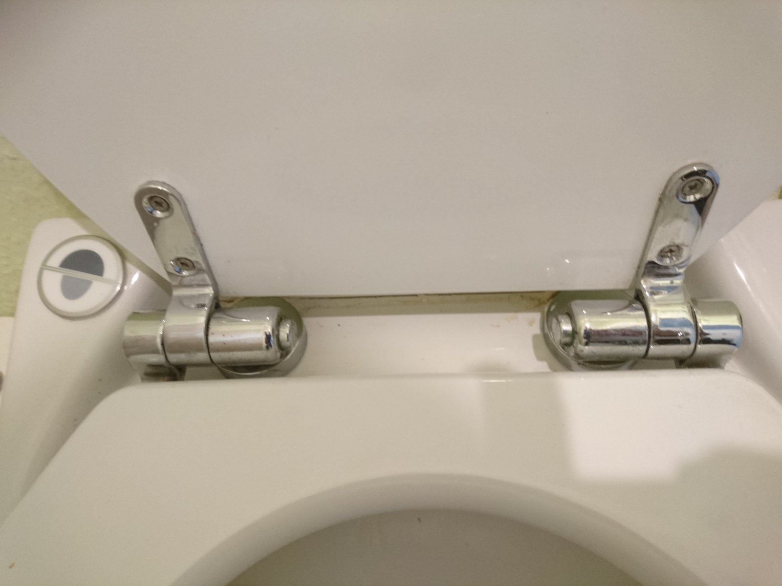

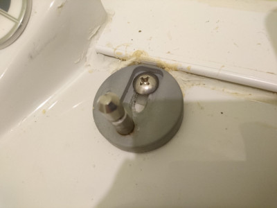

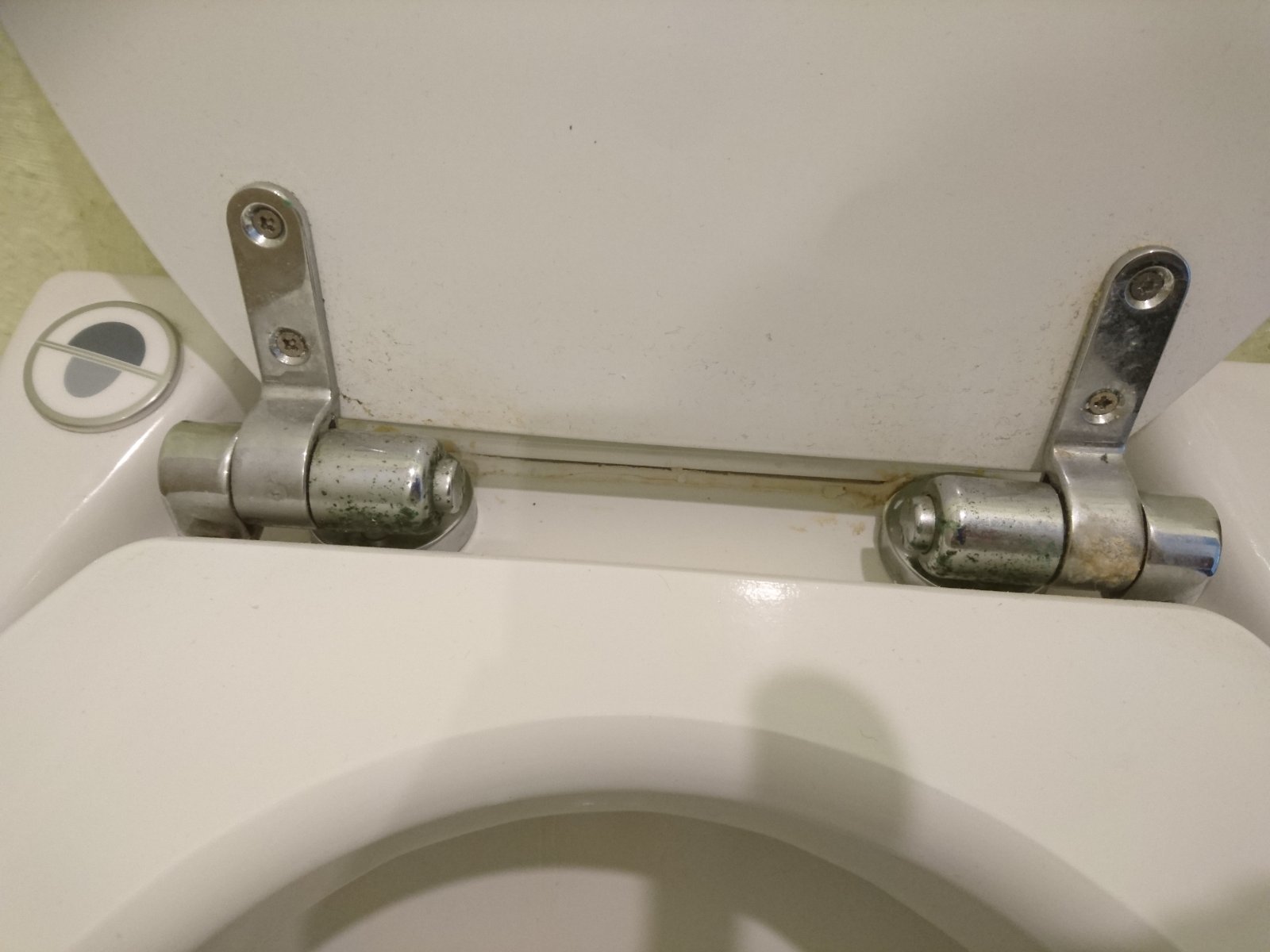

It was the turn of the downstairs loo today. SWMBO had complained that the seat was wobbling and could I sort it out.
My first view:

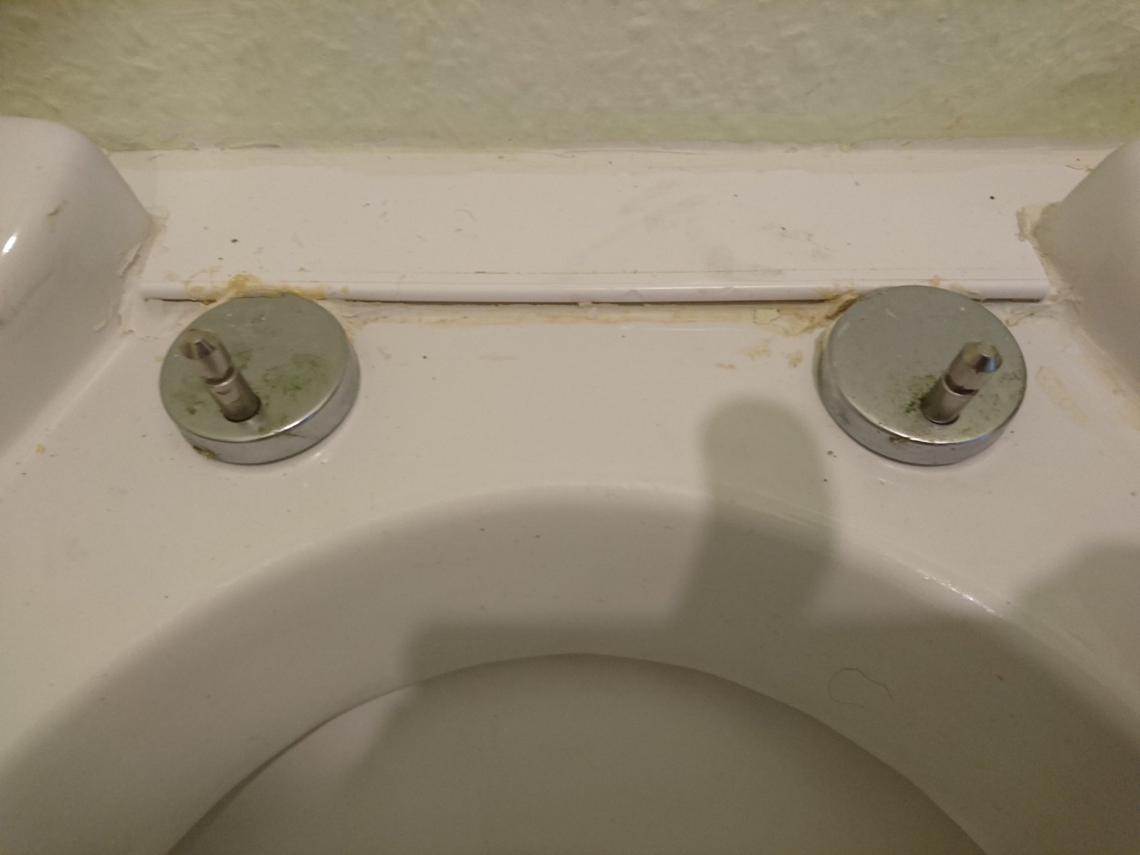

It looked as though we had some corrosion so I unclipped the seat which is done by pressing the two buttons on the inside of the hinges:

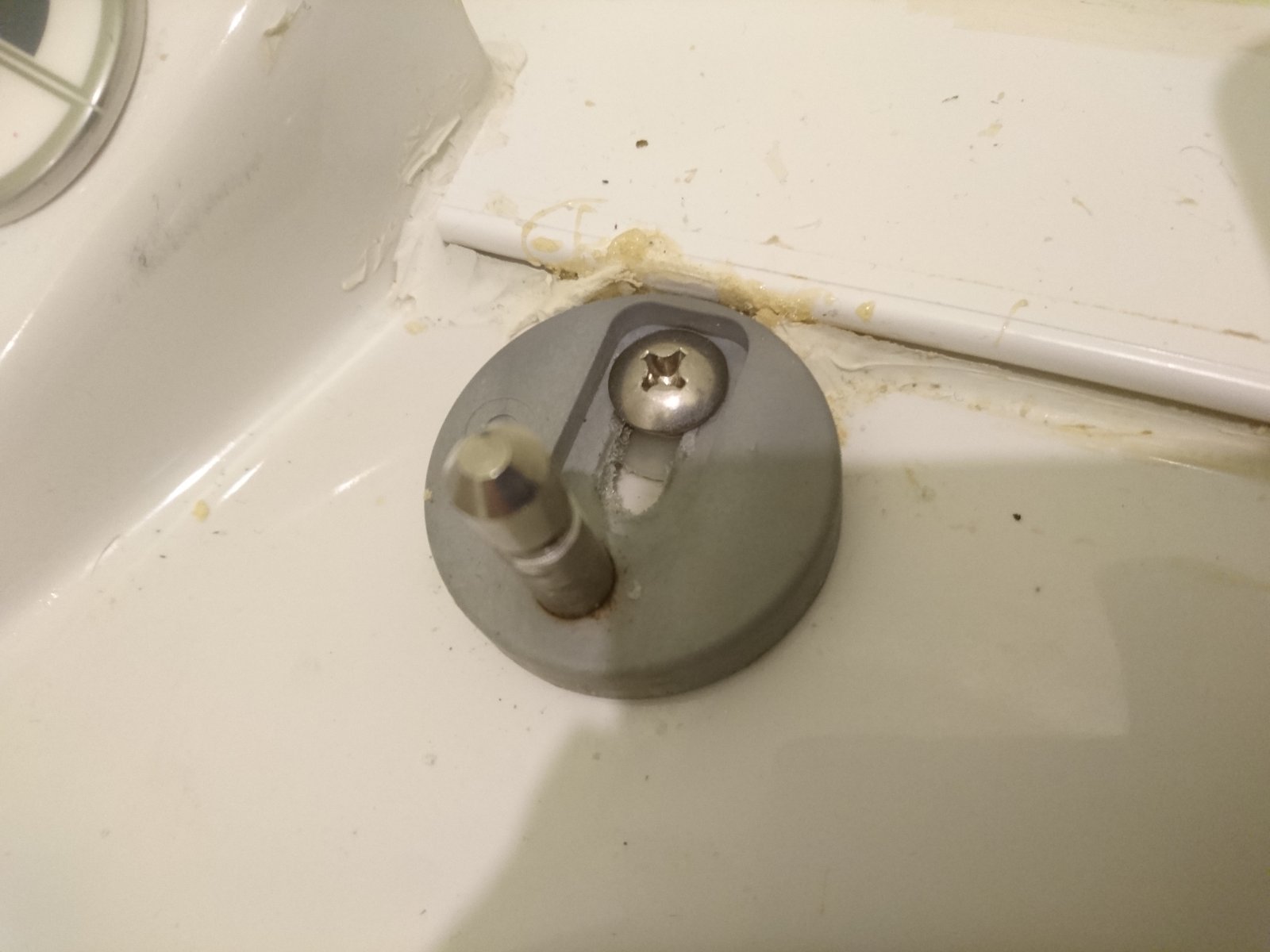

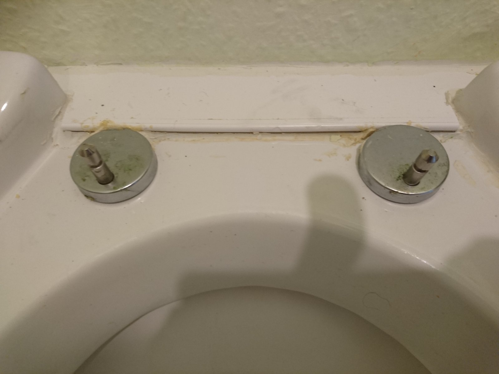

I then removed the cover and revealed the loose screw:
I tightened it and the blind cavity nut gave way (sorry forgot to take a picture) so I "beefed" it up with some self amalgamating tape and refitted it and then after cleaning up the hinges I refitted the seat:

My first view:

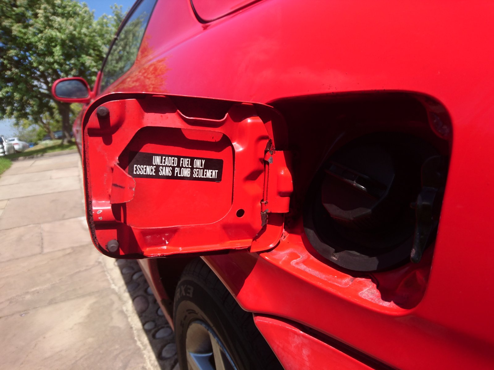

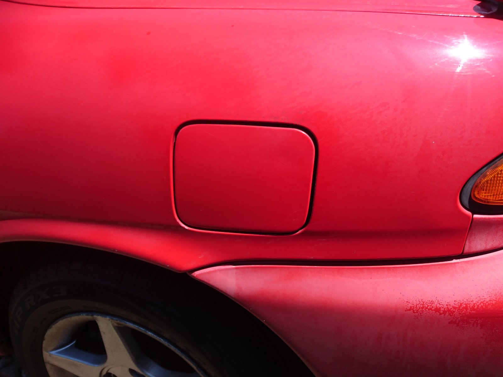

I was out in the MX3 yesterday and I had to fill up. I have owned the car for over 2 years now and so I was fully aware of the issue I encountered because I have encountered it every time I've filled up since getting the car and every time I said to myself, "I must sort that out!". Well (pause for fanfare.............) today was the day. Here is the fuel filler:
Nothing wrong with that you may think until I tell you that I took that picture after I had pulled the flap release. Every time I have had to prise the flap open with a coin as the spring on the catch was not strong enough to overcome the friction resistance which has built up in the hinge. Once open it doesn't need Sherlock Holmes to see the problem:
It is, and always has been, caked in crap!!
So after just two minutes with my waterless car wash, suitably diluted with water, and a microfibre cloth this was the result:
A quick application of machine oil to the hinge itself and now it works a treat !!!
Definitely a "Why didn't I do that after the first time I had trouble with it?" moment!!
Answer "I always forgot after getting home!!" Sorted now and well chuffed, it pops out perfectly as soon as I pull the lever!!
