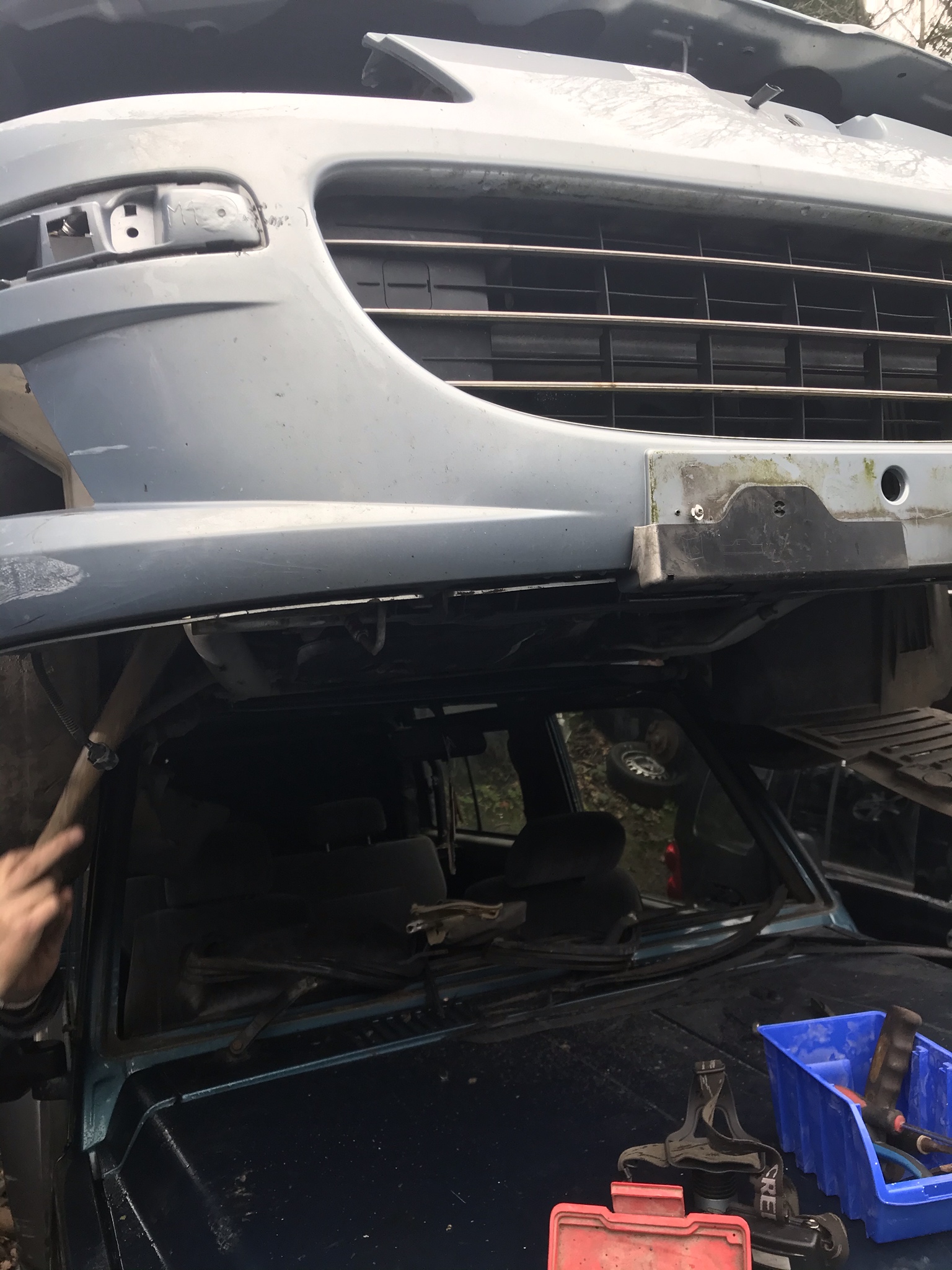

First, I had to find a donor hose and I found a sorry looking 407 at the scrap yard.
Luckily access was really good and the hose came off with no trouble whatsoever (guess I was just unlucky with my car!)
I cut the hose off the 407 much futher back than I needed to give me options as to where I wanted to make the join.

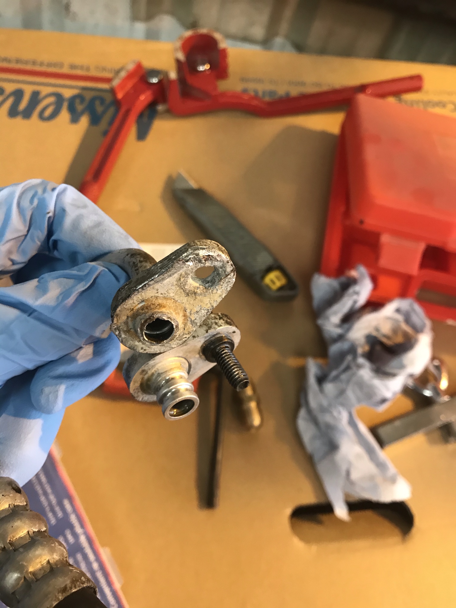

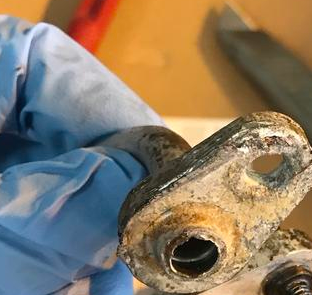

Here's a comparison of the donor 407 fitting and my corroded one.
I did a test fit and found that I would join the entire length of the donor hose to the end of my original pipe (it would fit well with a 90 degree bend)

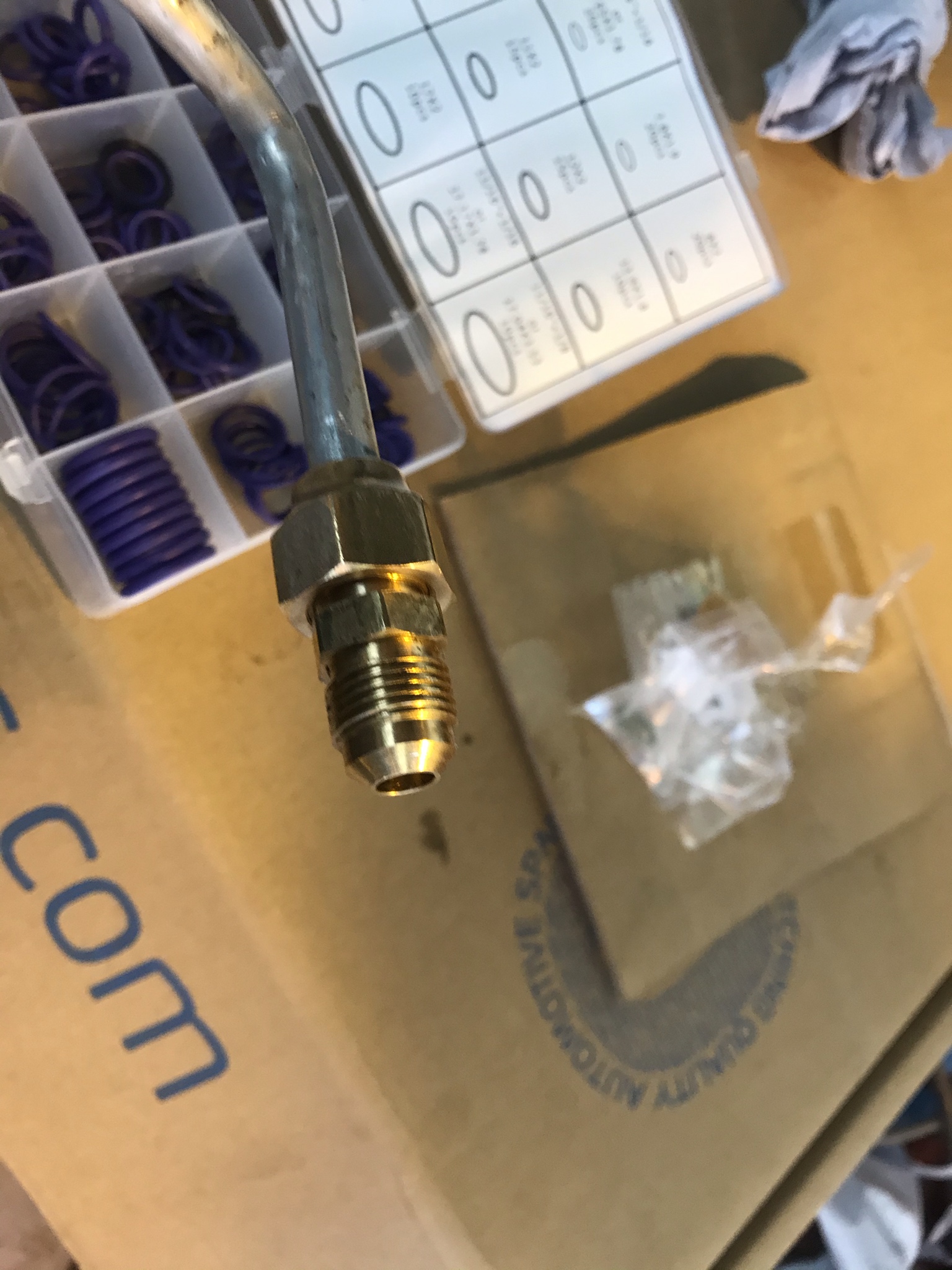

Using the flaring tool, I put the end on the pipe:
and then the union:
I did the same with the small bit of pipe I had left at the end of my flexible hose section:
And finally joined them together:
The join held a vacuum and now I will wait to see if it holds before getting it gassed.

It will probably work. Aluminium is not best for flaring since it doesn't work harden the same way as copper does. And it reacts a little with brass too, just keep that part covered from salt, maybe spray it over with some clear coat and wrap in pvc foil.
Looks like a nice job and it will probably hold. Vac result only shows big static leaks. Best to fill with nitrogen and see what happens. R134a only holds like 20 bar on a hot day, so it's not such a big deal. You will find plenty of other leaks elsewhere. I've recharged mine but alu pipes started to leak as they were porous on the bends. Put a pipe screw clamp on it and a bit of rubber and call it a day :rofl2:

Yeah, I've only ever used these brass flare fittings with copper but it was my only choice. Luckily the alu pipes were 3/8" so fitted my flare nuts; I expected the Citroen to use metric sizes.
