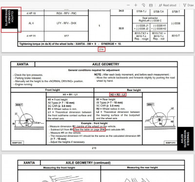

1. This pic for pre 1996 Xantia (found on the Net, don't know if the values are true :lol: ):
2. This page from the Forum's "S2 Xantia.pdf" link/file, where I found something strange:
Onto page 214 there is no table in regard to the height adjustment?
It could be something onto my comp only, just puzzled, that's all.

I'm just trying to reassure myself, that I can use the method provided by the "S2 Xantia.pdf" file. Ofcource mine is S1 Xantia, and maybe that method is not relevant.
There is written, for the front H1= R1 - L1, where L1=121 mm; and for the rear H2= R2 + L2, where L2= 136 mm. L1 and L2 are such at "Normal height" I guess.
I'm using 185/65/R15 tyres, so 15*25,4= 381 mm, and 2R1(R2) = 381 + 2x65 = 511 mm, so R1(R2)=~245 mm with the flattening of the tyres.
So, H1= 245 - 121 = 124 mm, and H2= 245 + 136 = 381 mm.
Pretty different from H1= 155 mm and H2= 420 mm, despite only tyres ~490 mm in diameter are cited into my first pic for pre 1996 Xantia. Calculating the above with 490 mm diameter will give even smaller H1= 114 mm and H2= 370 mm.

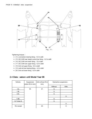

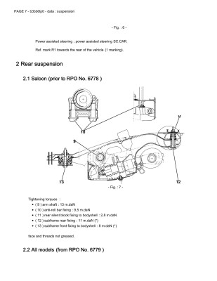

I have a description of the height of the Xantia but depending on the engine, not the size of the tires. Maybe it will be useful to you.
