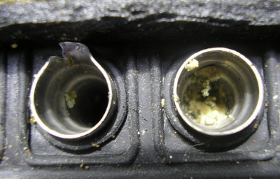

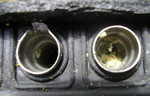

I poured boiling water in one end and only about 15% of the matrix got hot! Its only the passengers side that gets hot which explains it.
There was a LOT of sediment in there, I've tried flushing and back washing and lots has come out BUT still the whole thing isn't heating up as it should, I think the galleries are very small and prone to blocking.
What's come out looks like red brick dust so I'm not sure what's caused it.
Anyway I think it's worth noting that on this car the matrix is quite likely to be the problem when you've got cold air on the RHS

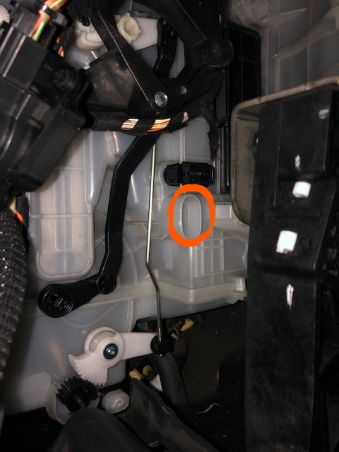

If I could add to the last question, there is an elongated hole in the heater box just below where the pollen filters go in, I'm getting cold air blowing out of it. I'm sure that this shouldn't be the case, if anyone could throw any light on this. Thanks.

Thanks for that marc. I can't help but think that when the engine is cold, the electric matrix would warm both sides before the matrix came into play. I have all the plastics off and you can see the flaps moving so there's no motor or spindle issue. I have to block the hole under the filter door to stop cold air blowing in directly. This shouldn't be the case and I can't help but think it's directly related.

hi marc, this is a link to an image of the heater box and the hole i was talking about emitting cold air. i'd just like to understand what this is before dismantling further . vin number is VF7**************[VIN obfuscated, can be read by forum staff]
there is nothing to go on it and the floor heater duct is above. there is no matching hole on the n/s.

I'm afraid I can't identify that from the picture and the available info I have which is of the other side, but it looks like a fixing for one of the ducts. Bear in mind that the heater units are the same for left and right hand drive vehicles with one heater duct different depending on LHD / RHD.

Just pulled the matrix and of course its blocked. its nice to find a positive fault. The cold air blowing out of the small hole has just been throwing me. I'll try and get a look at another airbox. If the new matrix sorts it I'll just have to leave the hole stuffed with a piece of rag. i just don't like a mystery. Thanks for the help and I'll post the results of the new matrix next week. Will.

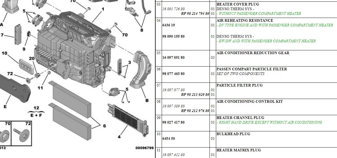

It's possibly supposed to be plugged - item 9 below
It is £17.50 though.... I'd be tempted to stick some duct tape over it!
