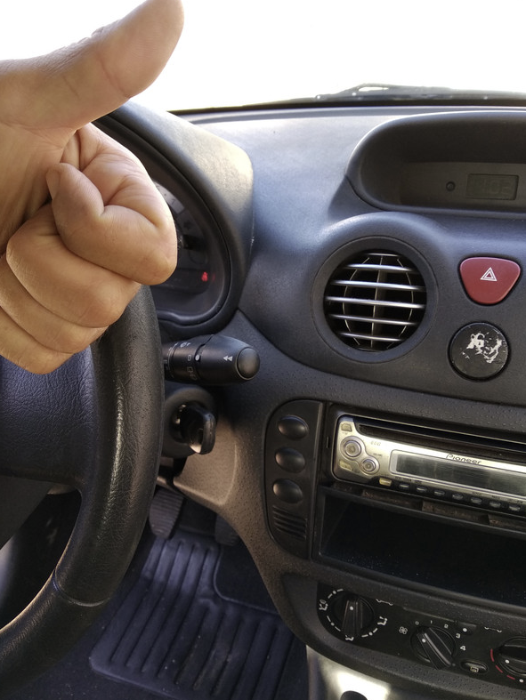

Re: I can't open the citroen c3 doors
Thanks to everyone.. and a big big thank you wheeler..
Finaly its Open.. and the engine running
I notice the aftermarket Radio - unsure whether this may be causing you some locking issues.....
Now I see that it worked, a friend in a Peugeot 206cc had an aftermarket radio that caused a problem with the air conditioning module on which the lighting was constantly working.
I thought about that too. But this radio has been installed for so many years and gave any kind of problemGiveMeABreak wrote: 07 Jan 2021, 18:05 I notice the aftermarket Radio - unsure whether this may be causing you some locking issues.....
