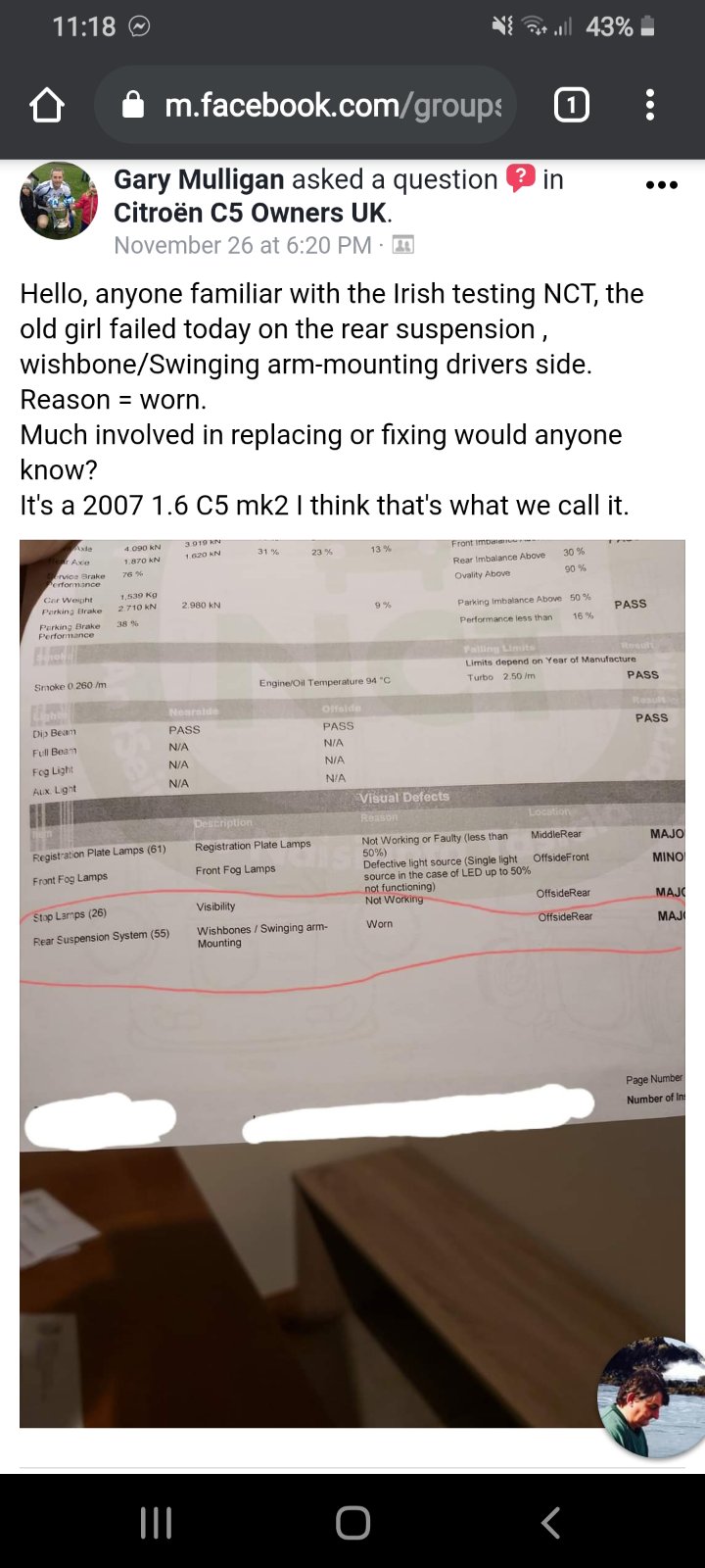

Hi citronut
I've a 2007 C5 1.6
It's just after failing its MOT here in ireland.
Is there any kits I can order with all the bits in?
See attached image
