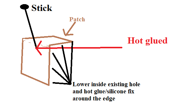

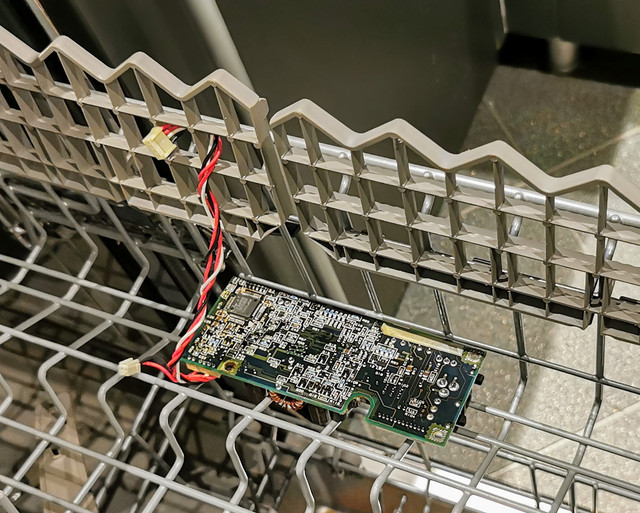

My approach to repair that Zel would be to cut a patch from stiff plastic, I usually use card file dividers, and then mould it into the right shape to fit inside the hole. Then attach a stick, for holding it, to the centre with a hot glue gun and gently lower into place so you effectively form a back to the hole. Seal round the full edge with hot glue or similar and then, when it has set solid, cut off the stick and you can fill the patch with normal resin and filler mix, P38 or similar. Sand back and paint - jobs a goodun!! :)
Something like this:
Own work
Own work

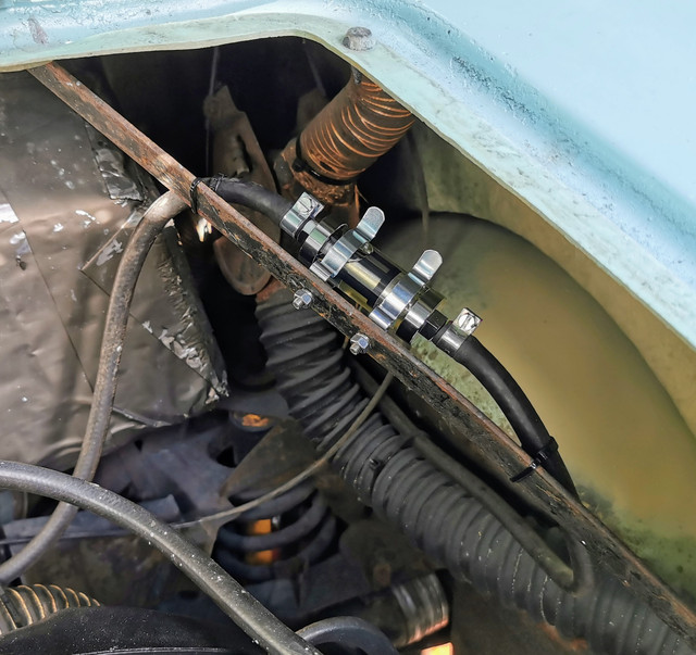

Having thought about it for two seconds I realised that the position I'd mounted the fuel filter in was going to be massively in the way...All I needed to do however was flip it around to the opposite side of the support bar it's attached to.
That should be far more out of the way.

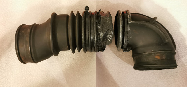

The Xantia decided it hadn't had enough attention lately so decided to pop up the low oil level warning when I started it up this morning.
Had a look and the level is absolutely fine, so just the usual "once every three months" false positive. The occasional false positive or not, I'd still far, far rather have this warning light than not.
Of slightly more concern however was that in the last couple of days I've been becoming very much able to hear the dump valve from the turbo again. That was last heard back in November 2018 when the intake line between the air filter and intake ducting split. This was repaired at the time using self amalgamating tape, duct tape and cable ties. No great surprise it's failed again...astonished it's lasted this long!
Just fell apart when I touched it. This is a problem that basically all TCT engined Xantias are running into now as the pipe just turns to plastic then splits. The parts have been NLA new for years, and the vast majority of secondhand ones are just as bad...Having had a quick look at it, the hose is a 70mm inside diameter, so a generic silicone elbow will be ordered in to replace this. In the meantime a bit of random ducting and a cone filter have been deployed. The soundtrack now is frankly ridiculous. To say the dump valve is "obvious" when you come off the power would be an understatement. Hopefully shouldn't be too hard to sort with a bit of off-the-shelf silicone pipe. Should be enough flex available that it can accommodate the kickback in the line the duct needs to take.

I still find it amazing the Invacar will happily cruise at 55-60mph! I reckon it would gibe my Saxo a good run for its money!
You know, I reckon there's a market for replacement TCT induction elbows... They all go like that, as do all the others in the family, V6 and 1.9TD particularly...

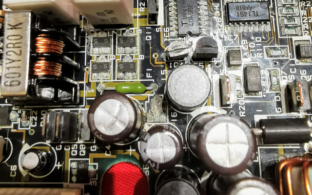

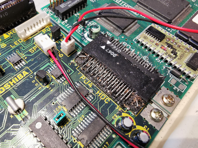

Looking at the power supply board, it was no surprise whatsoever to immediately spot obvious signs of capacitor leakage.
In addition to this, there was one obviously visibly blown transistor.
The only marking on this is 11397 which so far hasn't turned up anything particularly useful on a Google search. That's going to be fun to track down...
*If* I can find the original PSU I might be able to scavenge the transistor in question... though to be fair if I can find it just recapping it and swapping the boards would probably be the way forward as my original one had issues with leaky caps causing it to shut down and go into a fault mode, but it had never gone pop like this clearly has...Time for another rummage in the loft to see what remains of my original machine I can find. I want the keyboard and lower case at least anyway.

A little later in the day, the boards had finished cooking...Let's take a closer look. Power supply up first.
That's a little bit less disgusting at least. Looking closer however shows that it's in quite a poor way. Quite a few tracks have dissolved.
Quite a lot of these are downright tiny so repairing them will be a pain. So for now I think we will sideline this PCB until I've had a chance to dig out my original PSU and pray it's in a better state.

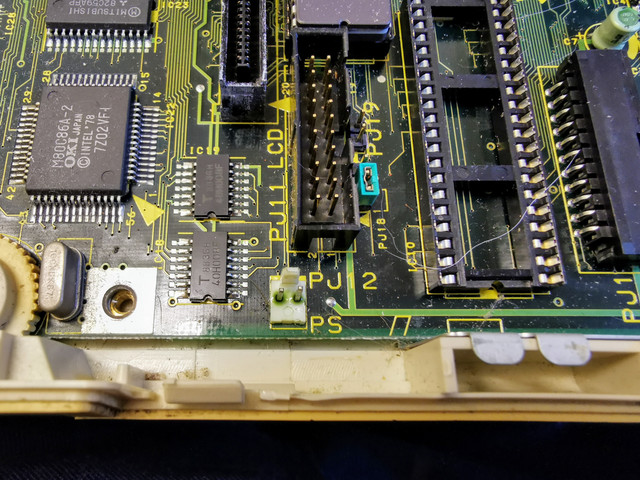

How about the motherboard?
Here's a closeup of the connector that was looking distinctly green in the original photos.
However I think I've made a discovery which has indeed rendered this a "parts" machine and nothing more.

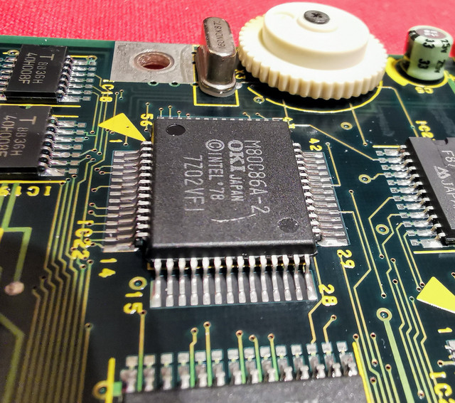

You know that point on an a car where you drain the oil and see that horrible silvery sheen in it, that you know is metal that used to belong to critical bits of your engine? I think spotting this was the electronic answer to that.
Look more closely at the CPU...

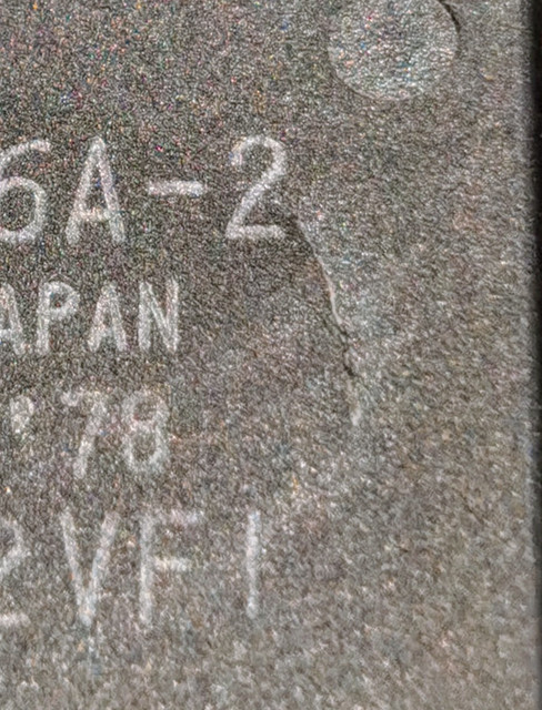

See that little white mark? The thing that I thought was a bit of hair and went to brush away...
Uh oh...
Yep...That looks to be a crack in the package. I have a sneaking suspicion that the magic smoke has escaped from this CPU.
My current theory is that one of two things has happened in the PSU...
1. Due to conductive capacitor goo getting into places it shouldn't on the board, the 12V input has leaked onto the 5V output line (I *think* the only lines this has are 12V and 5V).
2. Due to the dissolving tracks, we've lost a feedback line somewhere and one or both of the output voltages have skyrocketed until something went bang.
It's possible that there was some catastrophic failure on the motherboard and that that caused the transistor we've found popped on the PSU to go...but the PSU going haywire and nuking the motherboard seems rather more likely to me.
The question at this point becomes whether anything useful has survived. As far as I know the motherboard on my old machine was fine, the only issue with it was in the PSU. It had just gone into a protection mode (flashing red light), and I've not been aware of anything going bang...so fingers crossed I'll still be able to make one good machine out of the two. I need to find the box of bits of my old T1200 first so I can find out what parts I'm actually missing.

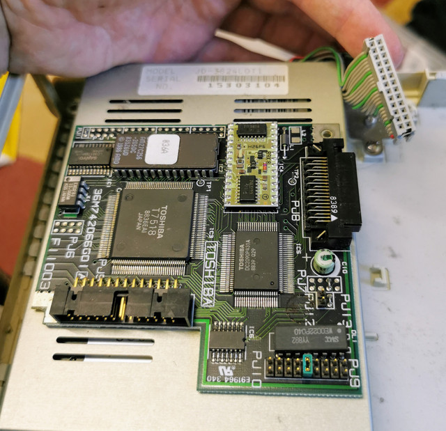

I'd really like for the hard drive and its interface card to have survived as those drives are really rare, and my one has been sitting since at least 2001 so I've no idea whether it will still be in working order - as due to the proprietary nature of it I've not been able to just plug it in and spin it up as I try to with most of my historic drives on a reasonably regular basis. While I do have a note of the pinout, annoyingly these drives behave in a way (somewhat like some SCSI drives) meaning that they won't actually start the spindle motor until a motor enable signal is sent from the controller...and when I last looked there were three conflicting reports on what voltage that pin wanted to be supplied with...and I'm not about to go and blow up my drive that's made of pure unobtanium by guessing.
Toshiba seemed to like oddball hard drives in the last days of the 1980s, they used a similarly obscure and proprietary drive in the T3200 (NOT the SX/SXC etc versions, those used a standard Connor IDE drive) in the form of a Fujitsu M2227DT. A totally different but equally proprietary drive, in 40Mb form.
One of these.
Here's the interface connector.
This at least doesn't have the same issue as the T1200 drive where it requires a signal to enable the spindle motor...and it has a standard Molex connector for the power supply. So as soon as you hook power up it starts up. This is good because it means that I know this drive hasn't suffered from any of the horrible issues you hear of where spindle motors seize up or where the heads stick to the platters. It's always a nice one to spin up anyway as it has a really unusual sounding spindle motor.

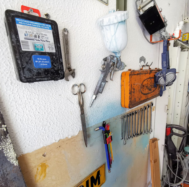

EDIT: Do these steps qualify as having started to sort out the garage?
The socket sets, spanners, allen keys and the box of drill bits now have homes attached to the garage wall in easy reach. So I don't need to drag a heavy tool box all the way out of the far end of the garage or more likely wind putting them somewhere more nearby because I'm lazy...and then forget where they were! The black socket set is by far the most commonly used tool, hence having stuck it right by the door.

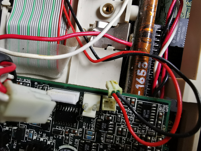

Right, back to the very sick Toshiba T1200 patient on the operating table. I've pretty much written off the motherboard in my donor T1200 as at least one chip has had the magic smoke escape and I'm reasonably convinced there are cracks in a couple of others though it's hard to tell with the naked eye. In addition several traces on the power supply PCB have dissolved and due to the density of the board repair was going to be really tricky.
Time to go have a dig around in the loft to find the remains of my original machine and see if we have the potential to make one good one out of the two.

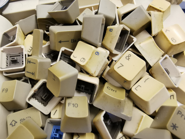

The keyboard on the donor machine as you may remember was absolutely gross. Here's what was left when the key caps were removed to be cleaned.
Doing that to such a nice keyboard is just downright criminal!
For those who know their keyboards, yes those are Alps key switches. The keyboards on these laptops are better than most desktops I've used. My favourite keyboard of all time (Northgate OmniKey Ultra) uses identical switches to these. I do have a couple of spare boards from machines I've stripped down over the years, and have pondered now and then whether I could actually figure out a way to interface with them to make a compact desktop keyboard. I'll need to actually do a test one day, but I reckon on the T5200 (which is the one I've probably spent the most time behind) I can easily keep up with my typing speed on the IBM Model M on my desktop.
This one looked a bit better after a good old scrub with the vacuum cleaner.
I'd have liked to be able to get the foam off to give it a wet clean, but it is well and truly stuck in place. So some of the 30 odd year old grime will just have to stay...won't be visible once it's back together anyway.
Then the fun bit. I always find reassembling a keyboard after having it to bits to clean very satisfying.
There we go...
Definitely has a few miles on it!
In a truly bizarre turn of events it was actually exactly where I thought it was in the loft. The only bits I've not been able to immediately lay my hands on are the display and keyboard. I know they're up there somewhere...but *hopefully* these won't be necessary to actually get things up and running. The display is still an unknown, given the motherboard looks to have been subject to some major over voltage issues we'll just have to see.
Time for an assessment...
We've got the lower case moulding, LED retainer and screen switch bar, motherboard, memory expansion board, rear connector riser, hard drive interface card, a display backlight inverter - and it turned out a couple of bits from a totally unrelated project.
Let's start with the power supply. It has leaky caps and there's some fluffy looking corrosion on some of the component legs, but it almost looks more like something has gone after the solder itself rather than the PCB tracks - it's worth noting that this did live in the loft at my parents house for about 10 years, and that house was VERY damp, so this may well be more to do with that than the capacitor goop.
Comparing to the worst (visible) track damage of the PSU we've already looked at this definitely looks like it's a more likely rescue candidate.
For reference, I'm referring to the machine I just picked up as a parts donor as the "new" one, and my old incomplete one as the "original" just to try to stop myself getting tied in knots.

It still needs the caps changing, but the only other damage I've been able to find was one tiny transistor (right in between the leaky caps) which came away from the board when I was scraping around to see if we had any broken pins on the ICs or anything after we'd given things their first clean. The pads it should be attached to are pretty much in the centre of the photo below.
I need to remove those caps for replacement anyway, so that will obviously be the time to replace the transistor. Won't that be fun. Couldn't have been a nice chunky inductor or something like that could it?
It still tests fine...I don't rate my chances of getting solder to reflow to those pins though so will probably grab the one off the new PSU (which tests identically on the meter).
Moving our attention back to the motherboard and what's left in the case I thought I'd check the RTC battery, mainly for giggles. Given it's a NiCd battery from 1990 (early 1990 is the latest date code I've seen on this motherboard) that hasn't seen a charge current since 2001 I wasn't expecting to see anything.
While I've not actually found any damage to the motherboard, it was entirely covered in a greasy feeling residue and there was some grime particularly on the inter-board connectors.
Figure that I'd rather get rid of that greasy film whatever it is in case it's something that long term will be harmful so the board's getting a clean.
The display on these machines uses a large EL panel for the backlight, and the inverter board for that is the area other than the main PSU which is renowned for having issues with leaking electrolytic caps. Conveniently the inverter from my original machine was still with it so we can take a look at it.
Yep...Those be leaky! Will look up the values and add them to the parts order that will be happening shortly.
The motherboard has recently returned from being cleaned, which brings us pretty much back up to date.
Glad to report that all the greasy residue has gone. It's going to be spending the night sitting in the airing cupboard with a fan pointed at it to help ensure any remaining moisture is evicted before we go any further.
Apologies these photos aren't the best. I was working at the dining table and the lighting there is horrendous for taking photos with due to glare.
Next steps will be to get some capacitors ordered to recap the PSU and to reattach/replace that transistor which has dropped off. Then we can start putting things back together and see if we can by some miracle end up with a working machine.
We probably won't be seeing much from this for a while as I'll be needing to get some parts ordered in, so we'll be back to the actual topic of this thread for a while!

xantia_v6 wrote: 17 Oct 2020, 19:16and a steady hand.
I fail on that one these days :roll: :lol:
The new intake hose looks good :)
That keyboard :o :twisted:
Posts: 7948
x 2837
Re: Zel's Fleet Blog - Xantia Activa, Jag XJ-S, Sinclair C5, Mercedes 208D, AC Model 70.
I wonder if those yellow plastic keys would clean up the way we used to clean our pushbike mudguards......with Steradent tablets. :)

xantia_v6 wrote: 17 Oct 2020, 19:16 Having seen the condition of yours, I will open up my T1200 next weekend and check for visible leakage. I have my fingers crossed that it will be OK, as it has been stored in a cellar which has a fairly constant cool temperature.
Definitely worth doing. It seems to be something that these machines universally suffer from at some point in their lives. It's a pretty easy to change the affected caps themselves - it's repairing the damage they've done if left unchecked for years that's the hard part.
The caps in the power supply are:
2X 1800uf, 10v.
3X 470uf, 25v.
220uf, 25v.
150uf, 35v.
10uf, 25v.

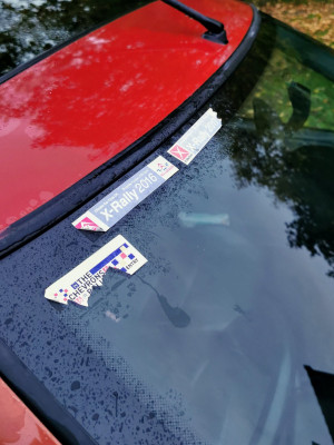

Removing these stickers really felt like absolute vandalism and doing so broke my heart as they feel like part of the car's story. Sadly the sun over this summer had done a number on them and they were disintegrating.
