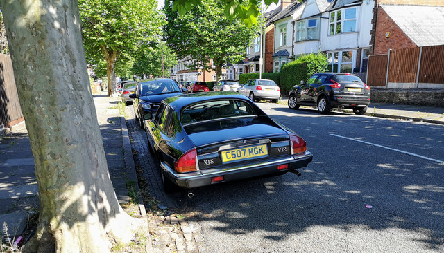

Abby has been suffering from blinding toothache for the last couple of weeks and was finally able to see her dentist today.
Given the Jag has no functioning A/C (yet), I opted to park in the shade and get out to wait outside (given the heat soak through the transmission tunnel is bad enough when it's not 29C outside).
I made a discovery today in that the *back* of the car ends up nigh on too hot to touch after an hour on the motorway. That kind of puts in perspective how ridiculous the amount of heat that this engine chucks out!

he immediate urgent job for the Jag though is tyres.
What I hadn't spotted when I looked at them originally (and observed that there's excessive wear on the inner shoulder), was that the driver's side one is worn far more badly on half its rotation to the other half - and it was the good side that I originally looked at. It's still legal as the tread is still above the legal limit over more than 75% of the width of the tyre and it's not down to the cords or anything like that, but it definitely needs changing now. The fact that it's got about 0.75mm more tread on half the tyre than the other probably accounts for the horrible out-of-balance like vibration at specific speeds.
The rears have plenty of tread, but are pretty cheap, the best part of ten years old, and starting to perish in several spots. As with the front ones, they are also the wrong size. The car is currently fitted with 205/75 R15 tyres with a speed rating of H. It should be wearing 215/70 R15 W tyres really. I can't recall what load rating they are, but definitely lower than what's stated as being OEM fitment.
This size doesn't give me a huge amount of variety for appropriate rubber, it's a very common size for van tyres so you have to do a bit of sifting through the listings to find what is actually applicable.
While I'd love to fit the Pirelli Cinturatos that were original spec - at £400 odd each, that just isn't happening. Much as my sense of order would enjoy actually having the specific tyres listed in the handbook on the car. It needs to be a period looking tyre though, something with a very modern tread pattern would just look violently out of place on a car like the Jag. Plus I'd really prefer a tyre with a nice squidgy sidewall like would originally have been fitted to ensure we get as decent a ride as possible.
The one I seem to keep coming back to is the Vredestein Sprint Classic, which the cheapest I've found so far is £224 apiece over here on MyTyres.f anyone has seen them cheaper anywhere else please feel free to sing out. Camskill are one provider I've heard a lot of people mention, however they only have two tyres available in this size, and they're both van types.
Pretty much wherever I go, that bill is still going to sting!
Still waiting for the air conditioning pulley puller to arrive. I got duped by a dodgy Amazon page again, which proudly proclaims to be a UK based seller in several locations...however has a tiny asterisk and states in about 0.2pt text "Goods may be dispatched from our warehouse in the People's Republic of China." So that will turn up at some point down the road...precisely when though is anyone's guess. At least it's not massively urgent.
Had to make another run up the motorway today and can confirm that the exhaust is not at all obtrusive at speed, which is nice. The cruise control is also behaving far better now I've adjusted the cable a bit so the actuator is actually pulling the cable straight rather than at about 30 degrees as it was before.
I imagine once the tyres and brakes are done it will be like a different car to drive.
