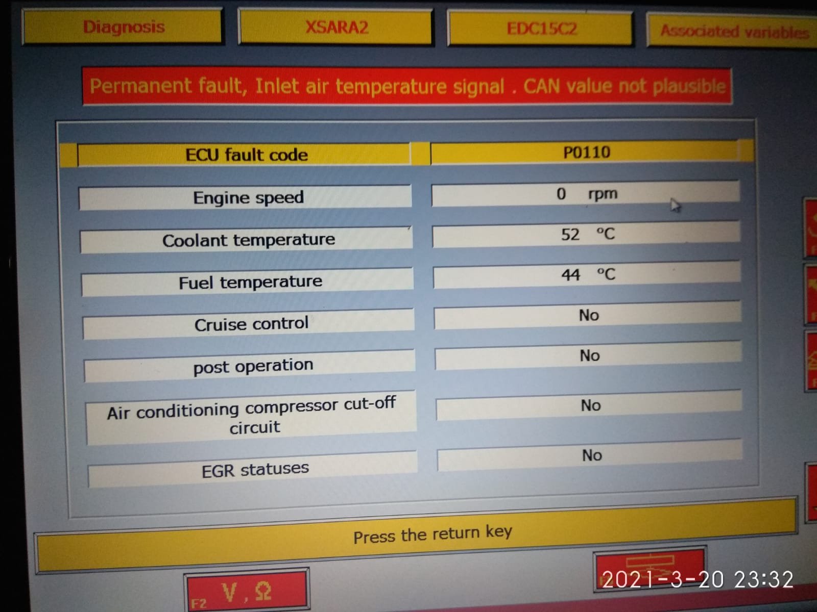

Same thing happened this evening when brother was driving. Went to cross road into our lane and car went into lump mode plus EML illuminated.
Just taken the lexia it and got p0571, p0221, p0110 and a fuel sender short circuit.
There are no timestamps so I can't figure out the sequence of the faults and if they are all interrelated.
I had noticed that the car was idling slightly higher than normal - just over 1000rpm instead of usual 750/800rpm.
I have no idea how to diagnose an intermittent fault, so any help appreciated.

Re: Xsara II 2.0 HDI 90 limp mode
Is it an EDC15C2 Bosch ECU, Dave?
EDIT: Ignore! I can see it is from the Lexia session.
Give me some time to look into this. I have the Diagnostics manual for that ECU.
Intermittent faults can be a mare...
Can't look in massive depth at the moment and I do not have wiring diagrams for your vehicle so you are on your own there unless Marc (Givemeabreak) has them and you donate to be able to access them.
I'm only a beginner at diagnostics but I learnt a lot last year with my 2.0HDi.
Fault Code 6 in the Diagnostics states:-
The engine runs at accelerated idle speed, then accelerates but with reduced torque (engine warm)
Check to be made:-
1) Battery voltage
2) Mechanical fault: accelerator pedal, accelerator cable
3) Coolant thermistor function
4) Oil vapour recycling system - fluid level (Not sure why it has this for Xantia. Presumably this is the Eolys system?)
5) Air flowmeter - flowmeter wiring.
Check to be made:-
1) Battery voltage
- Donor 2023
- Posts: 1818
- Joined: 22 Nov 2004, 00:21
- x 82
P0190 Fuel pressure sensor (major fault)
This will be located on your fuel rail somewhere. On a Xantia, it is underneath and behind the fuel filter. Horrible to access.
With connector still connected to component:-
It should be 3 pin and requires 5V. As this is a temp fault, you want to check your wiring back from it. Maybe run engine and do a waggle test to see if you can cause the intermittance.
Test between pins 1 and 3 the outermost ones for 4.8 - 5.15V with ignition switched on.
Between Pins 1 - 2, you should see 0.5V with engine stopped. At 200 bars, pressure, you should see around 1V. The signal will vary between 0.3 and 4.7V. Ideally, you need an oscilloscope.
P0221 No. 2 Position sensor for accelerator pedal (major fault)
Emergency mode on this component shows 1200rpm idle or thereabouts.
With component connected:-
Pins 3 - 4 should show between 4.8 - 5.15V.
Pins 2 - 3 Linear variation of the voltage from the "throttle released" position to the throttle pedal full down" position: 0.28 - 1.6V
With connector disconnected:-
Pins 2 - 4 you should see infinite Ohms.
Pins 2 - 3 Ditto
Pins 2 - 4 If a short circuit to earth occurs while driving, the engine speed drops to 1200rpm. While operating the starter, the accelerator pedal position information is not taken into account.
NOTE: The simultaneous pressing of the brake pedal and the accelerator pedal will cause the following fault to appear: "brake pedal sensor incoherence".
P0110 (minor fault)
Air Temp sensor built into MAF if you have the VDO/Siemens unit
Between Pins 1 - 3, you should see between 2500-5000 Ohms between 20 degrees C air temperature and 5 degrees air temperature (ie current weather conditions)
Does the engine run on after switching off?
My money is on the wiring to either the fuel pressure sensor or the accelerator pedal sensor or maybe fault fuel pressure sensor (but I wouldn't go just swapping parts out). You need to narrow it down.
Intermittent faults I would hazard are more likely to be wiring.
Have you ever had the clutch changed? Especially around the time the fault started to occur because, as I recall, there is a splice near the gearbox which carries signals to either the MAF and the throttle sensor (well there is on a Xantia) 22MOT loom from memory. That can get damaged. I think it links to the FPS too. I'd need to check.
Pins 2 - 3 Ditto
P0110 (minor fault)
