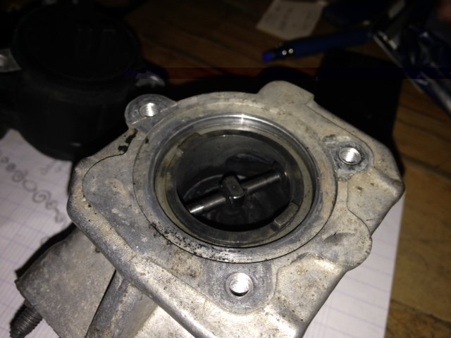

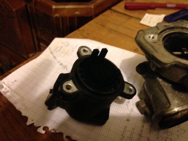

Took the EGR out and did an actuator test, still nothing.
I couldn't find a definitive pinout for the plug so I probed all the pins with the +ve terminal and the -ve on the engine (ig on). The orange wire, left hand most with the tang to the bottom gave me 5v.
I then took the 2 halves apart (rv6 socket) and plugged in the electrical side and repeated the actuator test. This should now turn one way then the other (like a servo motor),...nothing. Not surprising really
It as black as it looks.
Then I looked at the mechanical side The 'clock hands' move on a small worm and should be smooth. It took some force to move it. It was stuck shut when I took it off. Either end of the worm is damaged so the clock hands are locked in position until brute force or vibration allows movement.
The other thing is that the sleeve with the worm and clock hands is loose, that can't be right.
So it's buggered, seen aftermarket versions for 50 euros and a Valeo for 120.
I also think that someone has been here before unless the reverse torx screws get damaged on their initial tightening and Cit fit the more expensive EGR clips with a 5mm allen screw as standard?
