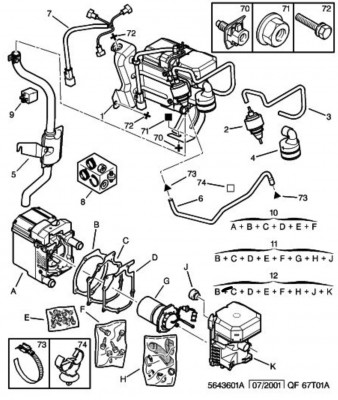

Posts: 37459
x 5743
Re: citroen synergie heater blowing air randomly
Post by GiveMeABreak »
I just checked and you do have automatic additional heating fitted and it’s very integrated into the system as you can see....
