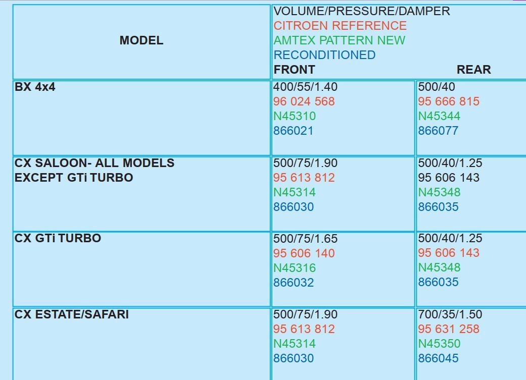

Have checked the CX repair manual, but cannot see any instruction for bleeding the suspension system, so I assume it is self-bleeding, given a good few Citrobics. Worth checking for air in the reservoir fluid (dip a sample, after a drive). If anything other than a few microbubbles, that needs sorting.
The CX sphere data I have...
(Volume/Pressure/Damping)

Re: GTI Turbo 'squatting under power
So it looks like the rear spheres are the same for saloon and turbo......
