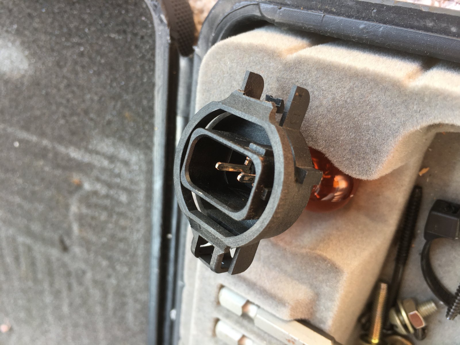

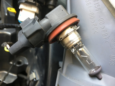

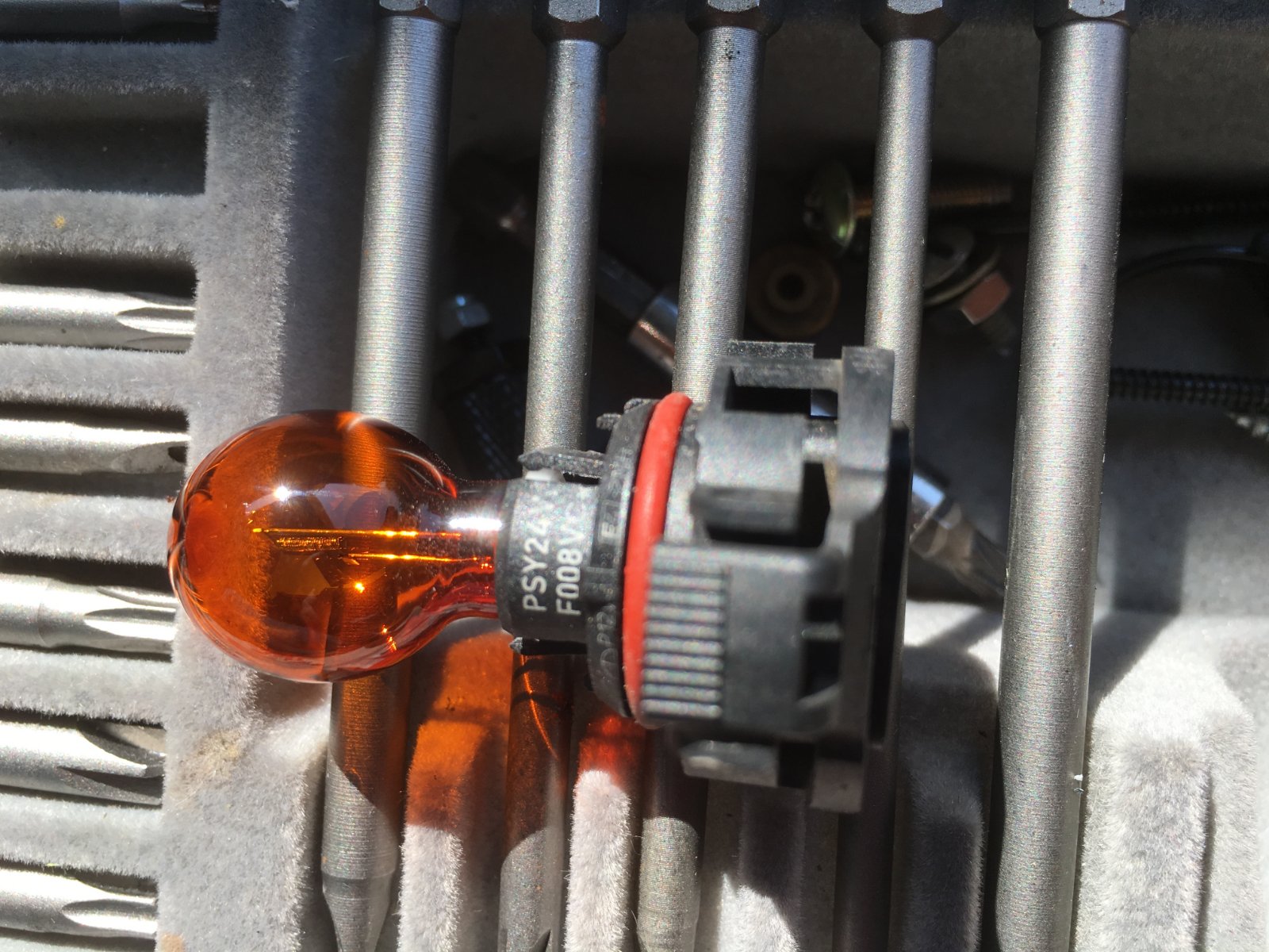

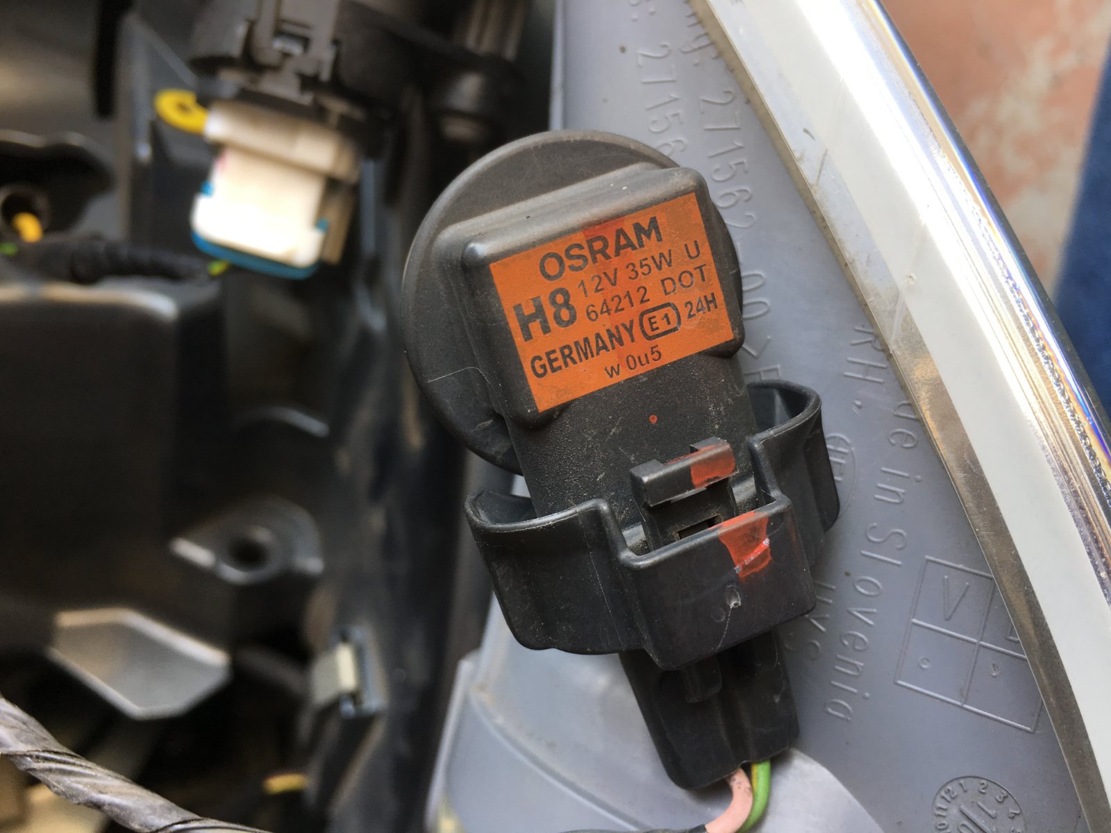

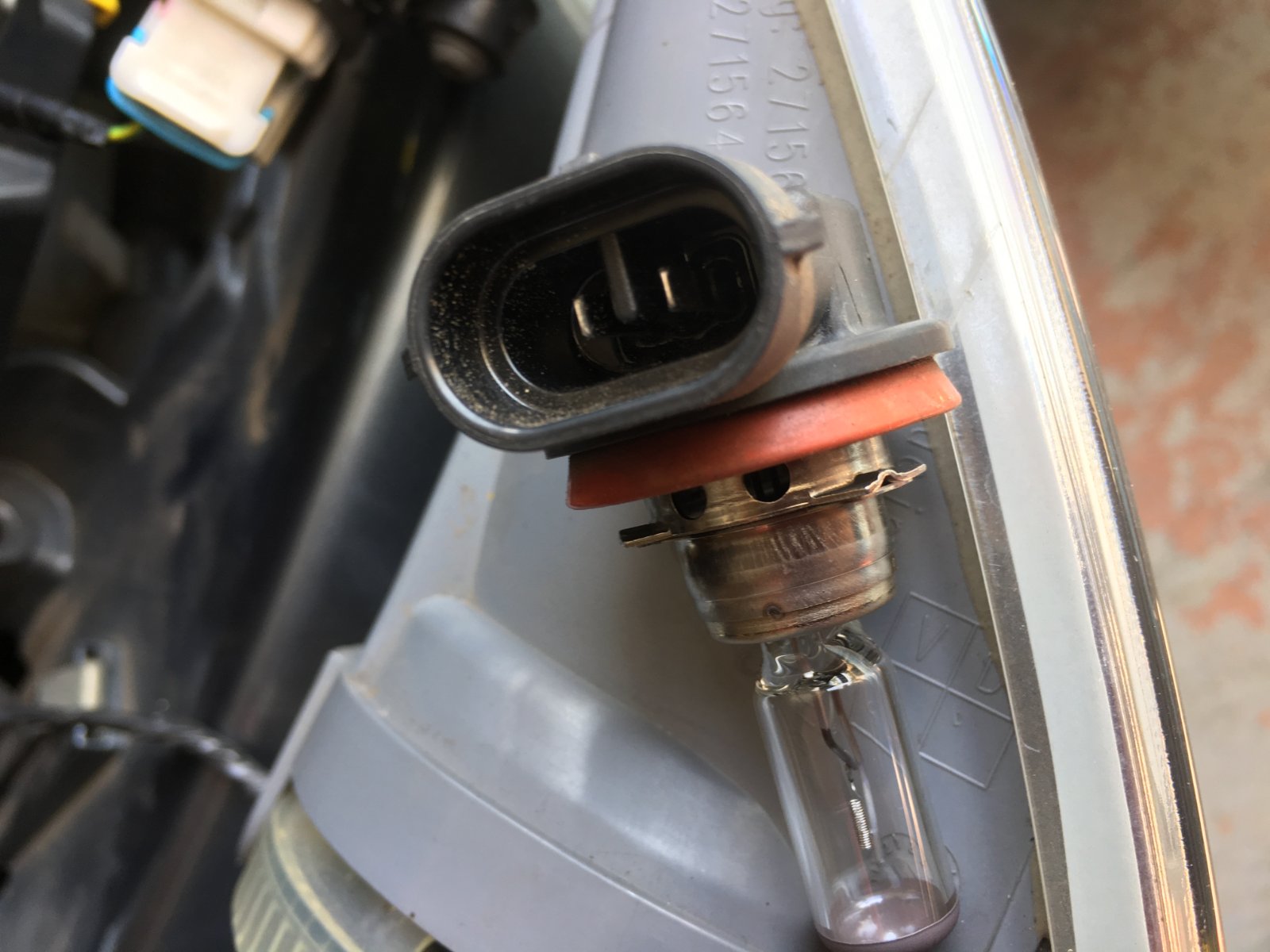

Successfully located/removed bulbs. I thought to add these in case anyone need this info.

Can the actual bulbs be removed from the harness itself ?
x 6950
Re: Citroen C5X7 HDI 2011 MY11 - Front Indicator light replacement procedure ?
The bulbs are sold with the bulb holders, as if you try and remove the bulb and manage not to snap any lugs, you will still have the long pins that can be wedged in tight - and risk snapping as you try and pull them out. There is no point anyway, as you can't get these bulbs sold like that - they come with the holder that just located back in with a turn.
Don't be tempted to try LED indicator bulbs - you will end up with electrical problems and rapid flashing.
