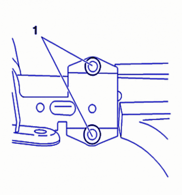

There is nothing I have on the tags of the ignition barrel, but this is what is involved in replacing the lock only: Note, that to get to this part below, the steering wheel, steering wheel controls, and steering column etc. also need to be removed. I haven't put those procedures up now as they are a bit involved unless you specifically need them - let me know.
Do you have breakdown / recovery cover to at least get it looked at or recovered home / to a garage?
Steering Lock Replacement only: (requires additional component removal beforehand).

Removal: Place the steering column in a vice with soft jaws. Punch an initial indentation on each bolt head. Drill and extract screws ( 1). Remove the ignition switch (mark the direction of fitting). | Refit:
Refit the steering column. Reconnect the battery. |
