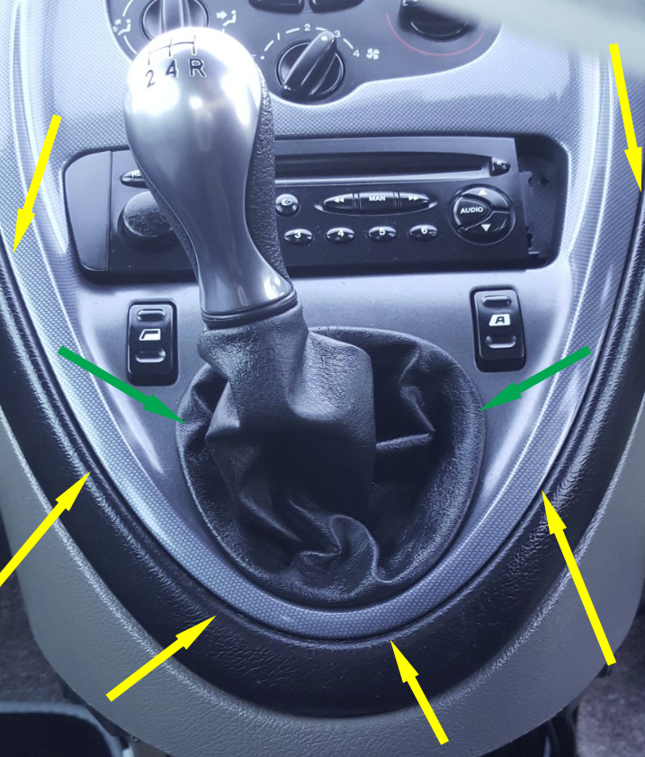

As I mentioned in a previous post in this thread, the whole plastic trim under the gear level and round the sides to the glove box is one part. However, if you want to get into the radio / heater cavity:
I assume you have already taken the radio out using the 2 screws under the flaps of the old radio.
Use a trim tool to carefully lift the gearbox lever plastic surround up that is connected to the gear lever leatherette cover (marked by green arrows below).
That may expose a couple of screws (if memory serves - but I'm not sure) that you may need to take out.
Then using trim removal tools, you can carefully prise up and lift the entire plastic surround (marked by yellow arrows below).
Carefully unclip and raise this - but you should be able to move it pver the gear lever and put it aside.
Then you will have access to the screw holding the heater control unit in place. Be aware if you have the non-digital unit that there will be control cables going to the temperature / adjustment dials, so be careful of these. But this may give you enough room to see underneath and look for your clip.

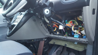

Thanks for that. I have already removed the panel, and the heater controls to try and locate it. The images show the cubby/ashtray removed and the sides of the centre console also removed. I need to get to the area around the heater matrix. That's my next step. How do I do it please?

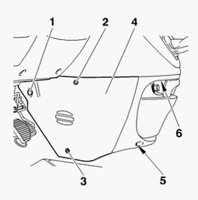

The side A/C panels are removed as follows:
Remove (on either side of the central console):
The screws (2), (3), (5) and (6)
The plastic peg (1) using the trim removal tools.
Unplug:
The cigar lighter
The ash tray lighting
Remove the air conditioning cover (4).
These are the only panels you can remove short of removing the dash....
