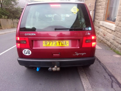

Re: Synergie brake lights **weird one**
Correct. I believe it to be a feature rather than a fault. The top bulb holders are 21w/5w, the bottom are 21w. As confirmed on Citroen service above.van ordinaire wrote: ↑16 Sep 2019, 00:13 There seems to be a bit missing the point here, everyone's gone into fault finding mode but, at the moment, we don't know if there's a fault because no one can say what the function of the lowest lamp is.
IF the Synergy has 4 tail lights, the lowest bulbholders should have 5w bulbs in them & if 21w bulbs had been fitted in error they (a) may have burnt out because they're not really meant to burn for extended periods & (b) that overload might not have blown the fuse (as one might've hoped it would) but caused all sorts of other problems. Absent a wiring diagram (& assuming the handbook doesn't help) the colour of the wiring MIGHT help - 'though being a Citroën, probably not
It is 2x tail lights, and 4 x brake lights, although only 2 are being used with the "feature's" preference being to the bottom ones.
In the absence of a wiring diahram, only a careful examination of the lampholder assembly will tell how these lights are supposed to function.
- what is the contact arrangement for the bottom bulb? Two base contacts or one?
- is there metal interconnection bwtween the top and the bottom bulbs, or do these get their live supplies from separate wiring arriving at the unit?
- with all the bulbs removed, what does a voltmeter/test-lamp show up as the various controls are operated: side lights, brake lights, rear fog lights on/off, towing socket plugged in/not ?
- there is usually a clump of electrical connectors for the rear light clusters, located behind one/both the non-tailgate light units. These need to be checked out.
- owner's handbook info?
Hang on Chris, it was you that identified the lower bulbholders as brake lights (so much for my thought that just because they were 19mm didn't necessarily mean they were 21w) but investigating how they are connected to the upper brakelights is well worth while.
Forget my surge theory, I'd manage to misdirect myself into thinking the bulbs at the bottom had blown again.
Yes, poor earths can produce strange symptons (anyone remember Mk3 Escorts - & witness 1/2 the trailers that actually have any lights) but as we're dealing with the same light on both sides behaving in unison, unless they have a common earth, which seems unlikely, that doesn't seem very probable. I'd definitely take the tow bar electrics out of the equation: any modification is a prime suspect.
All I was suggesting was getting stuck in there with test lamp and test meter, as well as checking the connection arrangement of the bulbholder unit itself - usually a fixed set of metal strips/pressings.
On the face of it, no more than an hour's work, surely.
Ok. I award myself 50 stupid points. After pulling everything apart and getting busy with a multi meter, I couldn't find and reason they weren't working. The bulbs looked fine, and weren't that old. But I replaced them anyway....... And erm....... It may have been the bulbs
To err is human - & we all tend to assume recent (even sound looking) bulbs are OK AND if neither bulb comes on, the fault must be elsewhere, so no need to hit yourself. My trick with that scenario would be to swap one bulb with the indicator & see if the fault goes with the bulb.
