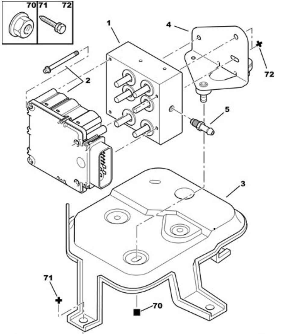

Put your VIN number (from the outside lower passenger windscreen - in the cut out) here - it begins VF3**************[VIN obfuscated, can be read by forum staff]. The ABS pump consists of an electronic control unit (ECU) and the hydraulic block. Depending on what is wrong you can either replace the whole unit or keep the ECU part and just replace the block. If your replace with another unit it will need coding to ensure the parameters are correct for your vehicle. If you retain the your existing ECU and just replace the block then it won't need coding.Shaz61 wrote: 16 Sep 2019, 16:14 Hi, I wondered if someone could help me please.
I own a 2007 Peugeot 207cc with a faulty ABS pump. I have been trying to find a used one but have been told I haven’t got the correct serial no. The one I have been providing starts ‘1009’ but have been told that I need the one starting with ‘96’. My mechanic rechecked the pump but could not find any other serial no’s so I contacted Peugeot & the only part number they could provide for the pump was 4541Z3. I have searched using this part number & have found matches but I’m not sure just cos the part number is the same that the pump will work in my car.
Any assistance/ guidance would be very much appreciated. Shaz
One I have your VIN I can check the correct PSA part number.

So the parts are no longer available new from Peugeot - but there are 2:
Item 1 in the diagram:
4541 Z3 or
4541 Z4
The difference being one is pre-configured to the vehicle and the other is configured afterwards - but I've supplied both.
4541 Z3 or
4541 Z4
